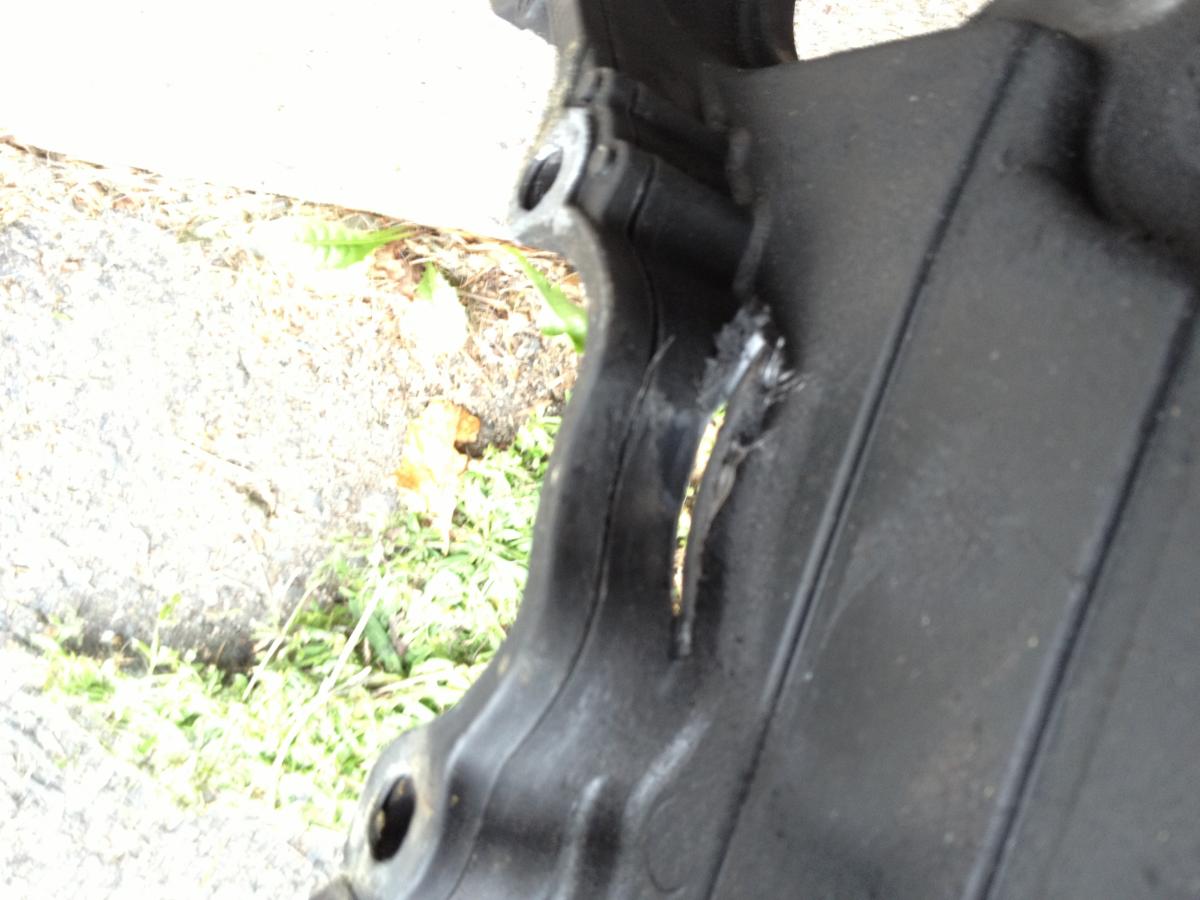

  10. So, I did my timing belts recently (although the old ones ended up looking just fine, so I'm a little bitter), drove 2 1/2 hours without issue. Then, yesterday, I start up the car to go home from work, and it starts making this knocking sound. Crossed my fingers, drove half an hour home. Stalled once and seemed a little underpowered at first, but then evened out. Besides the sound, it drove fine. Sounds like it's coming from the timing belts, so I ripped everything out again to find the driver's side belt looser than Charlie Sheen's morals. I'm surprised it ran at all. So, my first thought, the tensioner bolts must have come loose. Still felt tight, but I loosened 'em up again, and fiddled around with it trying to tighten up the belt again. Tensioner didn't feel like it moved at all, but something I did made the belt taught again. Started it up, noise is gone. Now, what scares me is I have no idea why it came loose in the first place. The torque on those bolts isn't that much. I also found a good slice in the timing belt cover right above that tensioner (attached picture). I think I'm going to run without the covers for now and see how it holds up. What do you guys think?
