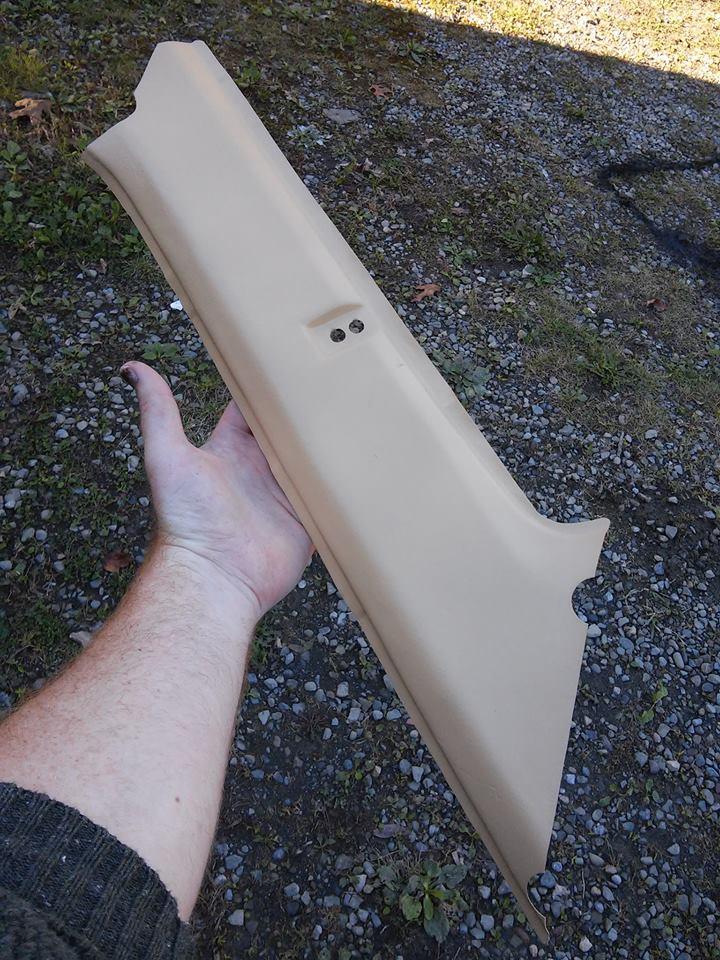

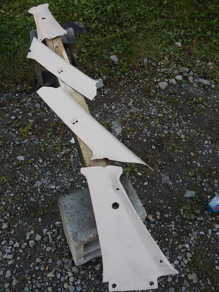

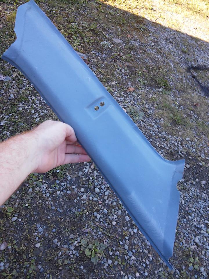

  9. Early November I started the dreaded task of more interior restore. I had a pile of miss matched panels that were nearly ruined. The results as you can see were night and day.

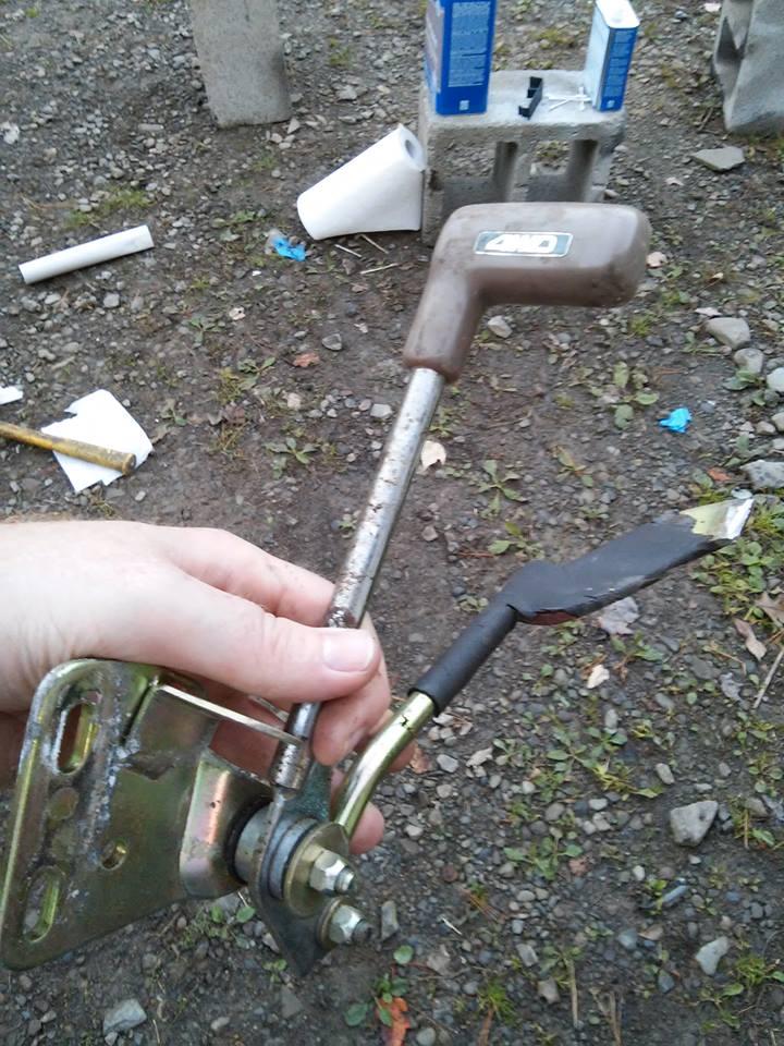

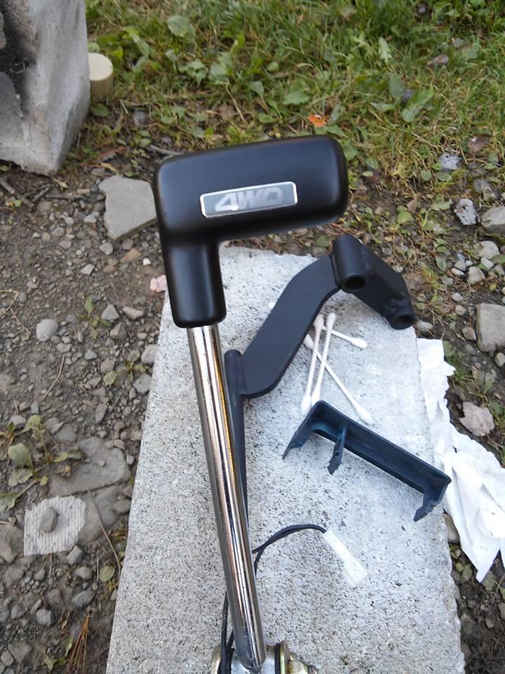

  10. In late October I rerouted the e-brake cables to compensate for the 4" lift, I also had to modify the 4x4 linkage. I end up combining two of them together with an extension the length of the lift. Surprisingly it end up working out just fine. I painted the handle with a vinyl dye, and used undercoating on the linkage itself. I would like to shorten the throw on the main shift level itself at some point as it feels sloppy, but it works fine for now.

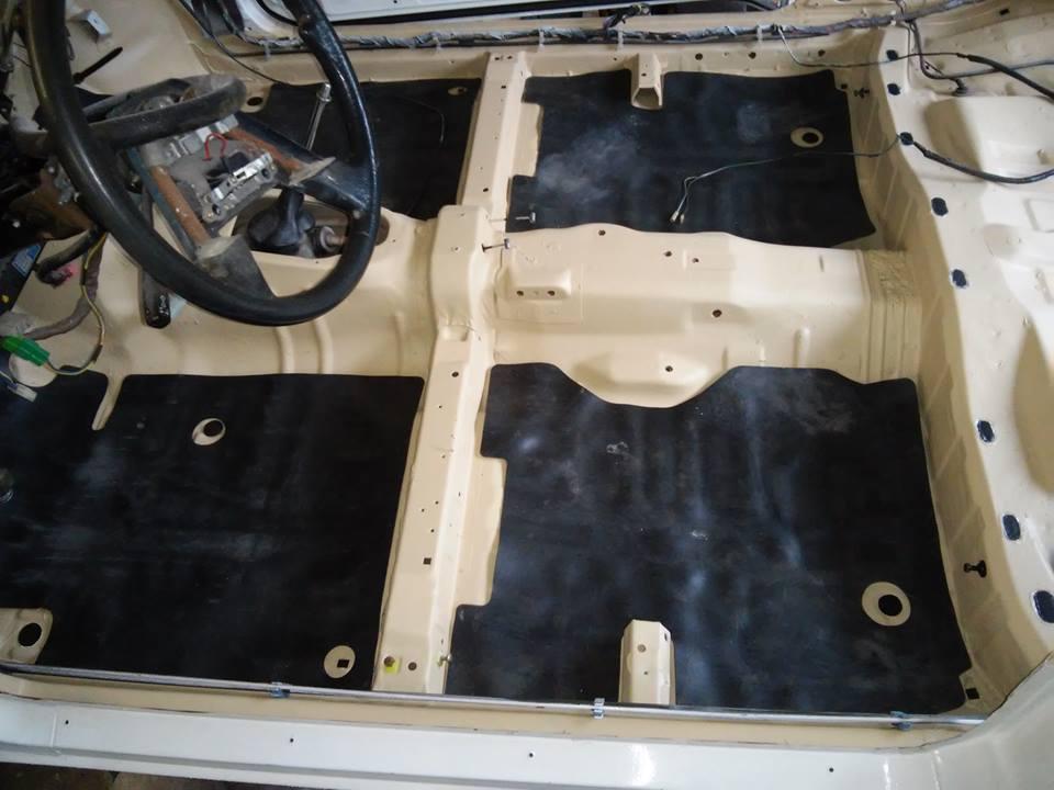

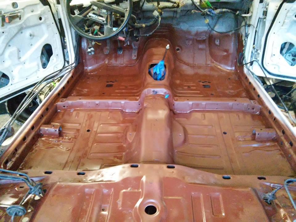

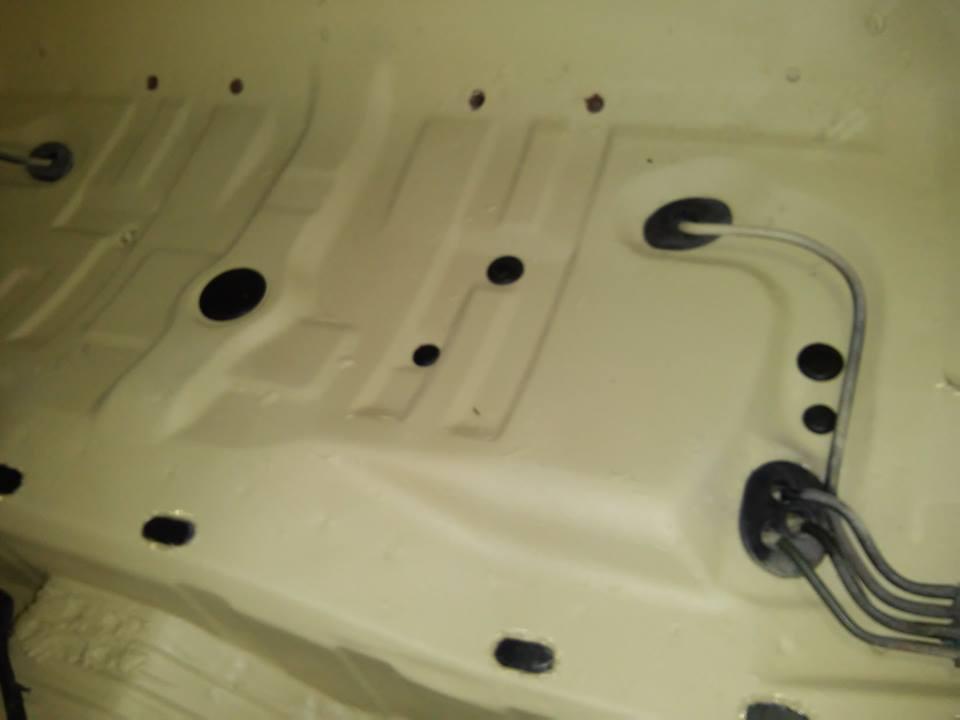

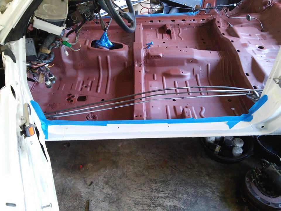

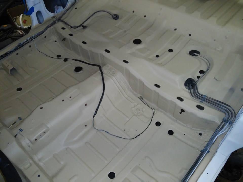

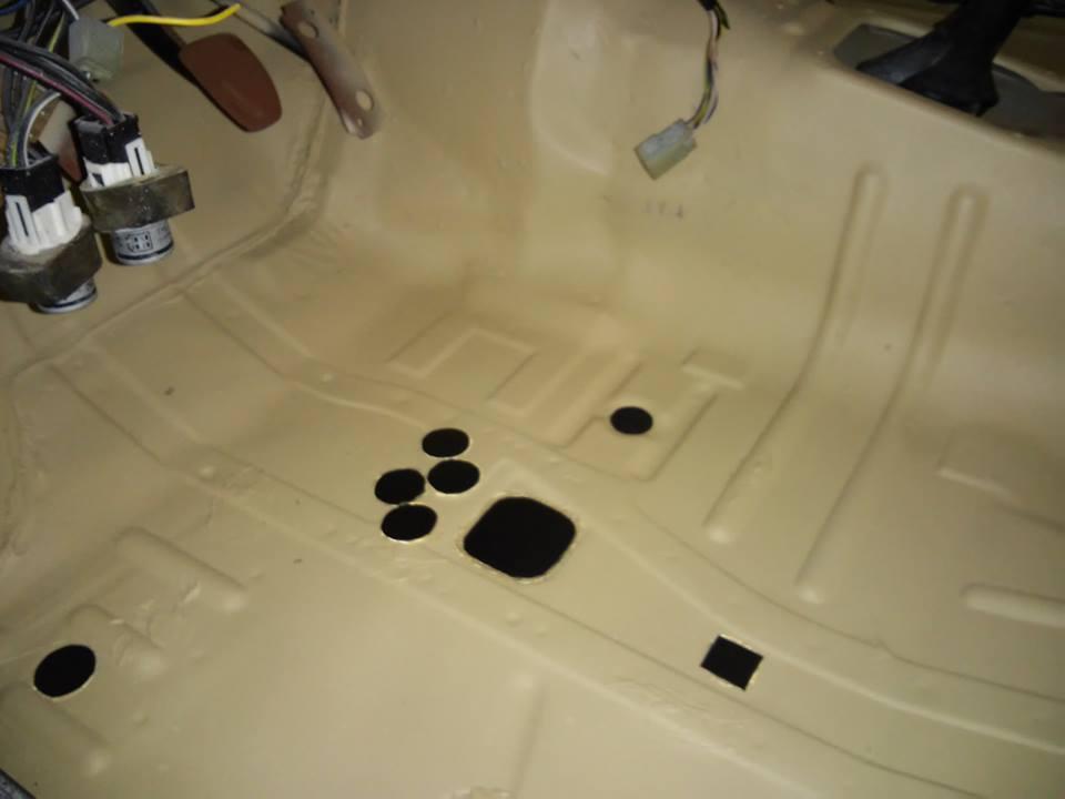

  11. Back in early October I completely resealed, rust treated, primed, and re-coated the floors. Trying to stop that evil rust from the inside as best as I can. I chipped up the dried out stock sound deadening tar because I believe it was trapping moisture/salt underneath and progressing rust. I used a rubberized bed liner instead. A nice thick coat, to make up for it. I did not have all the factory plugs so I ended up cutting up an old oil bottle (black plastic) and using a marine silicone rtv adhesive. The factory rubber padding was not bad, so I power washed it and reinstalled it.

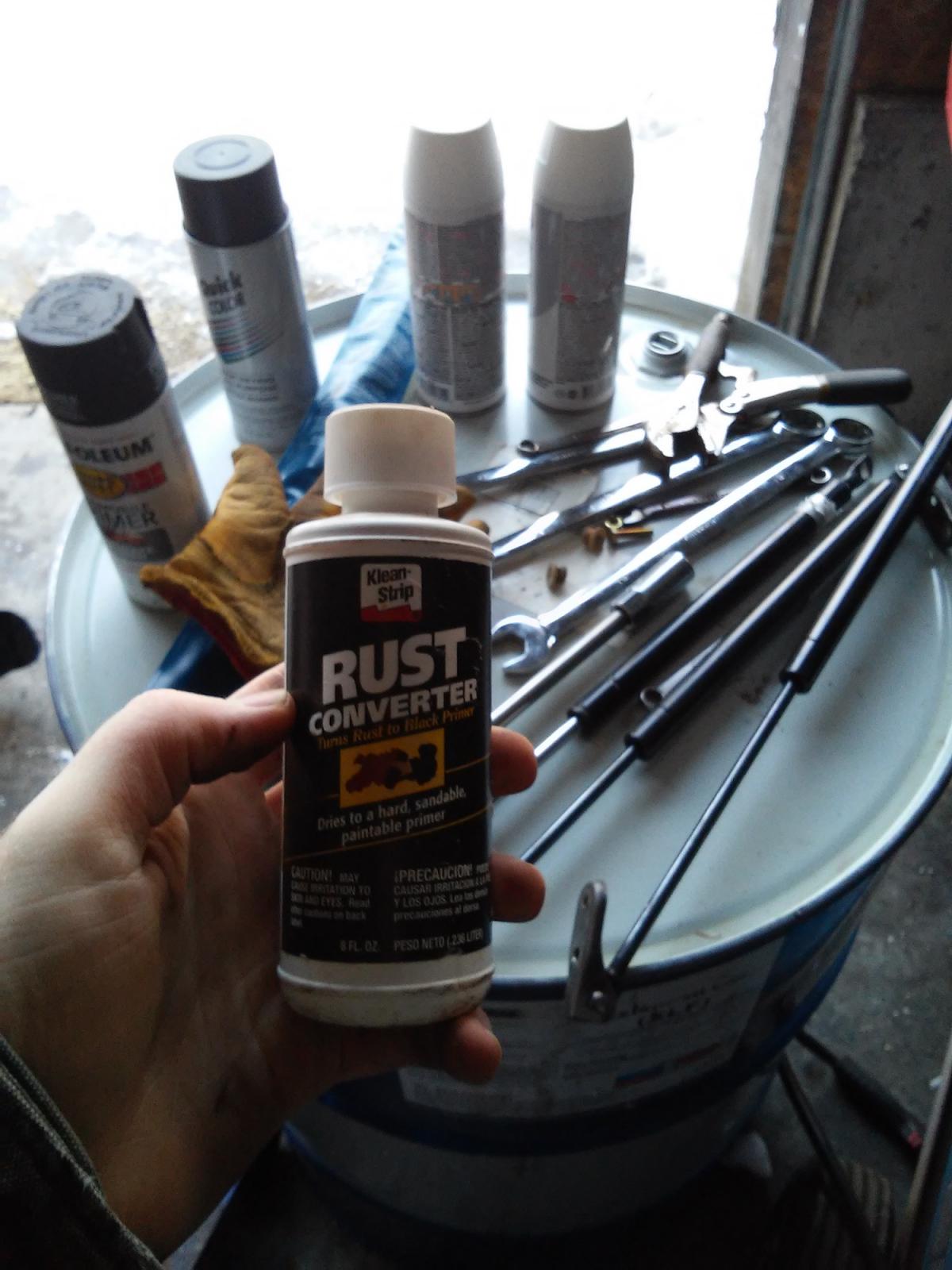

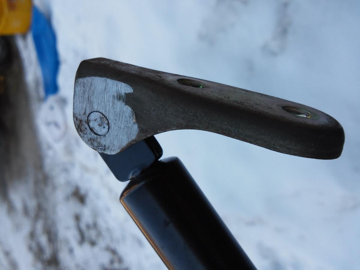

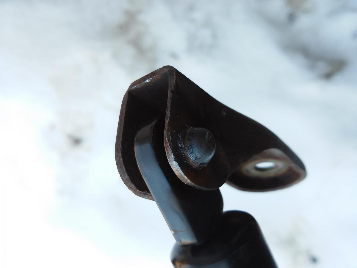

  23. I was unable to find the repair kit with c clips. So ended up grinding off the ends of the old rivets. I was planning to use bolts/nuts but the mounting holes were the same size as the orginal pin so I ended up just reusing them without the broken nylon. After I wirebrushed and hammered them back together, I hit them with a spot of weld. If I need to replace them later I will just repeat the process. Dipped them in some rust converter, planning on painting them tonight.
