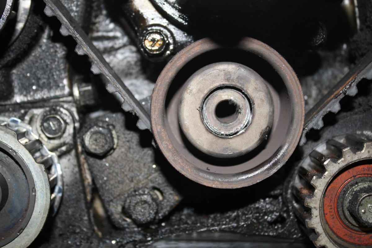

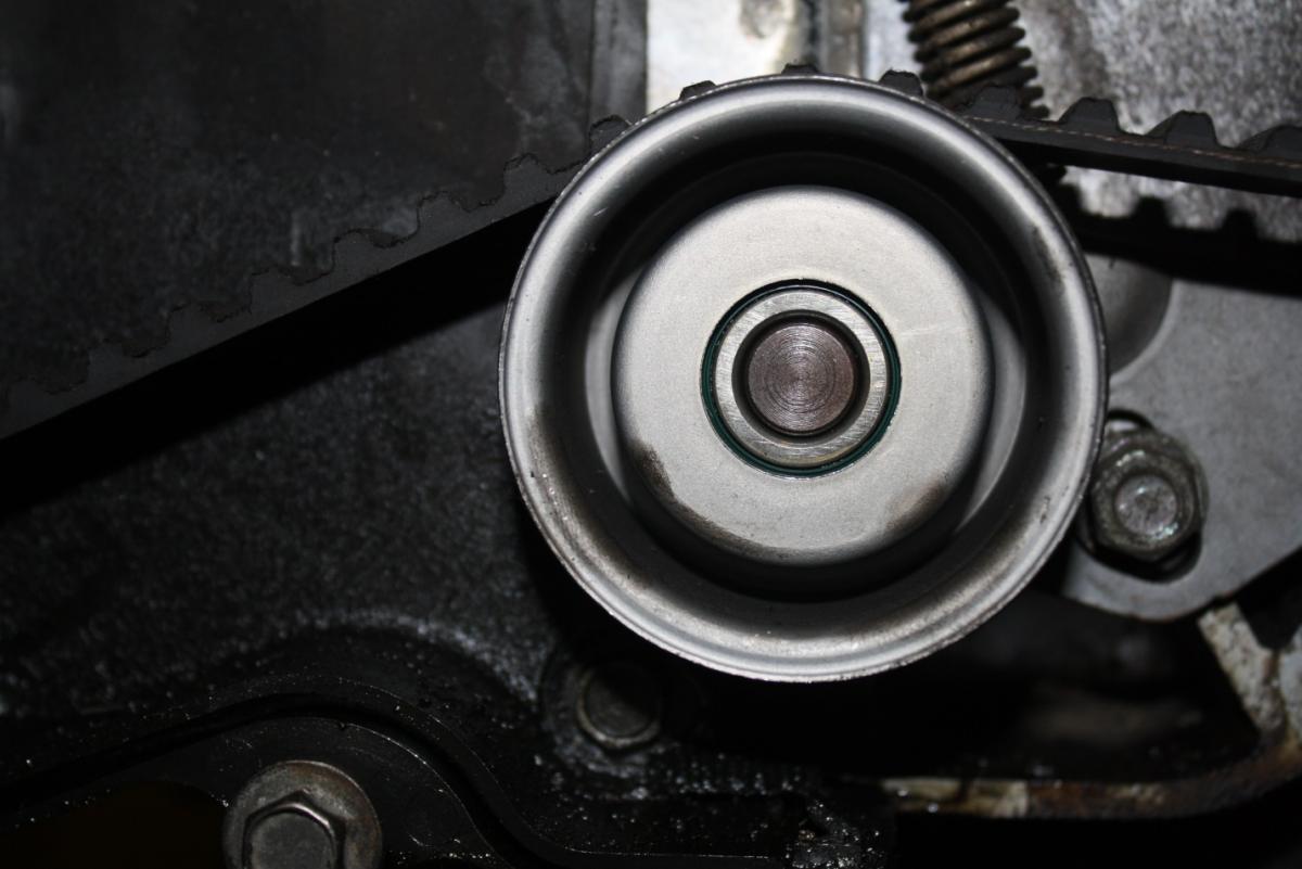

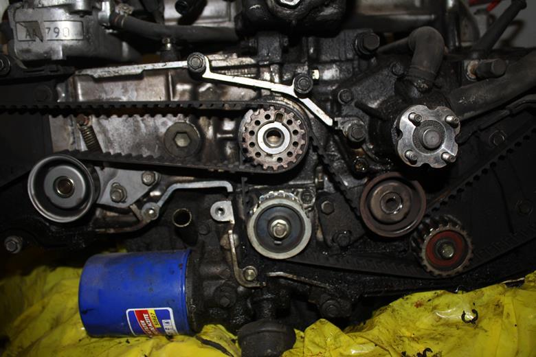

  14. Hey everyone I am relatively new to the forum, glad this is here you are all awesome resources for a new DIYer. I pulled the motor from my 92 loyale after it was making a weird clicking/grinding sound (now realizing I probably didn't need to pull it but whatever), after taking the timing covers off, I see that drivers side tensioner pulley is destroyed while the passenger side looks great. I don't know the detailed history of the car, but the timing belts aren't cracked or frayed which suggests to me they are not that old. The drivers side belt is noticeably worn probably because of the bad tensioner pulley. So I plan on doing the timing belts and replacing the tensioner pulleys on both sides just for good measure but my question is this. Assuming the timing belts were done in the not so distant past, is there an underlying cause for this pulley failing prematurely that I should address before repairing it? Or could it just be a cheap part that failed because its cheap? Secondly, I have found little shards of metal which scrapped out of the pulley and were sitting at the bottom of the timing covers. Is there anything else that could have been damaged because of this that I should take care to inspect closely before everything gets put back together? Picture of timing belts, with the one on the right in visibly bad condition relative to the one on the right Close up of the good one... Close up of the bad one... And the weird little metal shards...yikes! Thanks in advance!
