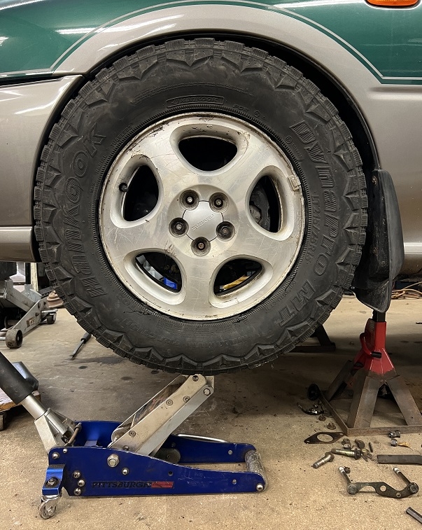

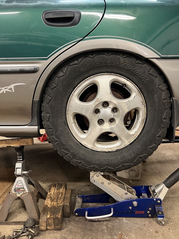

The answer is a minimum of 3.5" subframe spacers for 235/75R15, so I'll be making 4" spacers to be safe. Also, I forgot to post this video from spring of this year:
