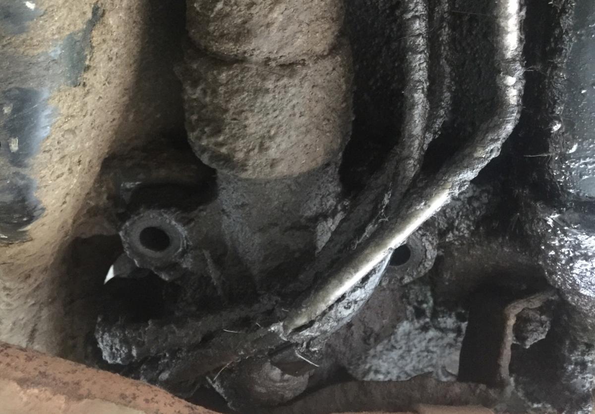

Here’s the two bolts that fell out. Seems kinda funny both on one side but what ever. Hopefully easy fix. Wish me luck

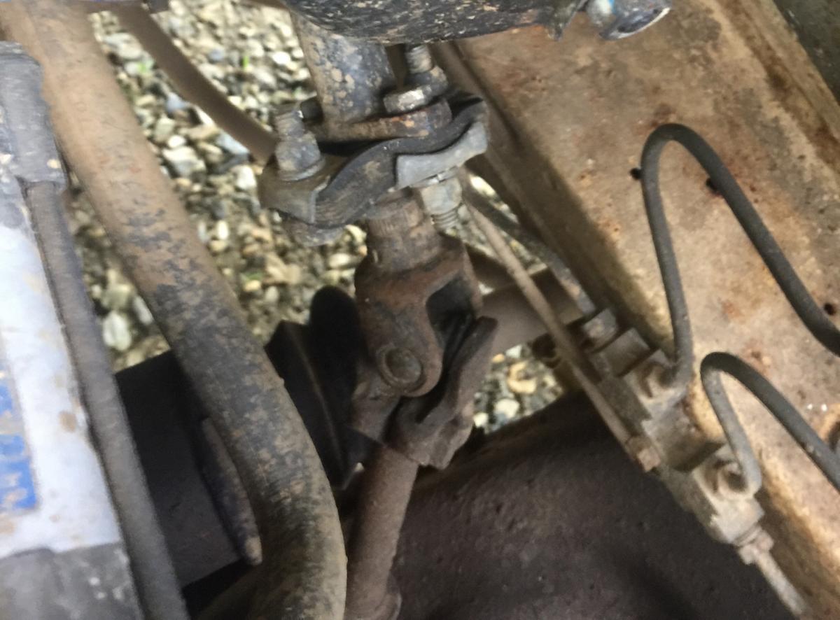

Is this a rag joint? This was a one owner 1984 Subaru gl and all I’ve done to it was change it from a automatic to four speed dial range.
So I seen this the other day but had no one to turn the wheel for me. So I called my daughter over to help me and here’s the problem. 2 missing bolts on one side allowing the whole thing to slide back and forth and even pulling the casing out. Seems like a easy fix. Wish me luck
There is a rag joint but that’s not the problem. I’ll look it over again after the rain. I don’t think it’s anything visible.
