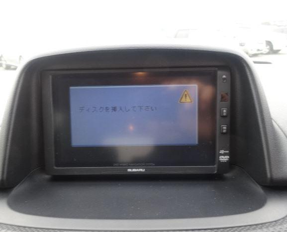

  17. Hi guys I have just got my forester and it comes with a navigation and DVD player in the centre console at the top and I was wondering where I could get information on this unit or even get some advice on what others have done with them as they come with Chinese I think as the language. I have attached the picture.
