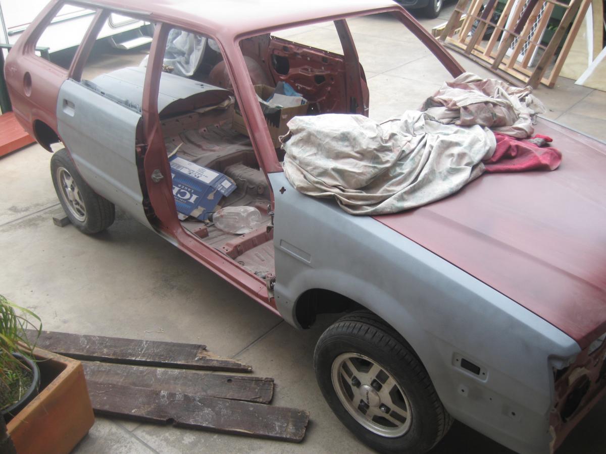

  3. before and after

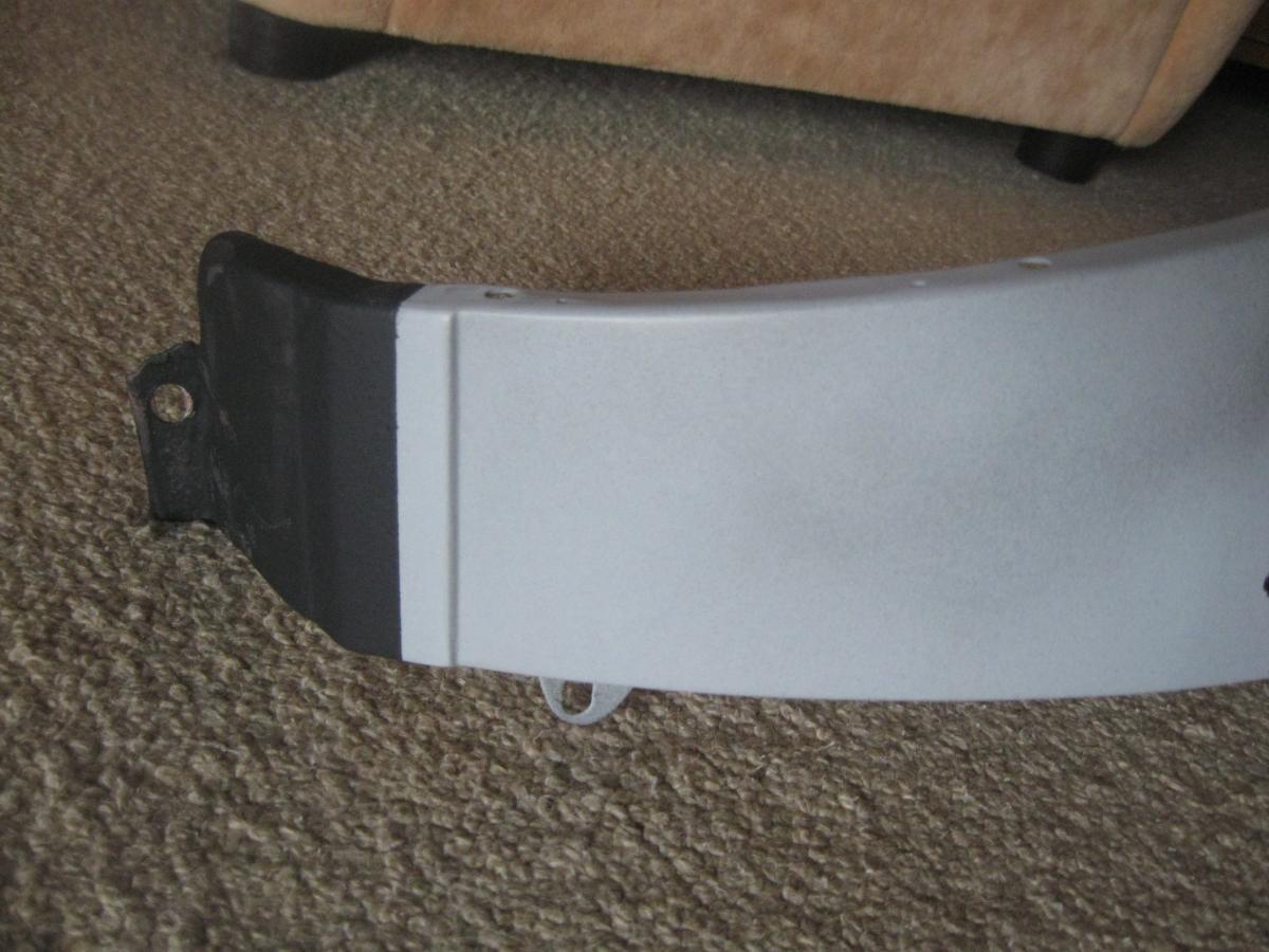

  4. colour different in photos,from the lighting,you sure wonder sometimes why i did start it,its a lot of work.heres some pics.

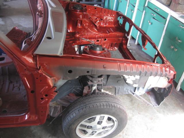

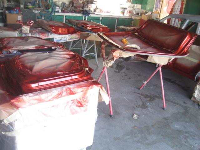

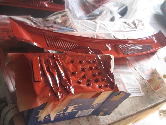

  5. id tag and front guard bits. front cowl.

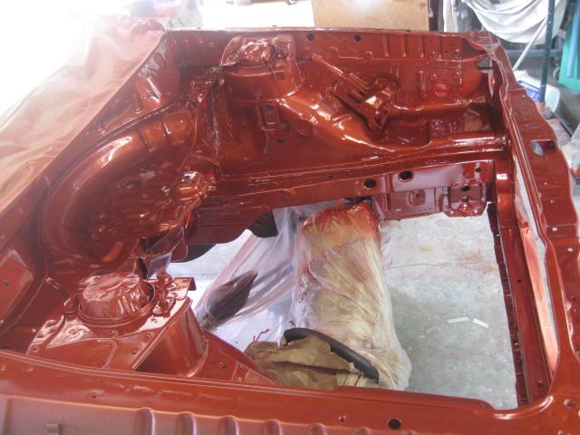

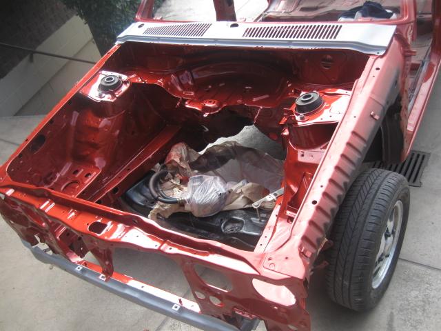

  6. inside paint on front guards.

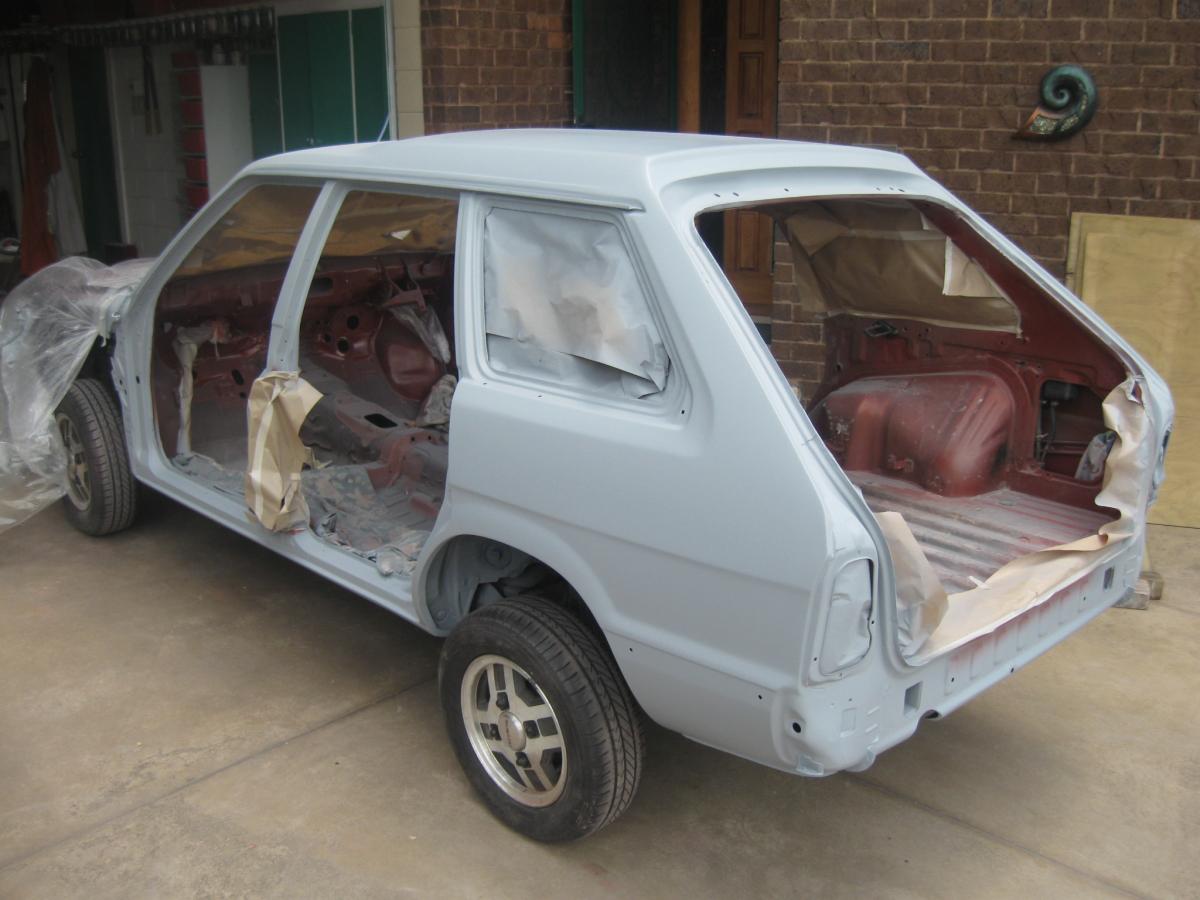

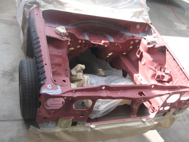

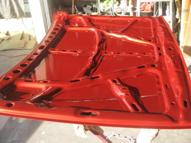

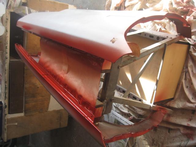

  7. more progress,the prep goes on,inside paint work from firewall to front of car. bonnet

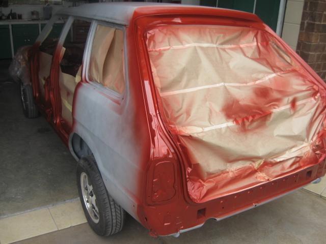

  8. basecoat and clearcoat on,done at home the painting, engine and front guards next.Trying to get a day that's not winding or wind blowing in to garage, I did wet the floor before spraying,careful not flick water off air hose onto job.Once inside work painted, bolt on panels,and sand outside , and paint outside.

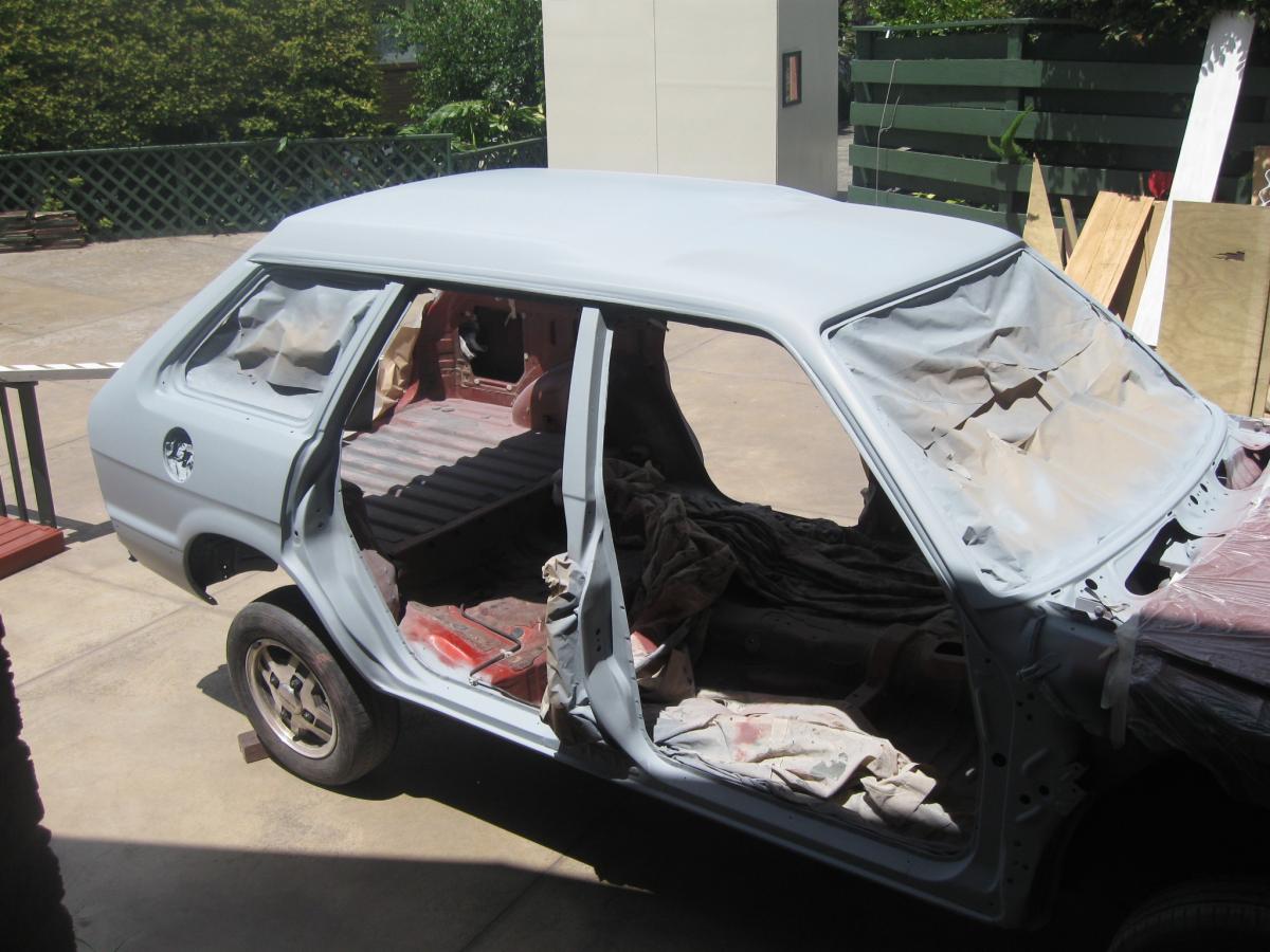

  9. sanding primer on inside areas, fine scotch pad or p500 sanding pads fro from DA sander.forgot to take pictures of sanded areas, so no before shot.

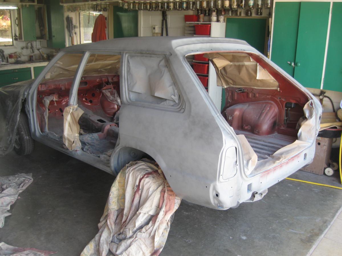

  11. guide coat black
  12. hopefully enough primer on for wetsanding ,or spot prime?
  13. 3 wet coats of primer ,4 on outside parts

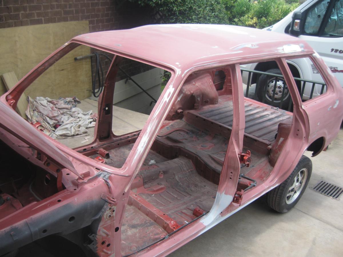

  14. more sanding
  15. block sanding p240

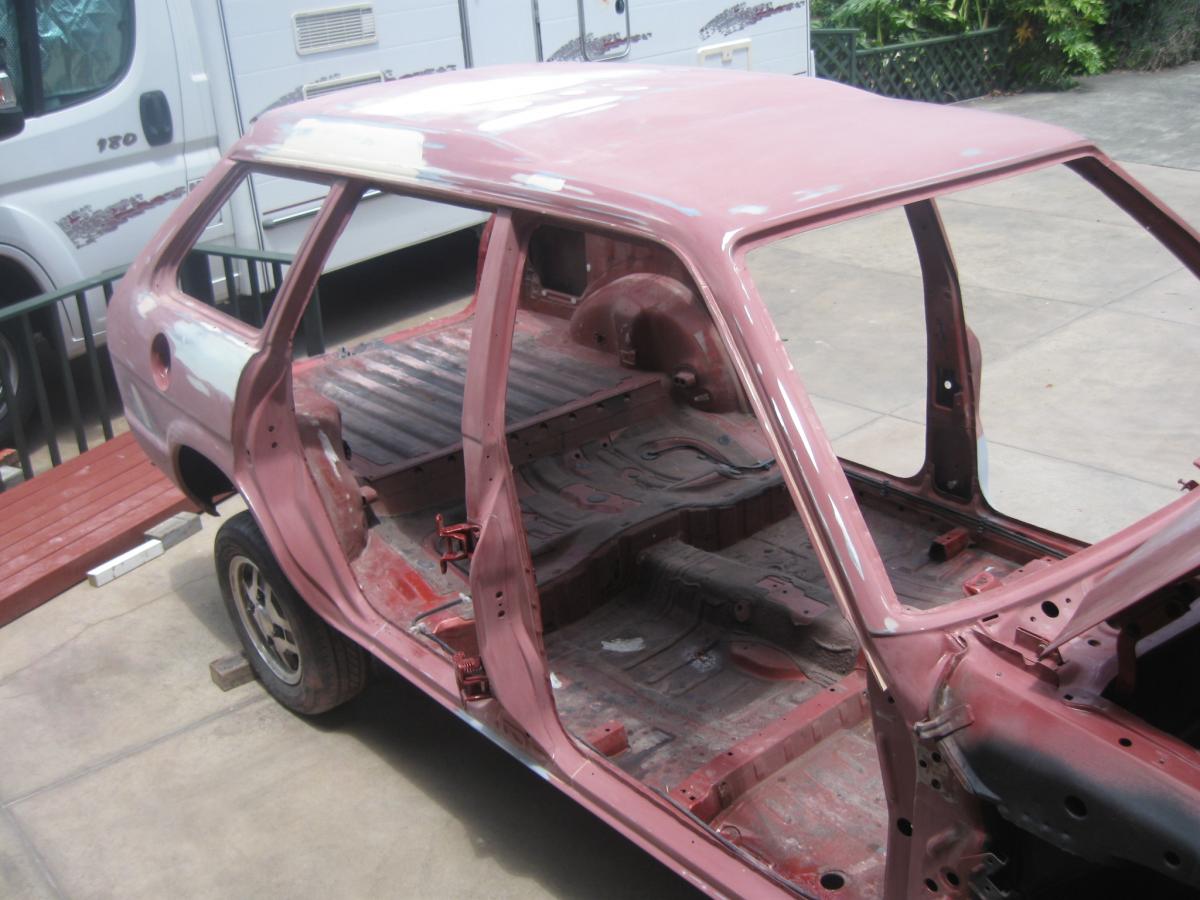

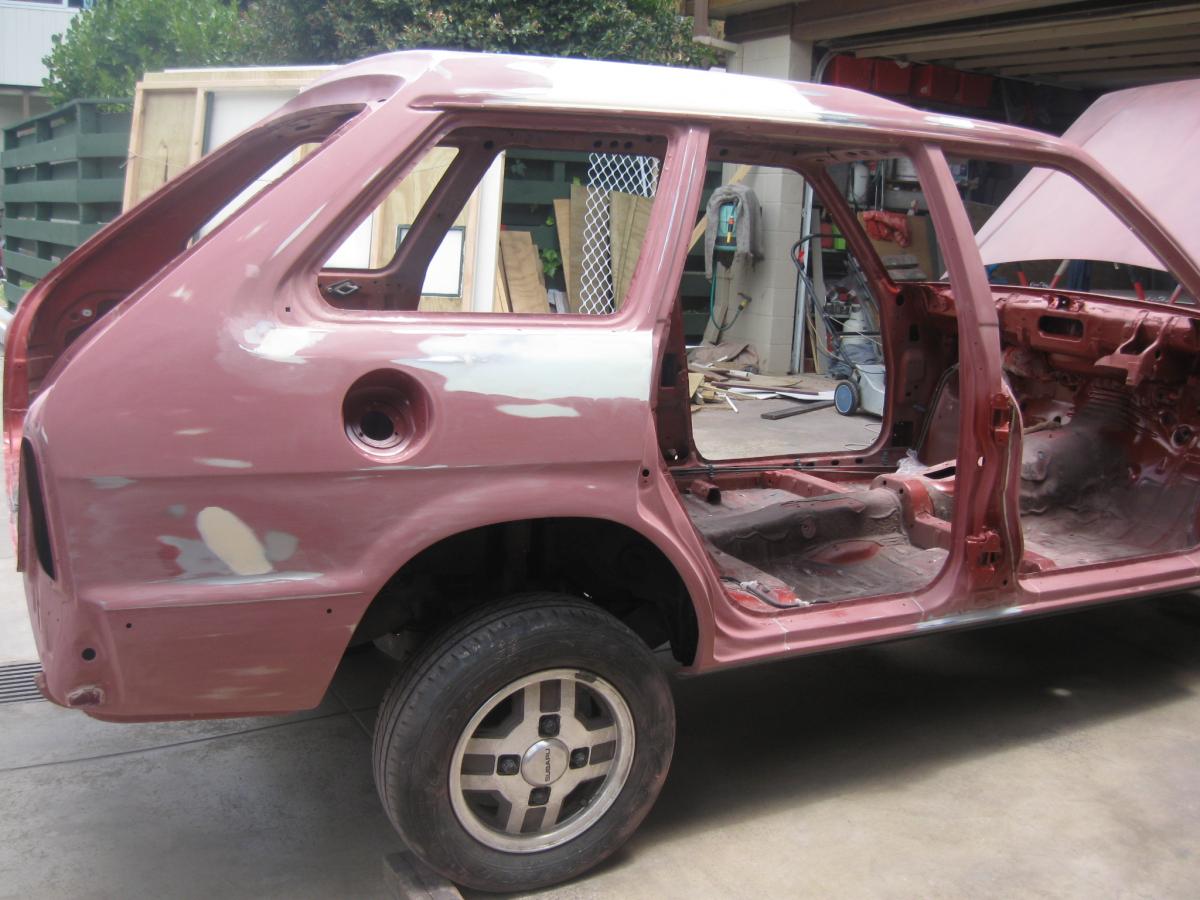

  16. repaired rear 1/4 panel 8months ago,now the small area fixed, rear quarter accident damage, filler work poorly done shape wise,ground filler out and redo,filler covers just about the whole 1/4 panel,not much else you can do with it.
  17. redo filler work
