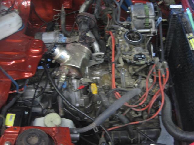

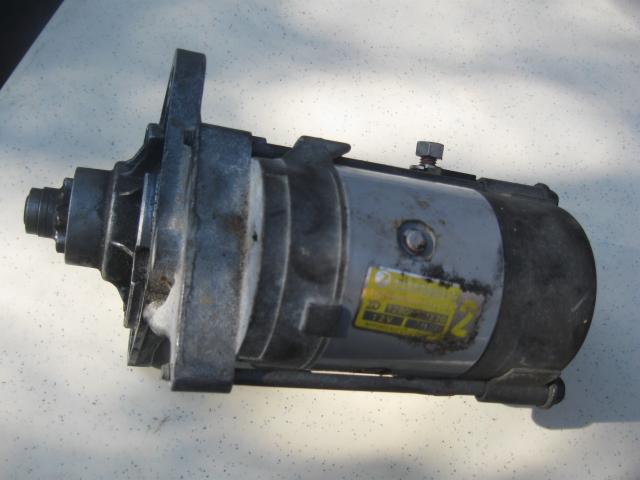

EA71 engine mated to 1984 4wd auto transmission,its not the right engine,as it should have EA81.Only want to sell engine as a runner,as it is no use to me.Obstacles are? exhaust headers pull together as Ea71 narrower distributor electronic, no points Ea71 fly wheel on and clutch cover,left out clutch plate auto choke and wires fuel return on carb start motor measuring the throw looks like it not quite reaching. there maybe housing differences? clutching at straws now,as don't really want to damage starter and ring gear.Just to many differences between engines,any thoughts or anybody tried this?
