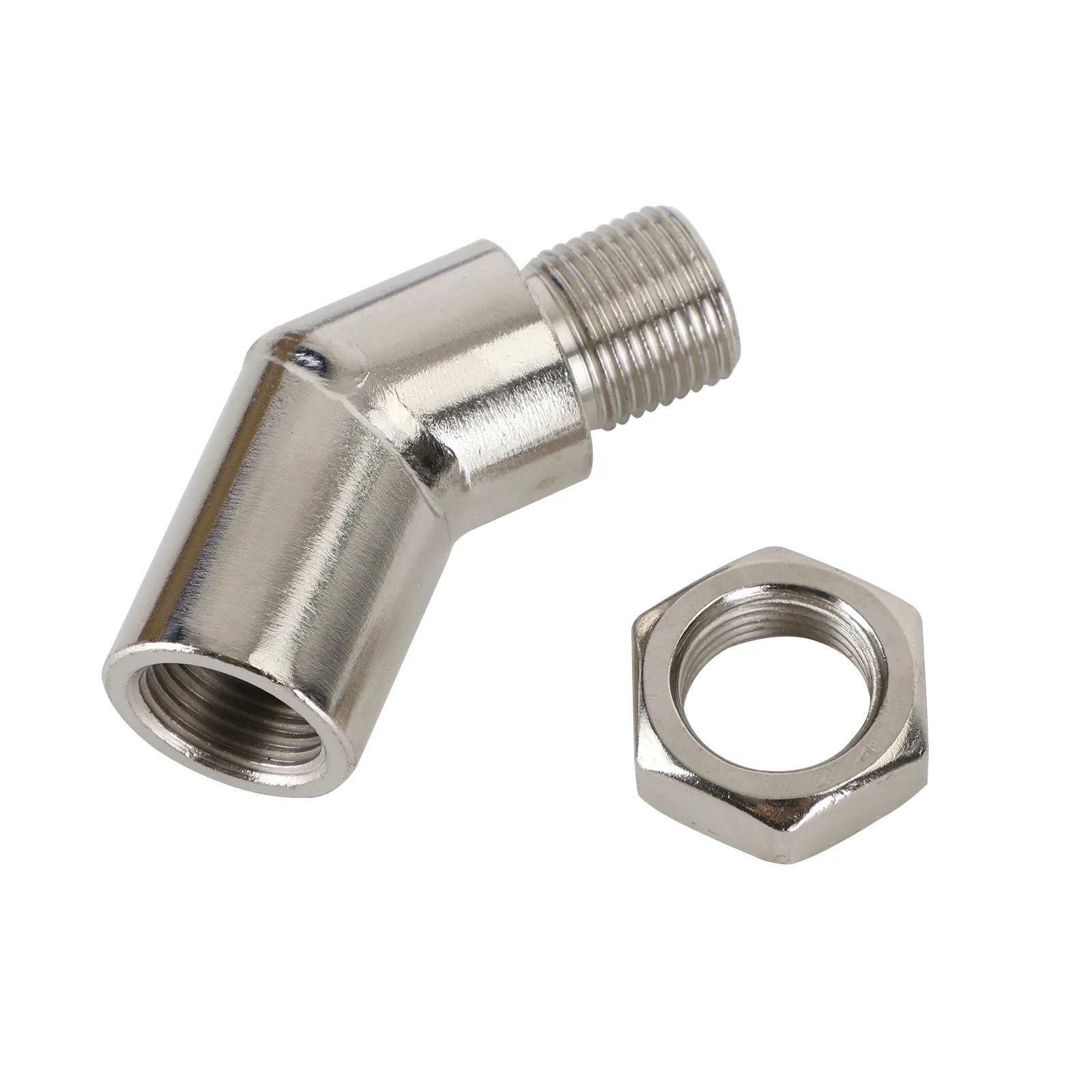

no power below 2500 rpm
well for an update ive been driving it with the sensor on the intake manifold the car has been driving great. still not hearing any knocking by ear. seeing as no one has any input im guessing it must be fine to leave it like this.
im prety sure its related to the knock sensor i have questions though. as the title says it has no power until around 2500 rpm then like a light switch bam it takes off full power. if i unplug the knock sensor it has normal power at all rpm. i did some experimenting and moved the knock sensor onto the intake manifold and with the sensor mounted on the intake it does not pull power away and i can drive the car normally. i do not hear any knocking occurring with the sensor here. would it be safe to run the car with the sensor mounted to the intake? im 95% sure the sensor is reporting piston slap as the engine does do that. i do not hear any real knocking though beyond the piston slap. it is a 2001 outback with the 2.5 i have a small collection of used oem knock sensors and aftermarket ones they all work normally on a 2001 forester i have and have same issue when installed on the 2001 outback.

Anti fouler drilling
sirtokesalot replied to Mugs's topic in 1990 to Present Legacy, Impreza, Outback, Forester, Baja, WRX&WrxSTI, SVX

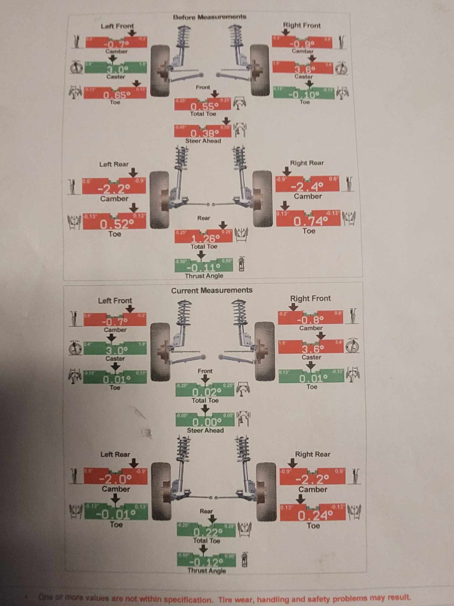

2001 outback cant get rear tow right
its a 2001 outback. it was a firestone. i know the rear only has a tow adjustment. do they make an aftermarket cam bolt that can add more adjustment? as far as i can tell its never been in an accident. and aside from buying adjustable camber arms is there a cam bolt i can get for those? i know the front camber is adjustable my buddy said they wont touch it unless u ask specifically. i did buy a lifetime alignment so i can get it redone free anytime. as far as front caster i saw a video the other night where someone loosened the subframe and shifted it to get the caster to even out left to right. im gonna guess this is my only option to try and even out caster unless i got expensive adjuster plates? all in all the car does drive amazingly i kinda just want to see it all green on the chart
i just finished replacing every control arm and bushing on the suspention front and rear and got an alignment. i dont think they did the front camber adjustment why would caster be out of spec 3.0 on drivers side witch is in spec and 3.6 on passenger out of spec. and the rear passenger tow adjustment was maxed out and could only get to 0.24 drivers side rear is 0.01 rear camber is also out at 2.0 and 2.2.
