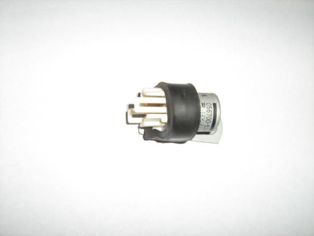

  5. I'm checking various modules under the dash of my '86 GL and came across this one. What is this? It has no part number stamping or any identifying features.
