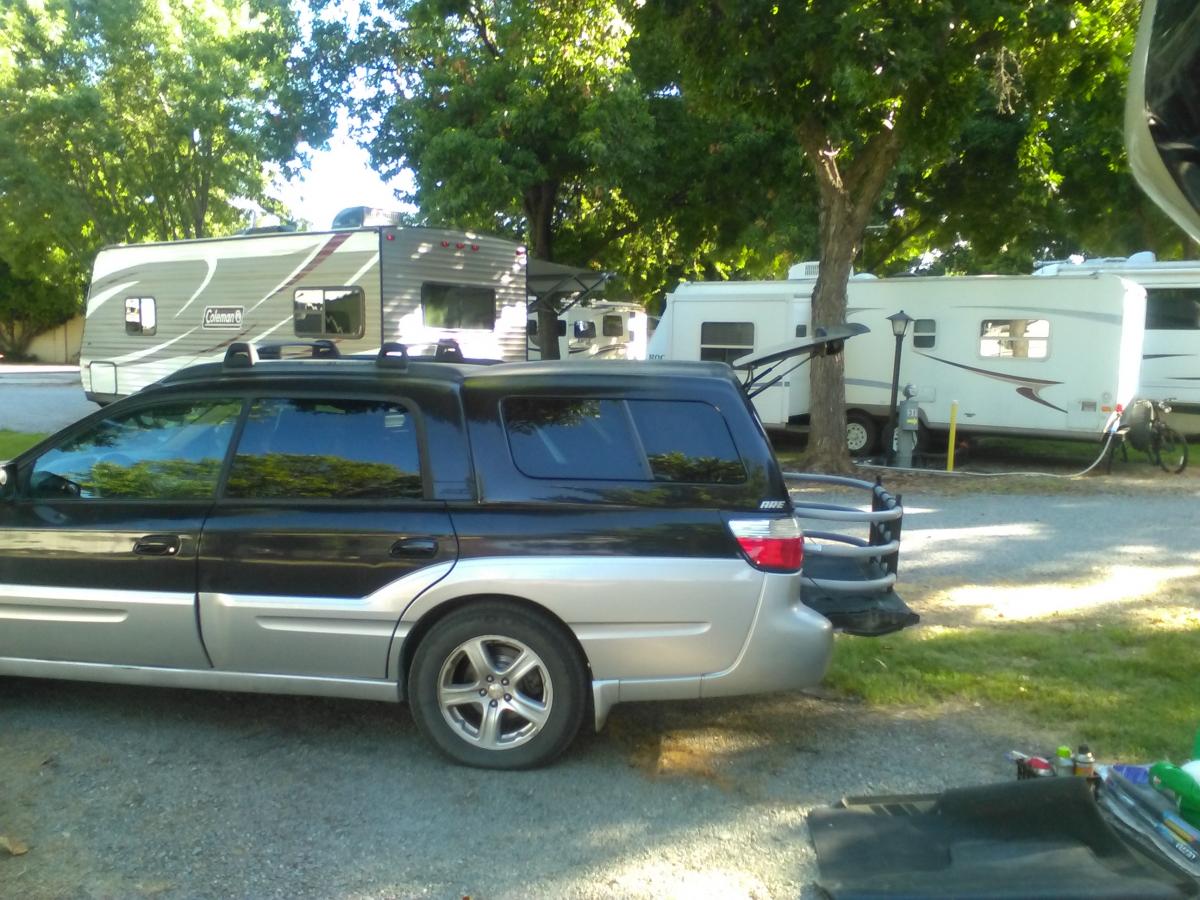

Hello Subaru brethren! I am selling my 2003 baja! ej2.5I with new head gaskets, cat, and o2 sensors. new rotors and pads. It also has a professionally installed cap. 130k on the body. I live in northern California. I'm wondering if anyone is interested in buying, but more importantly what should I ask for this car on craigslist? The reason I am getting rid of it is due to the fact that AWD isn't really as useful as it was back east, the car is HEAVY, and the mileage is poor. The car is a trooper. It survived the 3000 mile trek from PA to CA. New A/C compressor (not reman). The previous owner had a dog that liked to chew. The arm rests are a slight bit mangled but other than that the car is nice. The aftermarket head unit is cd/usb/aux capable. I would appreciate your feedback on a reasonable price to ask for. Thanks in advance, Zosojojo.
