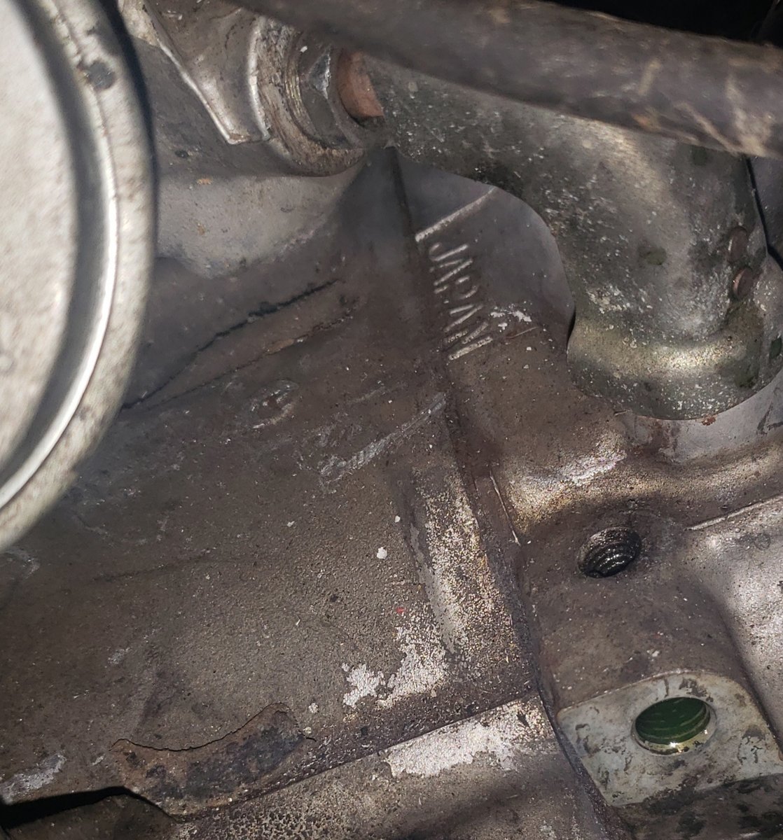

  5. Ok this was my first time pulling the heads so I dont know what exactly stripped the threads. I put oil on the bolt threads and tightened them in 3 steps. I have been chasing leaks. Started with thermo gasket then throttle body then it started shooting out of the holes. I am going to take this head in to get it checked for warping and for cracks
  6. This is the hole the coolant shot out of that I put a bolt into
  7. When I was taking the head bolts off they all looked fine. It was the one on the top front of the engine. When I went to put the head back on, one of the bolts started to tighten and need more force to move it. It all of the sudden got super easy. I pulled it off and the bolt now had the threads from the head on it. I used a helicoil to fix it.
