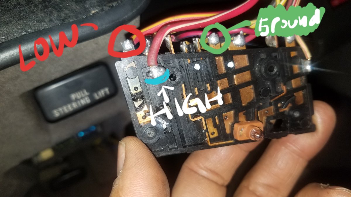

  5. This is the headlight switch section that was faulty, I soldered a piece of wire to actually allow connectivity between the two needed points for the actual operation of the High/Low beam. The orange arrows point at the exact section where the conductivity was lost hindering the operation of the High /Low beam. @idosubaru The second plan of action was just that, to attach a pair of soldered wires and place a push button somewhere to actuate those lights. In fact, a few years ago I placed an entire custom wiring with a fuse and a relay to operate the high/low beams with a switch totally separate since I couldn't fix the combination switch then. This repair was a home run! As now all the original wirings are in place and the switch works to a 90%
  6. **UPDATE** I've fixed the control wing's headlight combination switch by bridging a faulty connection with a tinned copper wire and removing the push button function of the High Beam, leaving a pull and push action instead. ECU: The new ECU arrived and after hooking it up the car wouldn't start. I traced a problem on 2 injectors. After removing the harness for injectors 1 and 2, the car started although roughly as running on 2 cylinders. I got 2 injectors and fixed the issue only to find now injector #3 flooding and not working! As I disconnected #3 & #4, the car started immediately but again on 2 cylinders! This Soobie is a treat! I'll get another injector tomorrow and hopefully it'll fire up once and for all!

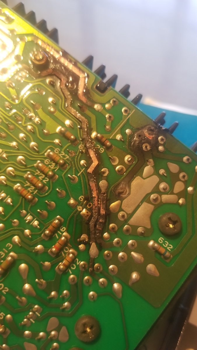

  12. I agree with you @1 Lucky Texan, first call of action was to try and repair it. But it doesn't look good. The only question now is whether I have to modify a pin in the upcoming ECU to "cancel" the Turbo signal /pulse? I'm guessing the ECU doesn't "read" the turbo or does it?

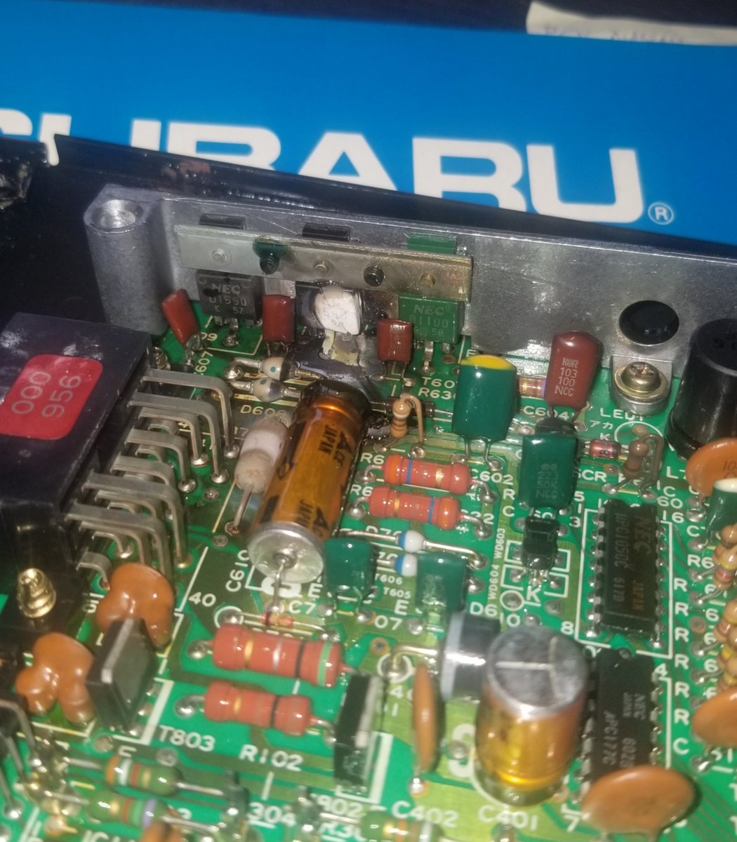

  13. Thanks @idosubaru! What I have done is sourced the exact same ECU which is on its way, probably a week to get to me. In the mean time I'm working on peripheral jobs like brakes, upholstery, radiator fans, shock absorbers etc. This car is now a non turbo regular EA82 with a MPFI system. I guess I'll have fingers crossed when plugging in the new ECU. As I wonder if the ECU will be "wondering" where the Turbo is. The actual picture does not show much of the damage, as I thought of a repair by myself.. But on the other side of the circuit board it looked pretty bad, you can see the pictures.. I'll update soon!
  14. Hi guys, I've recently discovered my XT's ECU was fried inside, I took it apart and saw the burnt electronics. For a long time, it had a lot of sputtering and hesitation. My suspicion is that it developed a short circuit. When trying to start it, it would blow the fusible link, I traced all I could until hesitantly checked the ECU, it looked bad inside with signs that a massive short circuit took place. But I can't avoid wonder if something else could have had a short which burnt the ECU.. Top left corner is all burnt. (On the image) Question, do I need to replace the ECU with the exact same type as it originally came with? Are there any issues regarding whether it is Automatic or manual transmission, turbo or non turbo?. I have a real unicorn here, it's a 1986 XT 3AT converted to a non turbo with non turbo pistons... Any thoughts, as always very much appreciated! davepak
