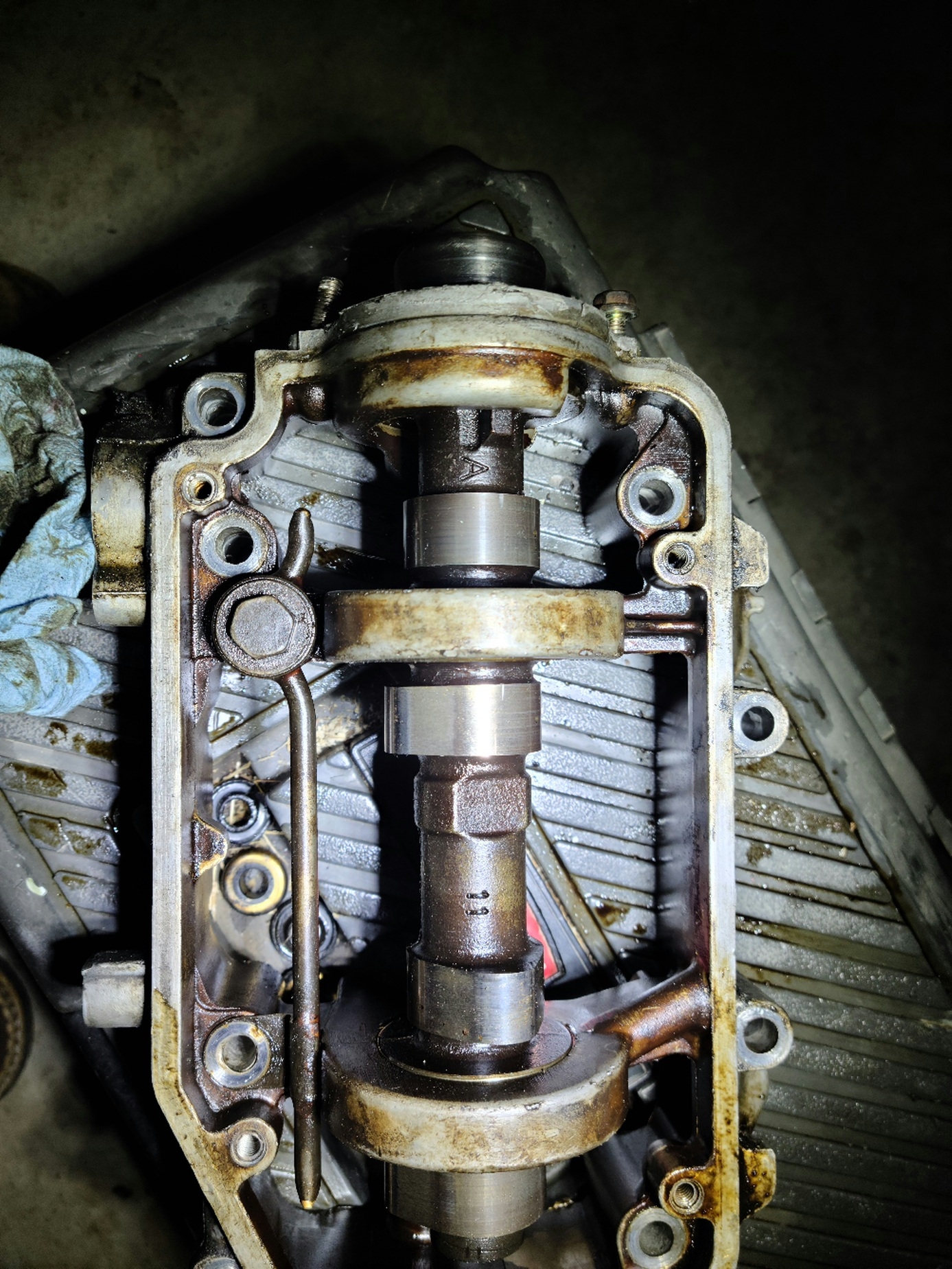

  11. Cams are swapped, tower is bolted back on, rocker arms are all in place. I'm not going to put the passenger belt back on till tomorrow, if not Wednesday if I get time to do it. I'll report back then.

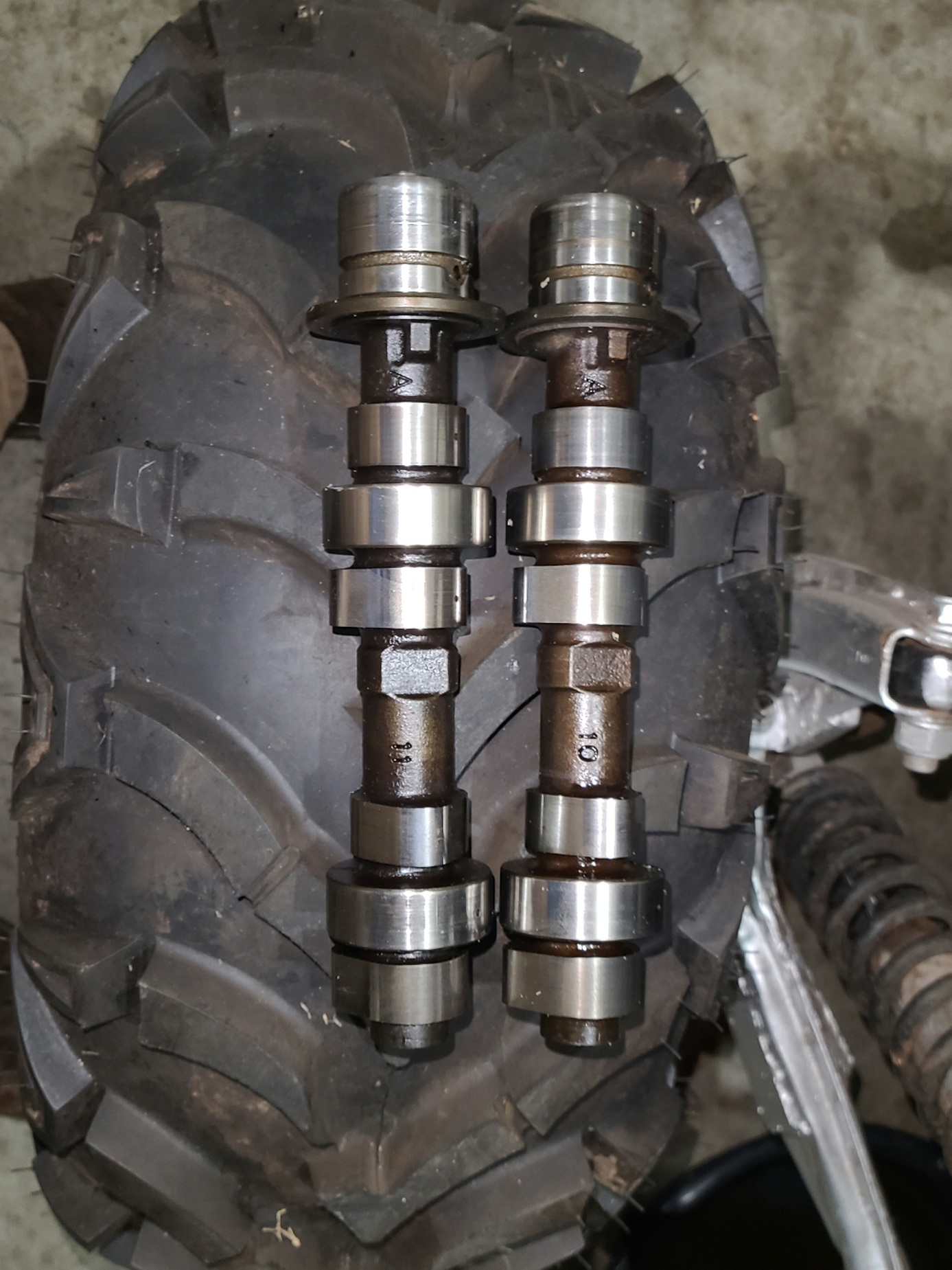

  13. Here are the 2 cams side by side. Carb up top, SPFI below.

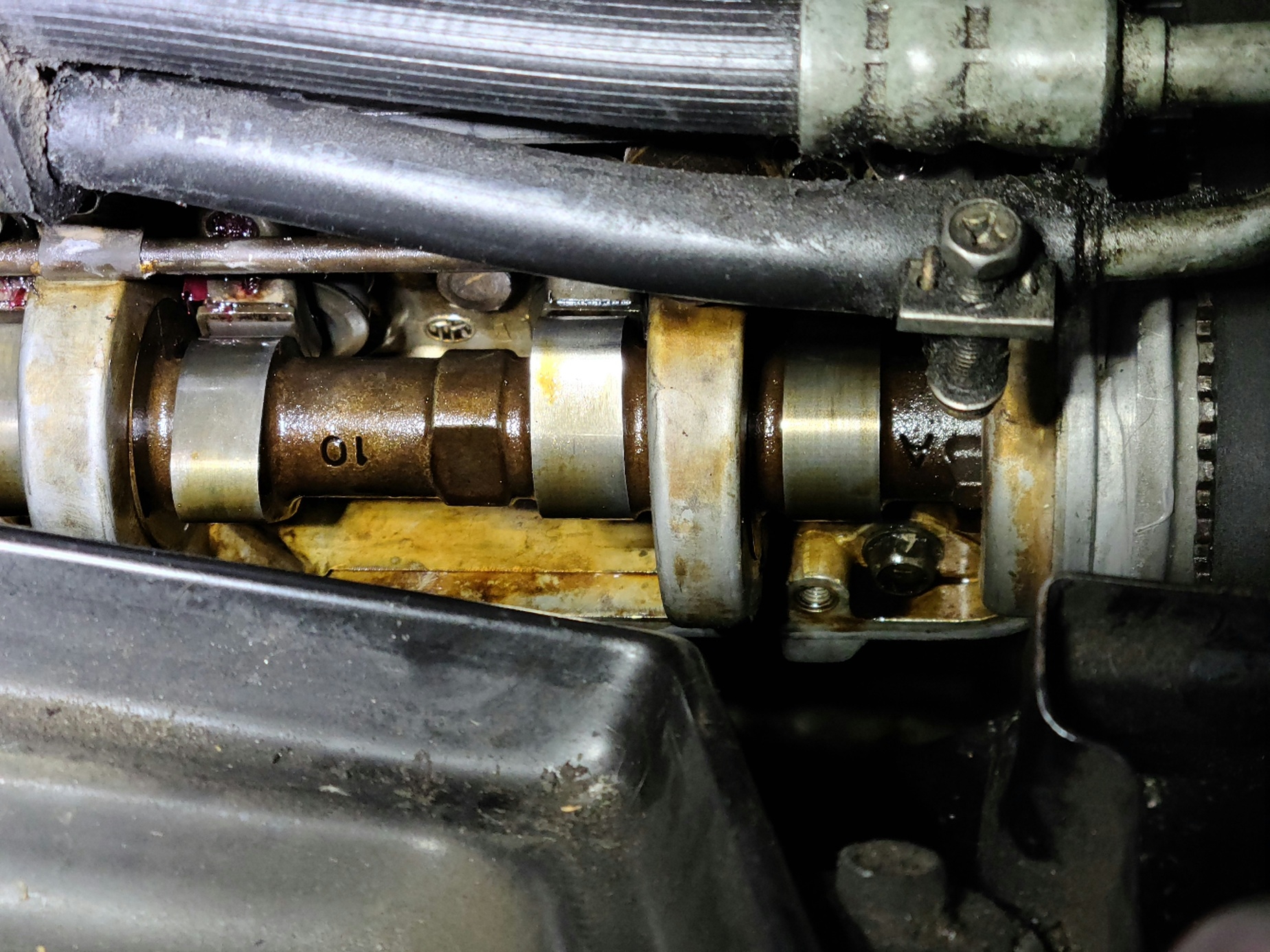

  14. Random question, is ultra gray the only recommended sealant for the cam tower? I have it off now, and it's all still tacky except what got squeezed out when I tightened the bolts down. I put the tower on 2 weeks ago, and waited 24 hours to try and start it.
  15. Looking at the cams now, I'm pretty sure they're different. I didn't notice it before, but the SPFI cam has an A stamped in it right behind the seal, and an 11 stamped in it before the #3 lobes. The carb cam has the same A behind the seal, but a 10 before the #3 cam lobes.
  16. I have the valve cover off now, and all 4 rockers are still on the lifters and valves.
