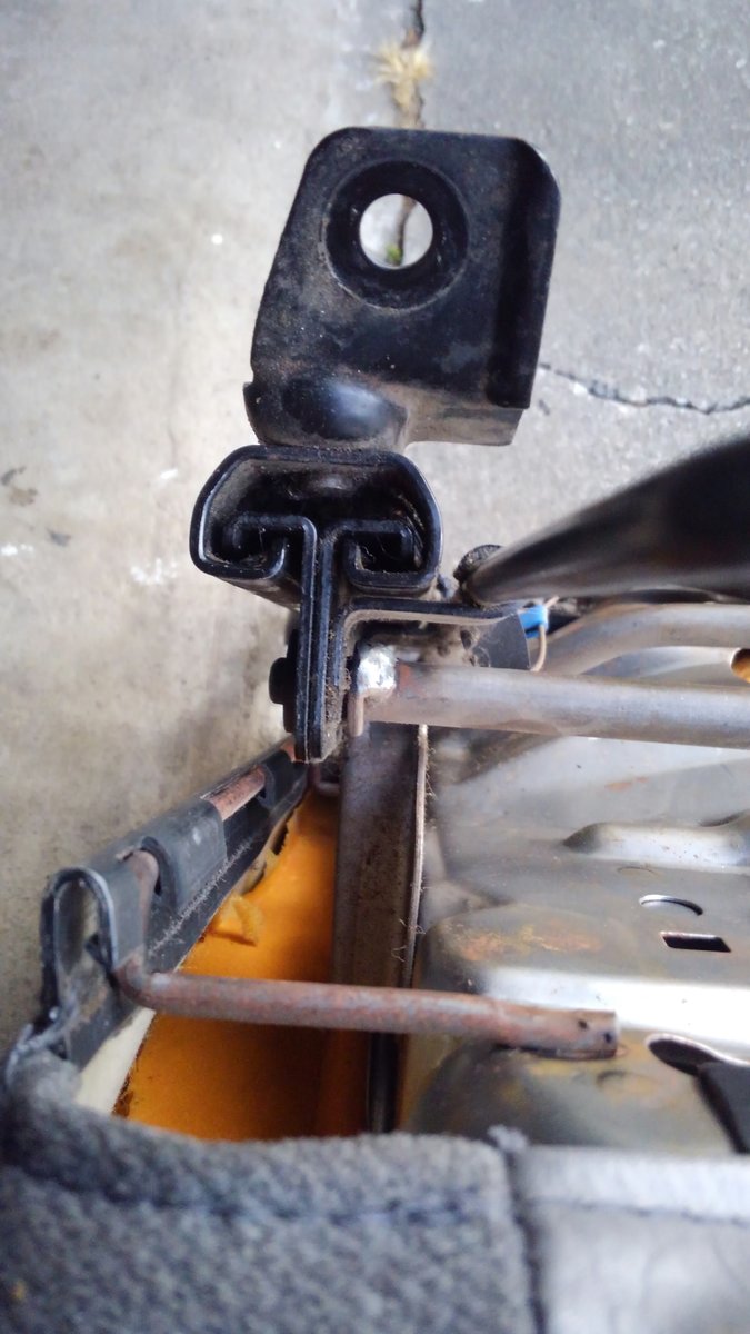

I guess this piece was loose and my toddler found it and removed it for me. The white pieces spin. So is there a position they need to be in? How do I get it back on?- Late 90's impreza seats in my loyale

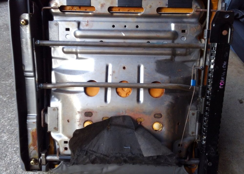

This is the rail on the other side of the impreza seat. No flat bar to mount to, it attaches with that bolt in the top of the pic.- Late 90's impreza seats in my loyale
I've done the reading on the process of the seat swap from kdixey but I'm a little confused looking at the bottom rails on the impreza seats. I'm seeing only one bent rail that I can attach the loyale rails to. Am I missing something right in front of me? - I'm rebuilding a ej22
