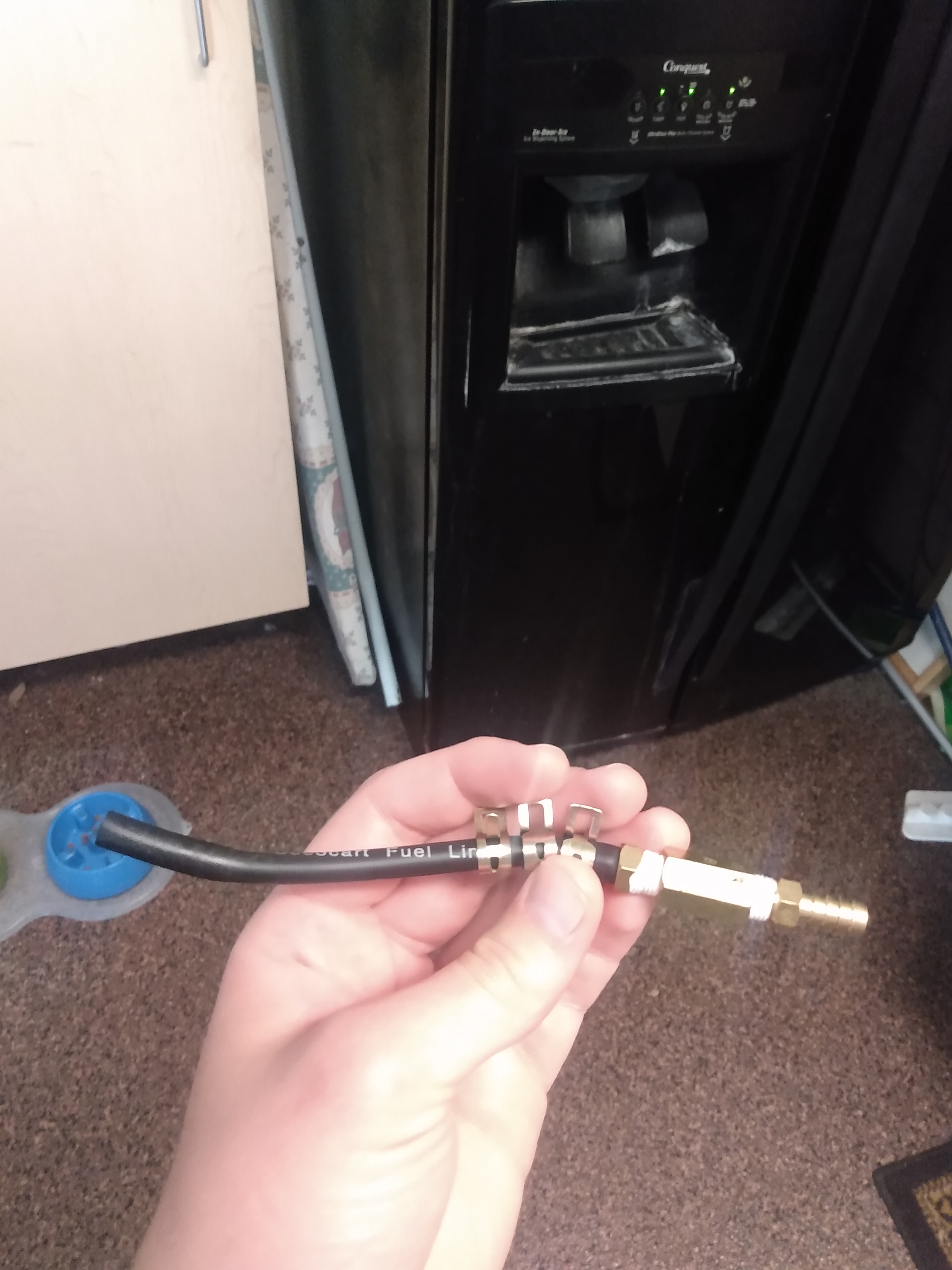

Hey guys, I just wanted to post a little update, I still am going to try a few things more but here is what I did so far: New fuel lines New FPR Remanufactured injectors- tested them as well ----------- This weekend I did what you suggested, Numbchux, I basically wired in the relay for the fuel pump and it works, you can hear it prime when I turn the key a bit and then will hold off until the car cranks. I took the plugs out and they were pretty black, I cranked it with the plugs out and the fuel pump disconnected and there wasn't any fuel shooting out. Changed the plugs and the oil, and same thing happened. I started it fine, then 30 mins later it struggled, then another 30 mins it wouldn't turn over. Tried an hour later, wouldn't start, then I took that little tube off the back of the FPR. There was no fuel in it, it smelled like fuel though. I am not sure if that was too long after running for me to look but I can. Not sure if that was even the right tube to look at but I will look more the next chance I get. Also working on getting a noid light to check the injectors. I think that is everything so far, does it seems like I am missing a piece to the puzzle still? I appreciate all the help you guys are awesome and I couldn't do it without you!! Thanks!

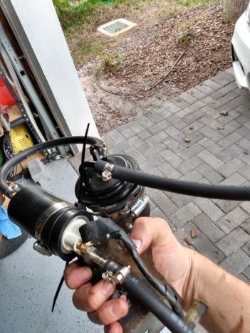

Hey guys, Good point, the filter should be an EFI filter then. Thanks for the replies. I have learned a lot from your responses. I was able to find the Carter fuel pump and Chux, it is 21gph for the free flow and 43psi for the pressure: https://carter.opticatonline.com/part/bcqs-0-carter-p74028?ctx_pt=6256&ctx_p=8&ctx_iam=1 I hooked up the gauges and got some readings and here is what I found... Cold start return side: Fuel pump running before engine turns on: 19 psi Engine Idle @ 800 rpms: 30psi Engine off: 0 psi, dropped here immediately Waited 15 minutes and did return side again: Fuel pump running before engine on: 20psi at 2500 rpms: 36 psi Idle: 30psi Engine off: 0 psi dropped immediately Waited 10 mins and hooked up feed side: Fuel pump running before engine on: 36psi idle: 36-38psi @ 2500 rpms: 38-40psi engine off: 26psi after 10 mins: 16psi after 20 mins: 10psi after 40 mins: 6 psi Do these numbers seem okay? I wasn't sure if that gradual drop on the intake side should be immediate or not. If it would help I can bypass the inlets and return and just run some temp high pressure fuel lines for the intake and return sides back to the fuel pump and the tank and change the oil. Then after running I could see if the newer fuel lines would allow fuel to flow back more freely. I also haven't changed any of the parts like I said before hand yet just for studious purposes. Thanks for the help!! I really appreciate you guys sticking around and giving me all this good advice!!

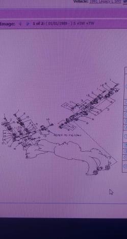

bratboy1 replied to bratboy1's topic in 1990 to Present Legacy, Impreza, Outback, Forester, Baja, WRX&WrxSTI, SVXDo you happen to have the full image of this schematic?

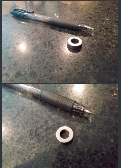

Howdy everyone. I pulled my fuel rails off a few weeks ago and life got in the way and as I was putting them back on I noticed these 4 little round spacers sitting in the vicinity. I cannot figure out for the life of me where they went, does anyone know? The car is a 1991 Subaru Legacy L 5spd. I am assuming they go on the two bolts that hold the rail down but I want to be sure before I put them on as I tried for about an hour to get the rails back on with no luck, I was having a lot of trouble screwing the rail to the Fuel Pressure Sensor. Thanks for the help!

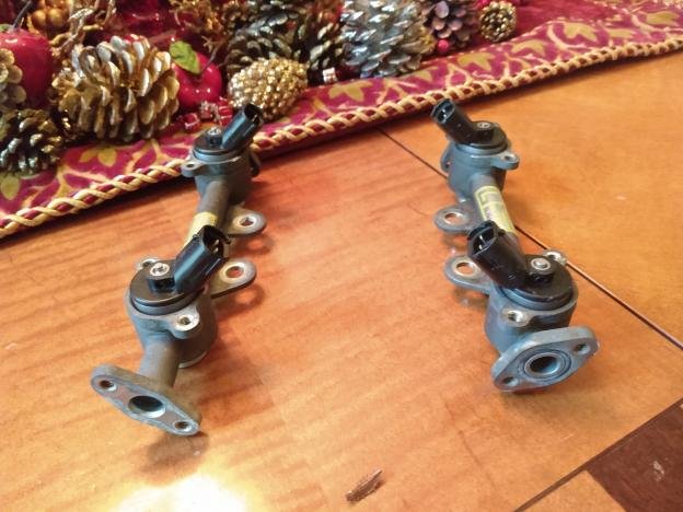

Hello everyone! I am trying to source some seals for my 1990 Subaru Legacy L 5psd and I am having some trouble with them. I went to the dealer and the parts guy and I couldn't figure out which number was the set of seals on the end of the rails like the one picture shows. Didn't see them on rock auto either, does anyone know where I can get some, what part number they would be, or some that match up? Also is the one seal where the rail meets the fuel pressure regulator the same? Thanks for any help! I appreciate it!

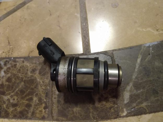

Ok so this may be a shot in the dark but I still need to tear this apart but here is what I am thinking. I ordered these injectors (which had some gaskets on them): https://www.rockauto.com/en/moreinfo.php?pk=928647&cc=1269446&jsn=9 and also ordered this gasket kit: https://www.rockauto.com/en/moreinfo.php?pk=928489&cc=1269446&jsn=10374 When I took my old injectors out and compared them to the new ones, they appeared to have the same o rings so I didn't use the ones that I ordered, I just went ahead and dropped the new injectors in. The o ring pack that came had a big one and a small one the big one matched up it looks like but the small one won't fit around the injector. Maybe these ones are supposed to go into the fuel rail? I watched this youtube video of someone going over some 1996 JDM STI injectors and at 2:20 in the video he puts a o ring into the fuel rail to sit which I did not do. I also did not take the fuel rail off thinking that the injectors were a direct swap. Am I missing the o ring? I know its a different vehicle but I wanted to make sure before I tear into the engine. Also would not taking the fuel rail off and doing that side o ring make a difference? Sorry to be repetitive guys, thanks for putting up with my dumb questions. I am not the best with this stuff so it takes me a bit. Thanks again I appreciate it!

Hey Bennie, I got the new injectors and when I pulled the old ones off one of them was missing both the seals! I got the new ones in and changed the oil and man it sounded mint oh my god I have never heard it so nice. It started on the first crank like 4-5 times yesterday and I thought that was it, I think its been running rich since I swapped it I just never realized it. Then it almost stranded me last night! I couldn't get it to go and I had to hold the gas pedal down to flood it to get me home haha! Today I didn't have to flood it out but it took a bit longer to start so I'm back to the drawing board. I feel like it would leave me stranded if I went far so I'll be local. But maybe that's just how it is I am not sure, I just got that good taste of it running beautifully yesterday and now I am wondering if that was because I just got new injectors but who knows. I'll give it a week and see how it holds up. It still starts on the first few cranks but it definitely struggles. Anyways thank you for all the help you have been I really do appreciate it, couldn't have done it without ya! edit: oil still smells like fuel so its something with that
