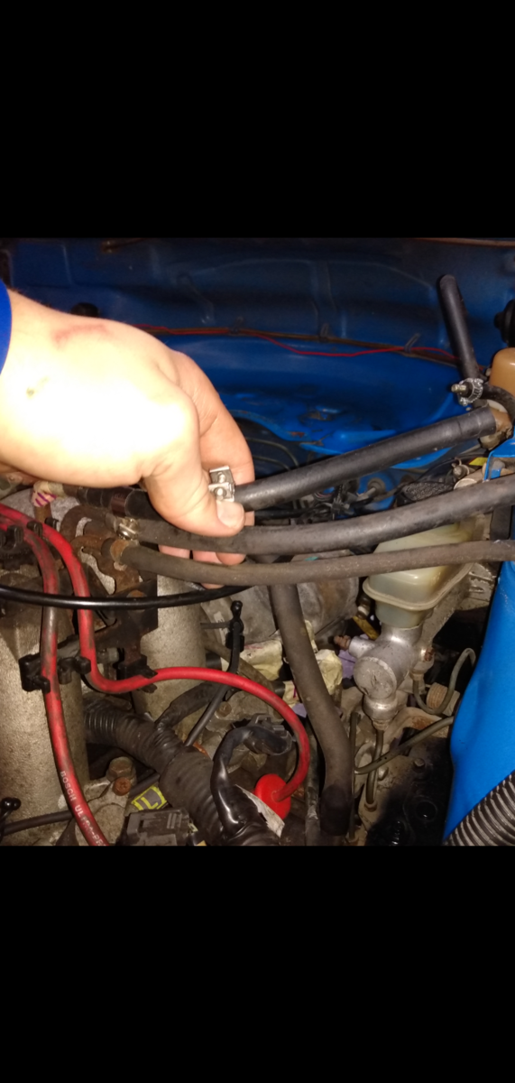

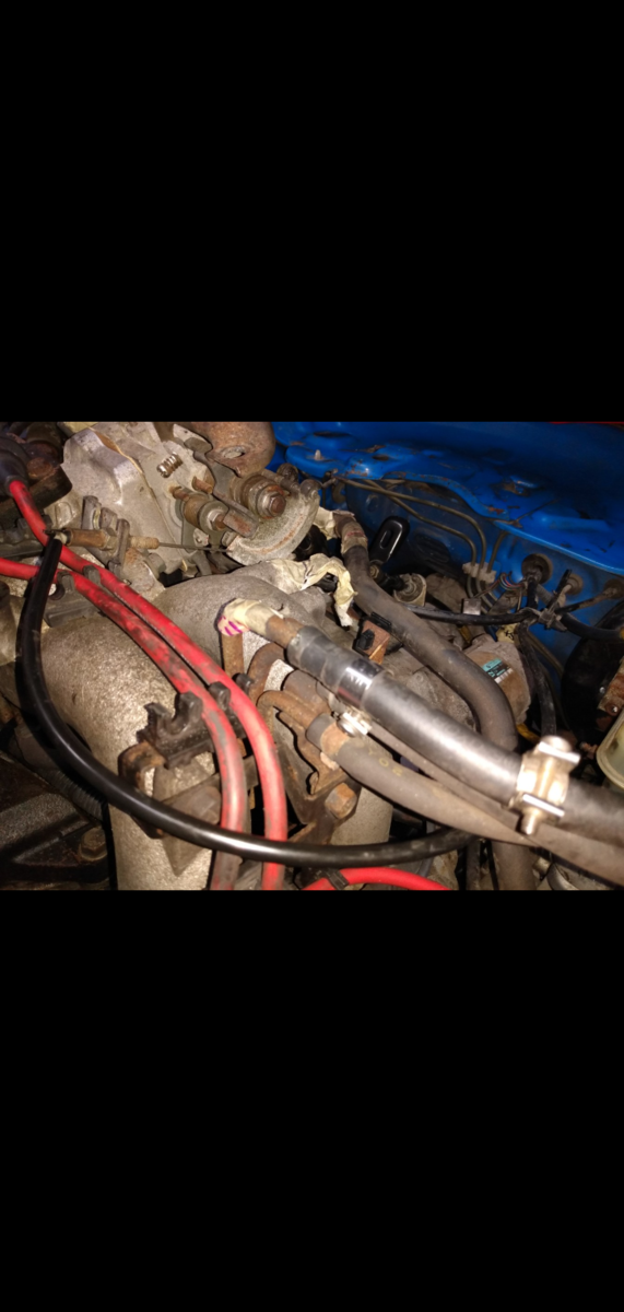

Hey everyone I am currently swapping an Ej 22 from a 91 legacy in my brat. I got a new phone and lost my pics. Is anyone able to identify the 3 lines in the pics I have attached? I appreciate it thank you! I'm in the US btw.
