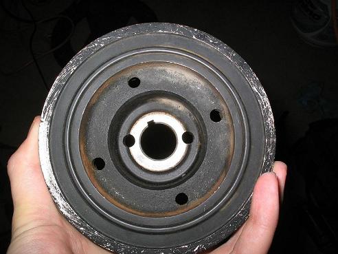

Hey everyone. I've been looking at this for only about a day but I don't have a clue how this could be happening. Car: 1990 legacy 5speed AWD relevant history: I did the TBelt. I messed up the crank torque and destroyed the keyway, woodruff key, etc. I fixed that with a kit from S-wings - replacing the pulley, timing gear, and woodruff key. The pulley is fixed to the gear with 2 spring pins, the woodruff key essentially only used for alignment. I torqued it properly with a chain wrench to hold the pulley. Then I drove the car for 4-5 months until today. Had no problems. A few weeks ago I started having some belt squeel at start up. I didn't do anything about it until last night when I looked under the hood. Well, I can't really tighten the belts any more. The power steering belt tensioner (rotates the alternator) is about to the point where the pinch-off bolt "bushing-looking thingy" starts to interfere with the power steering bracket. If I tighten the tensioner, the pinch-off bolt starts to deflect because it has no where to go. The AC belt tensioner goes the opposite way. This one I can probably tighten but there won't be many threads left sticking out the bottom when I finish. I compare this to the setup on my 1991 legacy, which has about an inch or more to go on both tensioner assemblies. Is it possible that I've stretched the belts? They don't show any signs of unusual wear. I compared them to the ones on the 1991 legacy and they aren't grossly out of whack (didn't remove belts from 91). It's like the crankshaft pulley shifted up or everything on top of the engine shifted down. Neither of these things seem possible. I have have checked the crank pulley several times in the past and not noted any severe wobble. Any other ideas? Thanks so much....

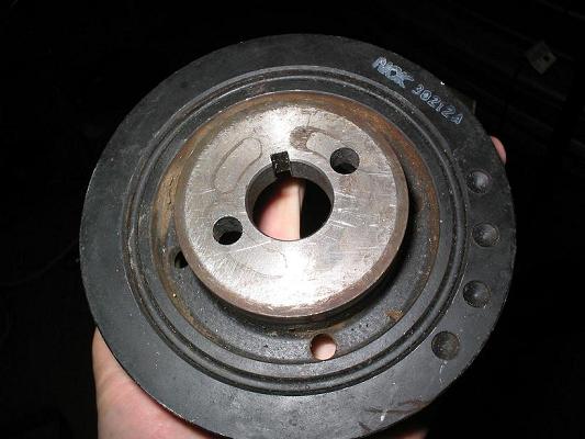

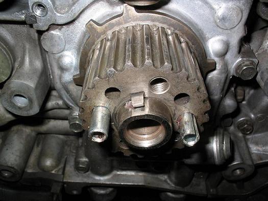

Sorry to resurrect thread... maybe this update will help someone. I finally ordered the kit and started installing it today The kit is made from good quality used parts. The gear and balancer assembly come fitted together with the roll pins, with the keyway fit into the notch at the back of the gear. You have to remove the key from the gear, and seperate the gear and balancer to perform the install. The roll pins are 1" length and will slide further into the timing gear if you bump them (I was using a hammer to get the gear on the crank). They can be bumped back out to the correct insertion (1/2") after removing the gear if this happens. I recommend putting a socket longer than 1/2" around the center of the gear and tapping on that to prevent pushing the roll pins in any further. I'm somewhat surpised the holes in the gear aren't just drilled to 1/2" depth to prevent this from happening. But I'm not complaining. The holes in the balancer are drilled slightly larger than those in the timing gear. It is still a snug fit but can be seperated by hand, and the pins will remain in the timing gear. Seems like a good fit with the timing gear, now to line up the belt, install the balancer and torque the bolt down properly! This car has been sitting 4 months!

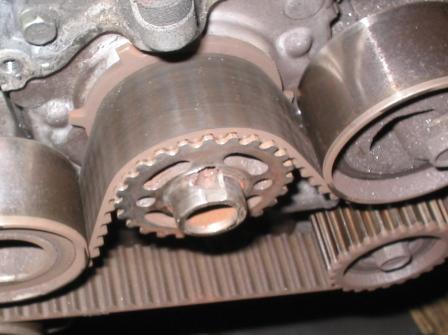

Yes, you should be able to find the info you need with the search function. I have the same car and have done this with Haynes manual and it went ok. If you do not have notches for whatever reason (broken etc) on the upper part of the inner timing belt covers, you can count number of teeth and you will be ok. Your new timing belt should have marks on the belt itself indicating # of teeth (3 marks, be sure the belt is facing the right way and they will all line up). If you have not taken off the old timing belt, get the crank in the right position and the two cam sprockets will have marks pointing straight up. I am assuming your old belt did not break, slip, etc. The good news is, if you do it wrong, you will not damage the engine. Your car may run like poop until you get in there again and set it right. Be sure you install the harmonic balancer/crank pulley properly. You must put about 130ft lbs of torque on it or it will come loose and you will have all kinds of problems. Don't ask how I know. Be sure to get a chain wrench as the manual suggests for this torqueing or immobilize the engine at the flywheel.
I called to check price and availability. I didn't understand from your description that what they are selling is a balancer assembly that has the pins mounted in it which interface with the two holes in the sprocket. So I don't need to pull one of those from the yard. Price is $175 but he has to order some parts and make them, so they are not currently available. In the meantime I haven't been able to get the sprocket off of the crank. Any suggestions here? I already tapped the two holes and put some bolts in. I would say that your estimation that the keyway is now only used for alignment and the load is transferred to the pins is correct. Depending on the tightness of the fit I would still think that some of the load is on the key but not very much, especially since the keyway is now garbage and can't really take any load. I hope those pins are hardened steel because there is a lot more torque out there!
That sounds like a hot tip. Let me get this straight, the pins are installed into the timing sprocket, parallel to the crank, and extending into the balancer/pulley assembly? Do you have to do any drilling, welding, tapping etc? Thanks for the help guys, I am going to pull off the T-belt and sprocket now and see what the real extent of the damage is.

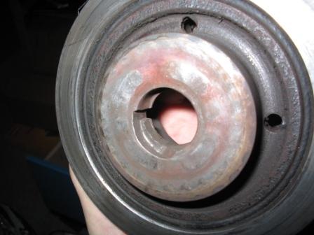

Well guys it's been a while since I needed or was able to offer any help. Now I am in it pretty deep I think. I was having probs with temp guage in my car. Found a bolt in the wiring shorting something to ground erratically. While under hood noticed severe vibration in harmonic balancer so I checked main pulley bolt. Sure enough, loose. Removed it and took off the pulley. The woodruff key had busted up pretty good, carving out the inside of the main pulley/balancer. I know it needs to be replaced. On the other side, the keyway seems damaged. In some of the other threads I have read about welding this back together. I have a 235A AC welder but I am a mediocre welder at best. Does this need to be spot welded or a full penetration weld? If so, how would I ever replace timing belt/work on this area again? Can it be done with engine still in car? I am confident the engine has many more miles on it but I do not see the value in yanking it for a teardown. I'd rather sell it and move on. I am also tempted to work some other solution out in which I drill through the sprocket and crank, and then the pulley and crank in a radial direction and then tap and thread a set screw into each to hold the pulley and sprocket in place. I realize I cannot do this by hand, just tossing it around in my head. Need to devise a jig if I am going to explore this. Anyone ever successfully repaired this before? Pics/methods much appreciated. I think I can source parts from a local yard.
