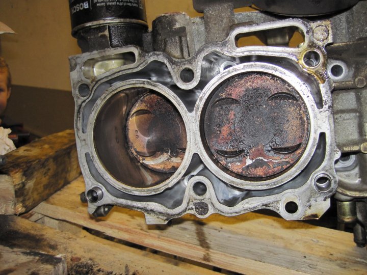

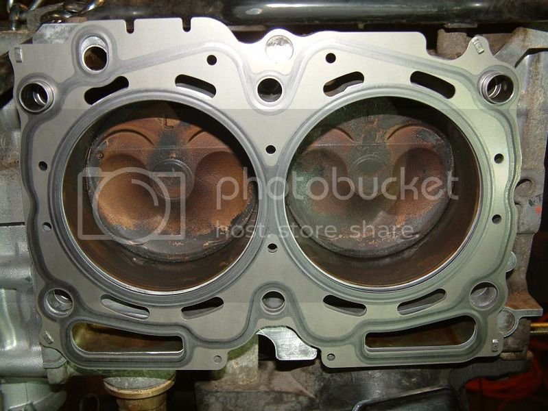

The biggest difference I have found in the two short blocks is the pistons, the EJ259 block (03-05 2.5 SOHC w/single port and California emissions) has a large dished out section in the piston and the EJ251 block (99-05 2.5 SOHC w/dual ports and federal emissions) has a more traditional and symmetric shape. I have heard from some people that EJ251 heads will work on a EJ259 block and I have also been told that they might not work. Im not sure if there would be issues with valve contact/clearance and compression ratios due to the odd shape of the EJ259 pistons. You can see in the pictures how different the tops of the pistons are.

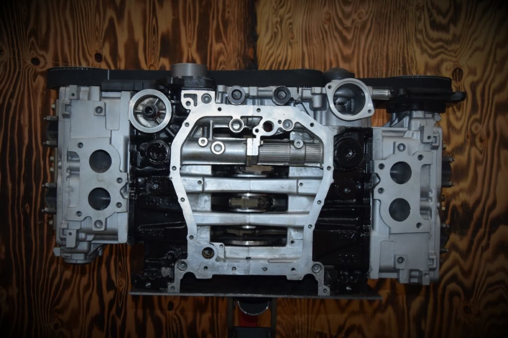

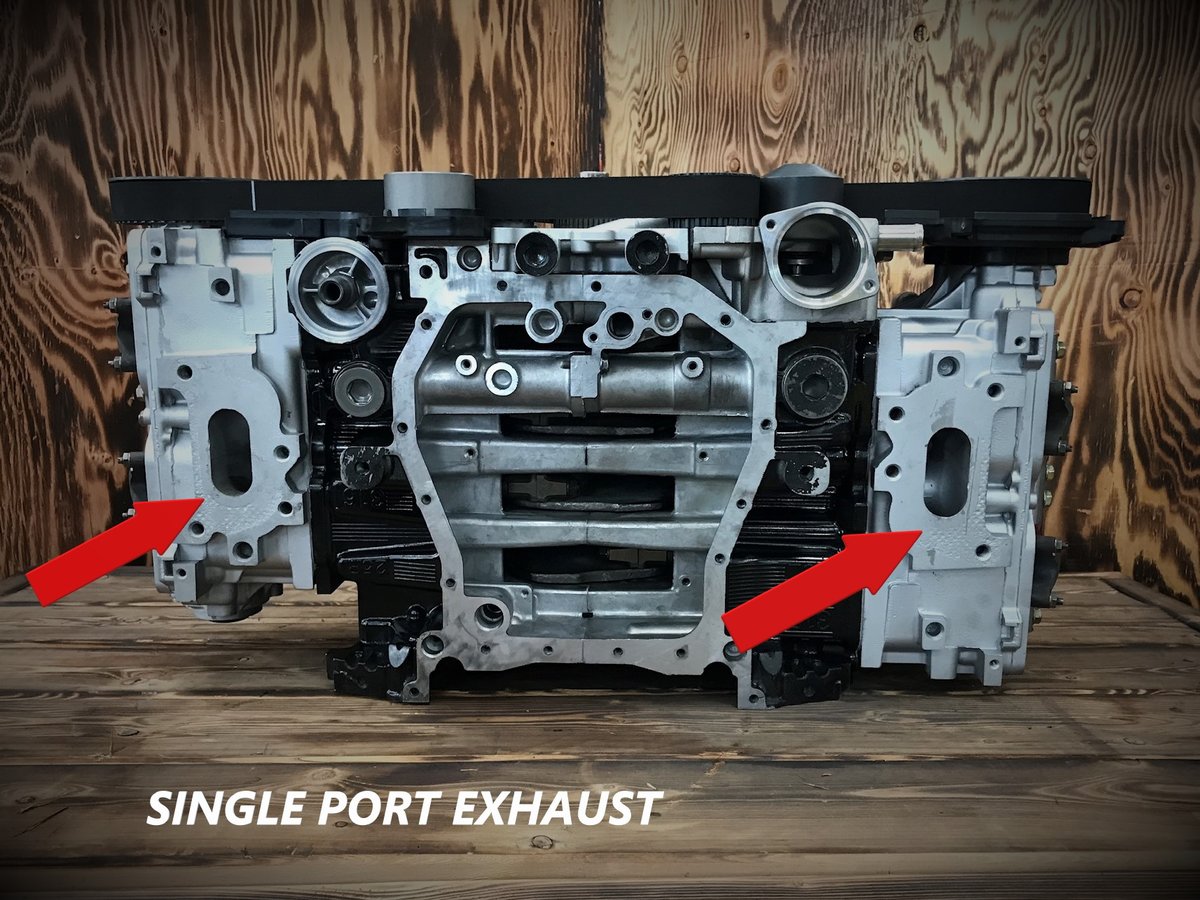

I was also under the impression that all the 2.5's SOHC had the dual exhaust cylinder head ports but upon further research I found out just like another member stated that if the engine was from a California car (2003-2005) they used a cylinder head with the single exhaust port to meet stricter California emissions. There isn't a ton of information out there on these engines that I could find that's why I was unsure if the short blocks were the same. I know the intake manifold, cylinder heads, exhaust, and general wiring is all different from my 03 Forester 2.5 SOHC but I was hoping that the short blocks were the same so I could bolt the intake from my forester onto the short block that had the California emissions heads. I have included two pictures, one is an 03-05 2.5 SOHC with California emissions (single port) and the other is a 99-05 2.5 SOHC (dual port) with federal emissions. If someone could tell me for sure whether the short blocks are the same I would really appreciate it.
