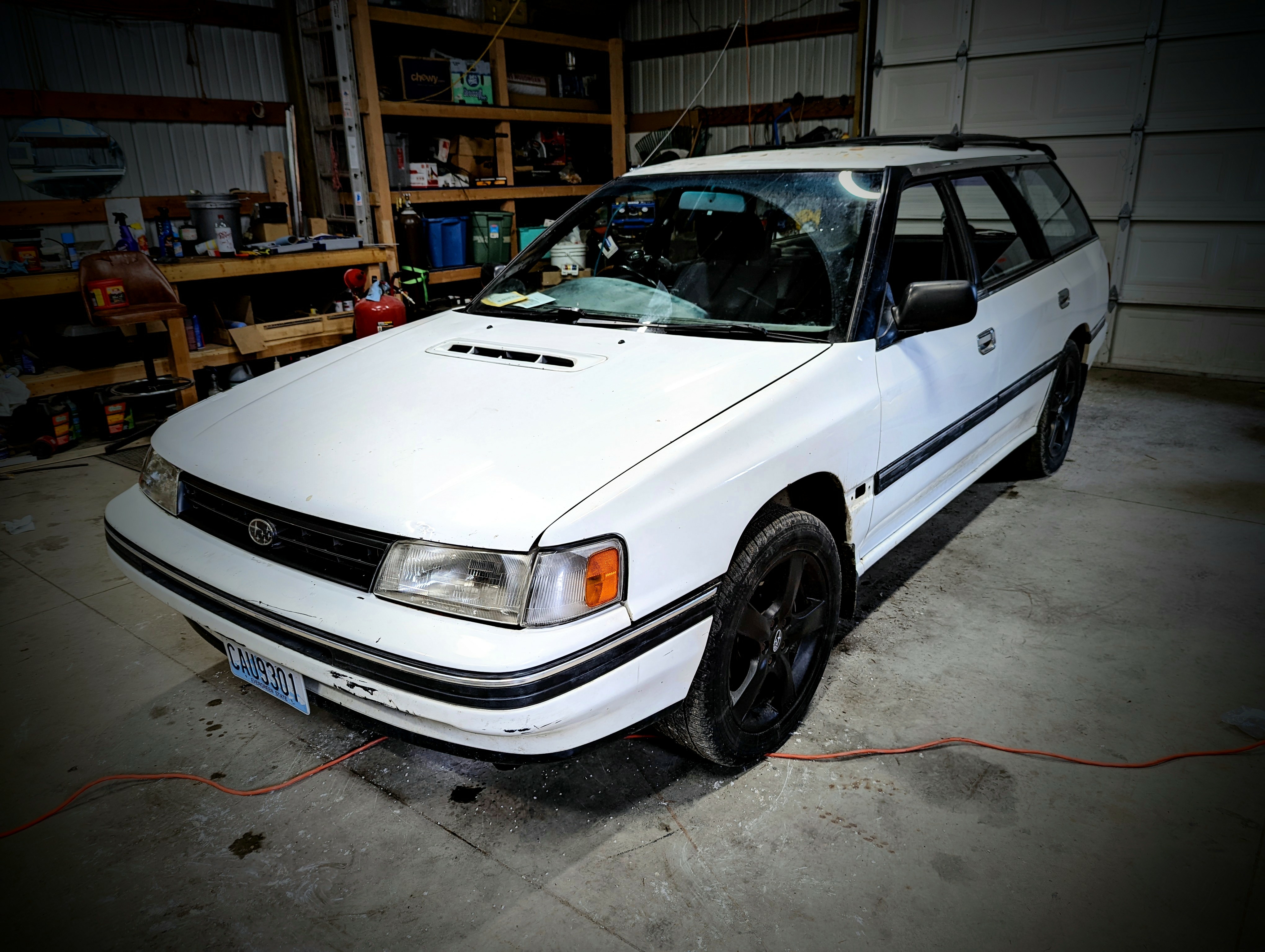

The 91 Mail Legacy, consumer of paychecks, deliverer of assorted packages and letters.

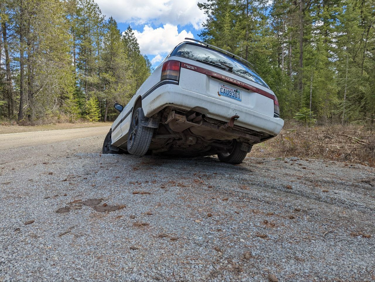

One thing it doesn't do very well is nice deep ditches. Oops! That's what I get for pulling forward away from a mailbox while looking over my shoulder for oncoming traffic
My daily work rig that's needed basically everything replaced. Harmonic balancer, crank pully, transmission, ECU, TCU, door latches, window switches, hood, a door... The original steel wheels on it were so rusty that they had large chunks of steel missing from them! Don't ask me how the underside isn't solid rust. Seems like it has low compression on a cylinder, it's probably destined to not have power steering for the near future, I've been unable to get the cruise control to work despite my best efforts... But at the end of the day I love it and I can't help but throw various little odds and ends at it whenever I get the chance. Hopefully I am gonna find a nice clean white facelifted car at the junkyard someday soon so I can grab some facelift fenders and lights! Already have the turbo bumper and a facelift grill, but the car I was pulling parts off of had pretty rusted out fenders... Would also like to put forester suspension in it to help with delivering to those hard to reach mailboxes. The 16's gave it a little more height but a couple more inches would be amazing.

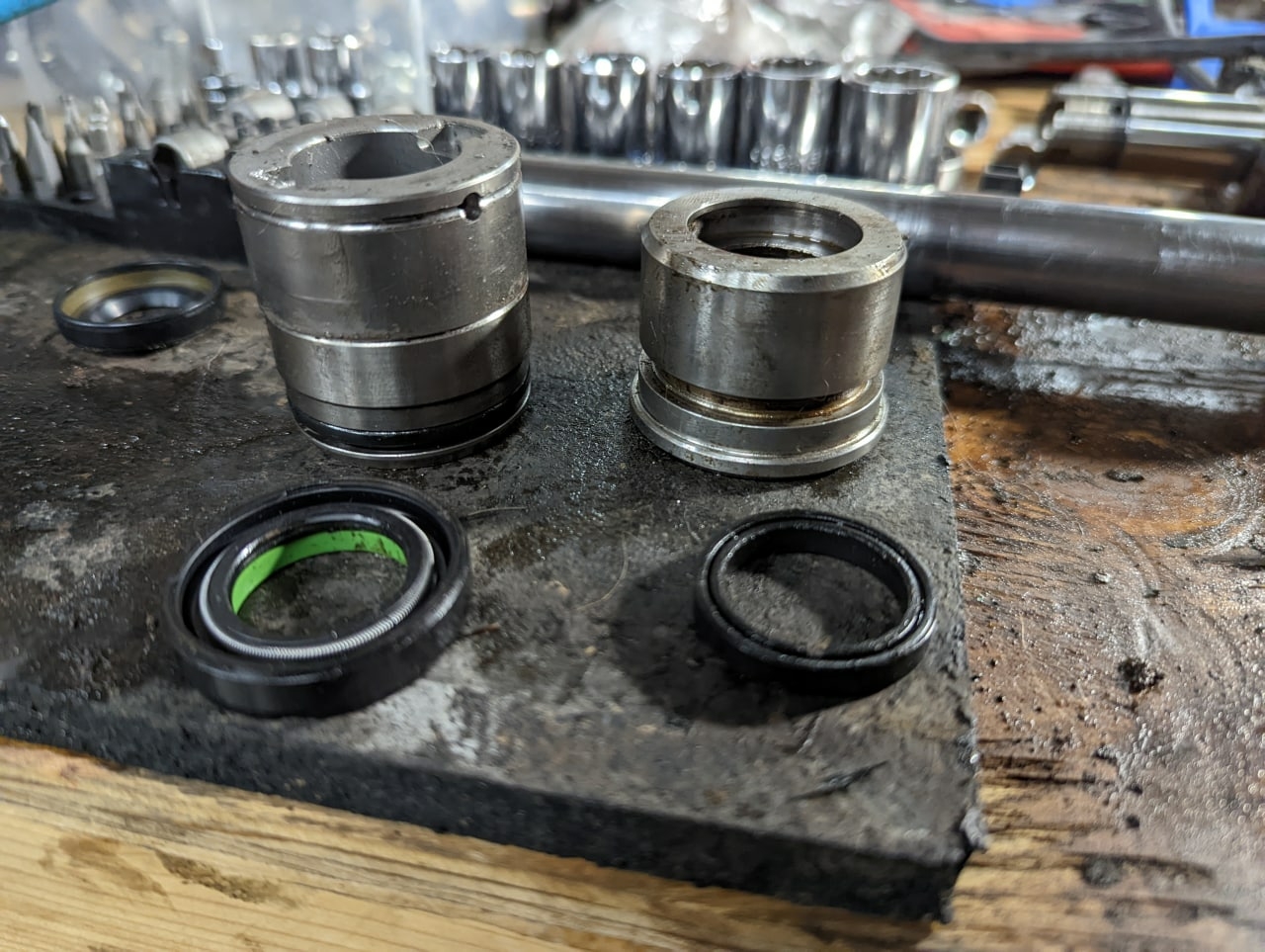

Making a new thread on this for visibility. I just tore apart the steering rack on my 1991 RHD Legacy to find that the internals were quite different from the LHD version that I pulled a junkyard rack out of. Unfortunately this means that the reseal kit I bought is useless to me and I am now trying to figure out if this RHD rack is maybe out of a different model of Subaru and was simply reused for the RHD version? My car was made for the USDM if that helps... On the right is the seal and its retaining gland that I pulled out of my rack, and on the left is the one out of the legacy rack I pulled from the junkyard. As you can see they are quite different and it's got me scratching my head on how I can get this rack resealed and put back together in time for work this weekend and not have to bite the bullet and put it back together without resealing it. I would hate to have to get it aligned only to have to tear it all back out again in the near future.

PostalLeggy replied to PostalLeggy's topic in 1990 to Present Legacy, Impreza, Outback, Forester, Baja, WRX&WrxSTI, SVXUnfortunately the parts are all different between the two racks... right down to the point where the reseal kit I purchased won't work on my rack. I'm now in a bit of a predicament as I have work in 4 days and a rack that is completely torn down with no way of me resealing it. Attached are some photos that show the difference between these racks. I'm not sure if I can even buy a reseal kit for it, or if it's something I would need to import. Even the Teflon seals are a different width.
