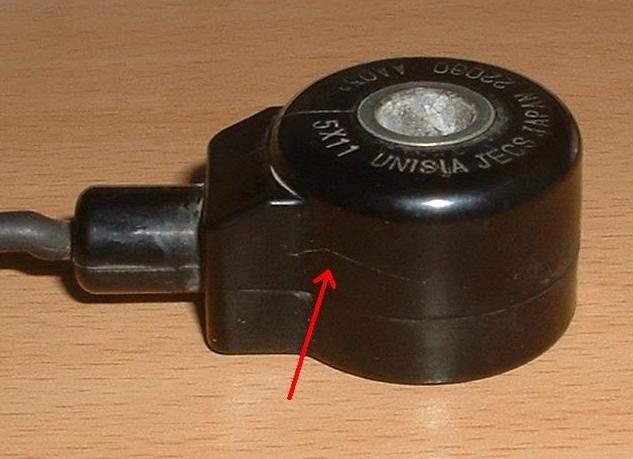

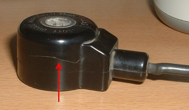

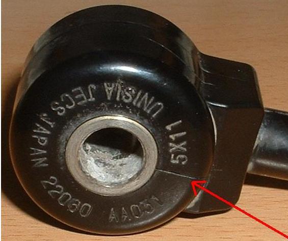

Pictures of my 10-11 y/o knock sensor.
itzik93 replied to itzik93's topic in 1990 to Present Legacy, Impreza, Outback, Forester, Baja, WRX&WrxSTI, SVXBoth have white connector. the "old" one has a smaller white connector, the "new" one has a bigger white connector. I had to cut the wires and solder them. Itzik.
It started 4 monthes ago. i was climbing uphill with the gas pedal on the floor for at least 1/2 a minute. It was the first time since i have the car that the "check engine" light was ON during driving. Since that time till this week, it never came back. But last week i drove uphill's with the gas peda on the floor - and it came back AGAIN. This time i pulled the code, and it said 22. check my manual and it seems to be the knock sensor. The car is legacy MY96, automatic, FWD, EJ20 with almost 173K k"m (thats around 105-110K miles). As usuall, i came to this forum to search for information. many of you said that the sensor might be cracked (a common age "problem"). I found (easly) the sensor on the motor and i saw it has only 1 wire. i thought it would be a good idea to start with cleaning the contact between the sensor and the engine - might be dirty of corrosion. As soon as i took out the sensor, i saw 3 cracks in different direction ! A good friend of mine gave me a good knock sensor that came off from another engine, i checked that it have no cracks, and installed it. enjoy the pictures :-) Itzik
