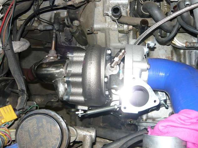

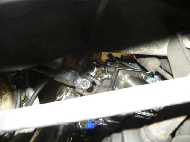

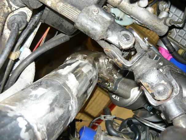

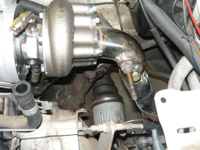

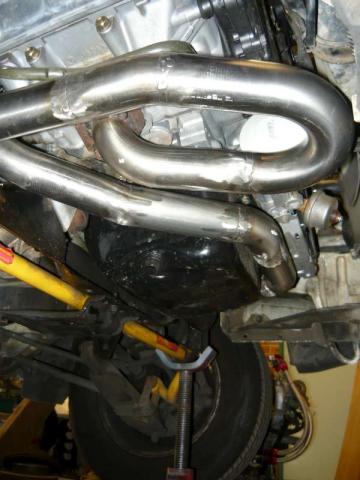

My header is finished and the detail work on plumbing a non std turbo is taking place .
My header was made of 1 3/4 bore stainless tube and is equal length , slightly longer loop on the turbo heads side than the TWE one .
Also mine joins to a single tube just before the turbo flange and when unbolted comes out easily .
Should be running tomorrow , cheers A .
