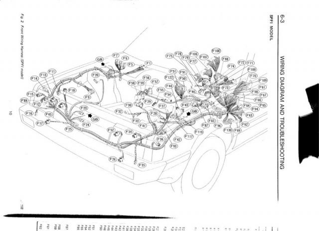

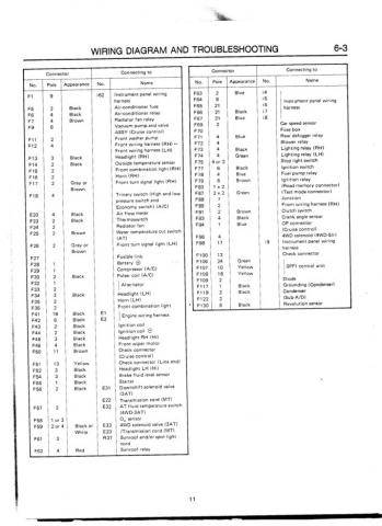

April 18, 201015 yr [attach]7619[/attach] [attach]7620[/attach] Sorry for messing up this thread, tryin to have a readable pic within size limits Edited April 18, 201015 yr by T'subaru

April 18, 201015 yr Okay, maybe this will help someone else chime in. First pic shows the general area of the relay in question, cruise servo and weird 4wd fuse, (his donor was fwd, so the wire may be there on the harness, just not used) second pic shows the only relay over there, and it has a blu/yellow wire, like he posted third pic shows the connectors, really buried down behind the headlight - isn't the big one the headlight itself? and the smaller one the side marker? pic not taken was rad and fan connectors, which hang in space in fairly plain sight...
