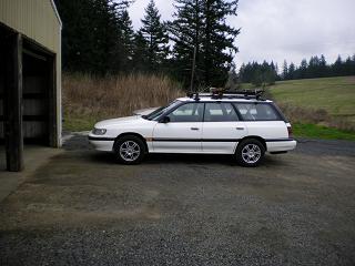

how did you measure the 4" difference? with only a 1" block, that would mean you gained 3" from the forester struts alone? That sounds like a lot....
3 inches is about right. . .
I have been considering a lift for my 98 Legacy for awhile, will these fit the 98?
Also what is the difference in using shocks/struts from the Outback in comparison with the Forester?
Thanks
the front will work, the rears would need to have the hole elongated, or new holes drilled, very easy to do
outback/forester struts are the same, forester springs however offer a slightly higher spring rate
installed the kit on a customers 94, turned out awesome, no camber change
There are some real differences Forrester v. OUtback struts, springs, and tophats.
Outback struts are 3/4 inch longer from bottom to spring perch.
Putting Forrester struts alone on a Legacy will result in saggy rear end. You need Forrester tophats (taller) or just go with Outback struts.
Best recipe is for even a bit more lift, 96-99 Outback struts, Outback springs. Forrester Tophats.
Thanks for the info! What year Forester tophats do I have to stick with?
the fronts are a direct fit, but the rears require a little work with a dremil, ive done it, not too bad
