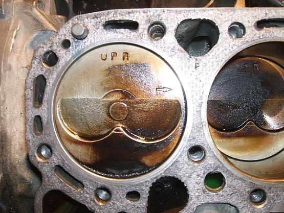

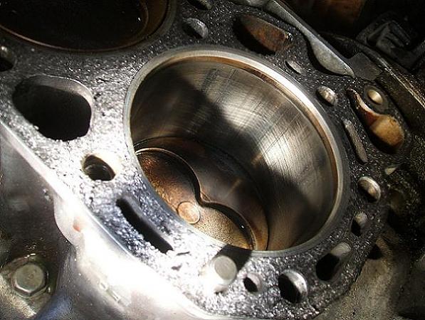

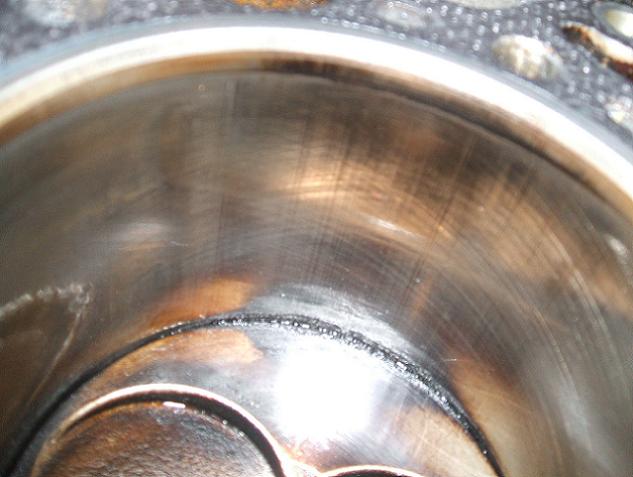

Well, I was just a little worried that I'd mess something up and shorten it's life in the process, but you are right - I might as well do a full rebuild. I pulled the engine last night and I noticed a scrape on the cylinder wall right near the top...does this mean I should get a new sleeve pounded in there? It's a little scuffed, and I can feel the bump with my finger but I can still see the cross hatching all the way down the cylinder, so the issue appears to only affect that 'ring-ish' part of the sleeve (not sure what that ring piece is called). I will attempt a ring job, but I doubt I'd be able to pull off and ram a a sleeve in by myself - machine shop once it's all apart I guess? You can see the torched bottom part of the piston where the junk was getting past.
Here's the pics...
Technically the sleeves are not replaceable...unless you go aftermarket and spend WAY too much money. Even then in most cases the sleeves end up sinking into the block after several heat cycles and you get a blown headgasket again and have to re-deck the block to match the sleeve. Most of those cases you cant deck the block anymore because its been decked too much already.
WJM has been there and seen it all on sleeving subaru blocks. To get it done right costs more than your average sleeve job.
I would do a full teardown and rebuild and go 0.25 over on the cylinders. If they have not been oversized already you have two overbores you can do; .25mm and .50mm.
There'd have to be more serious damage than that to need to go .5mm over. I've seen worse clean up with a .25mm bore.

I am guessing that some debris must have ended up in that cylinder because the damage is right on the bottom, perhaps then it toasted the ring(s) on the piston creating the huge blowby. I don't believe that the ding in the wall is enough to be leaking that much compression on its own (40-50psi dry, then 150 wet) and perhaps it's just another symptom of the underlying issue.
