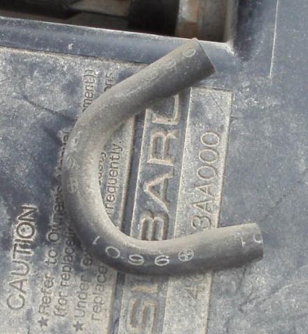

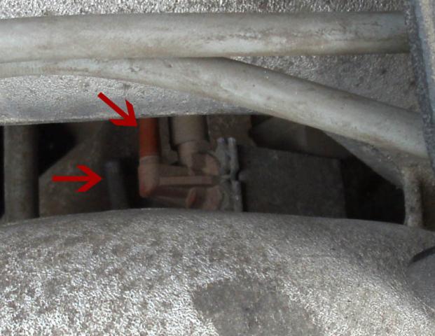

ok, a little new info on my issue...
1 - found a small vacuum line that was disconnected (see pics) the hose was actually replaced since it was as hard as a rock... :rolleyes: the second pic shows where the ends attach...looks like maybe egr switch??? could this cause running issues?
(location is passenger side under the intake)

Evap purge control solenoid. That broken hose would cause a small vacuum leak, which may make it idle a bit funny, but would not be intermittent. You're that much closer to getting it running right though. :lol:
gee thanks :rolleyes:
