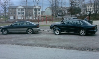

i just picked up a 1999 Subaru the other day with my 2003, picture attached. i wouldn't recommend it but it was close to home and not that far, one time deal, etc.
brakes, engine, and trans did better than i thought they would, handling did worse than i thought, it wouldn't take much to loose control back there with the light weight in the back. but i was driving a lot of steep up and down mountain twistys so i was feeling it a lot more there than on the straight flat parts. if you're towing all flat land you'd hardly notice anything except pushing while braking/correcting/emergency move (not a fun feeling).
i've towed all sorts of other stuff too, the sedan will tow a small trailer just fine. the more often and heavier loads you'll be doing the more you'll want to err on the side of caution. there's no black/white or yes/no, or can/cannot do about towing. i tow a lot and have a truck for that (usually!), no way i'd want to carry those kinds of loads regularly.
