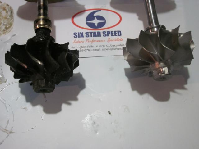

For anyone thats been reading this post, just got word from six star speed that the turbo failed because of oil starvation. It did a number on the core and will cost more to get it repaired. Its still cheaper then a new turbo.

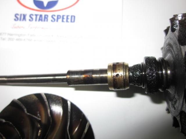

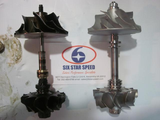

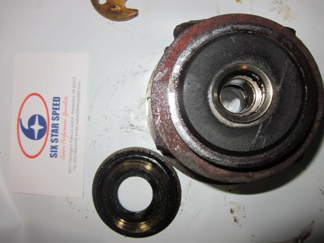

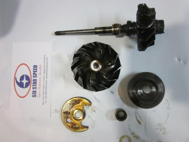

I have some picture sent to me by Six Star Speed, please have a look at what "oil starvation event(s) can do to your turbo's.

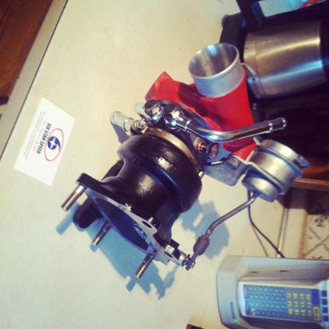

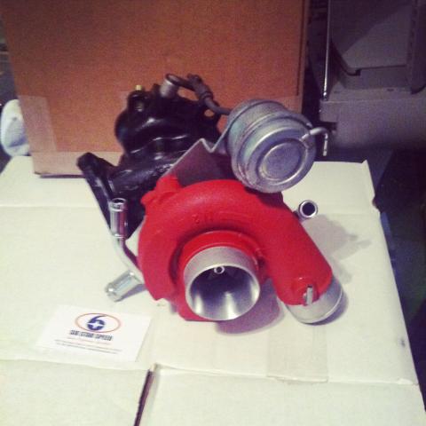

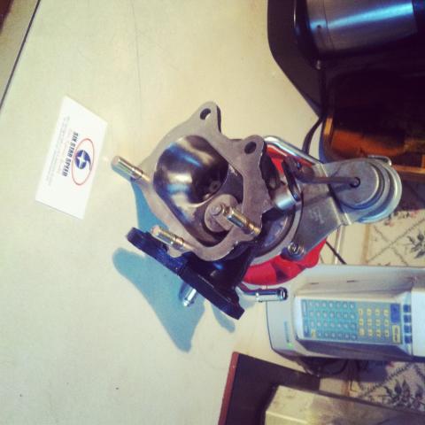

Ok guys i got my turbo back today, and i for one think it came out great. Thanks to the guys at "Six Star Speed Subaru Performance Specialists", please check out the pictures of it, the ceramic coatings came out great and the PnP is smooth as glass and no more movement at the shaft. They also gave me new seals for the up pipe, and the exhaust, one more thing is a new flex oil line to the turbo.
That is beautiful! What did they charge for that service? Just for future reference.

Total cost was $696, which covered the rebuild and needed moving parts, PnP, 2 coating on the turbines, center bearing housing, compressor wheel, turbine shaft and wheel. All that and new seals for up pipe, and exhaust, plus SS teflon line to the new banjo bolt ( which is little larger then stock, oem is .055 replaced with .060 ) and an fitting from the avcs pipe to the new line.
I for one feel them a small increase in the banjo bolt should not overload the turbo with oil, i feel safer with a little more lub to the turbo then less because i don't care to do this again.
It also comes with a 2 year warranty on the turbo from Six Star Speed, so to me it was a good deal.
