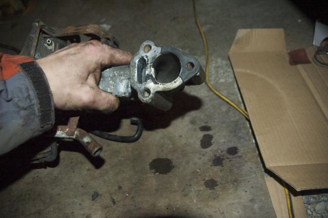

finally got to the intake manifold today and after a couple hours of hose removing i found the culprit to my white smoke upon start-up
definitely glad i did not step into headgasket land right now
