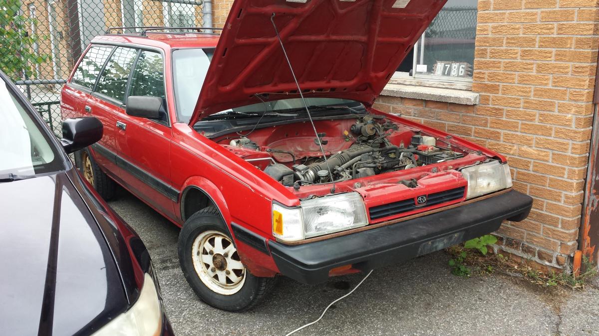

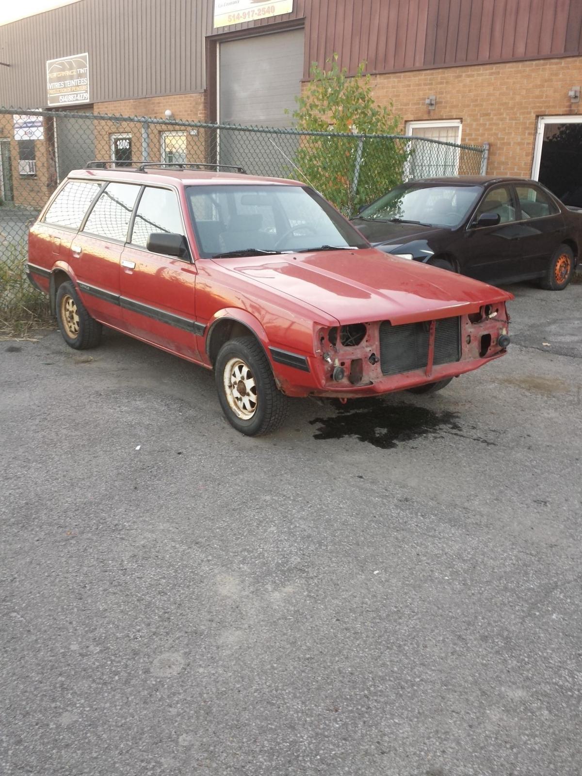

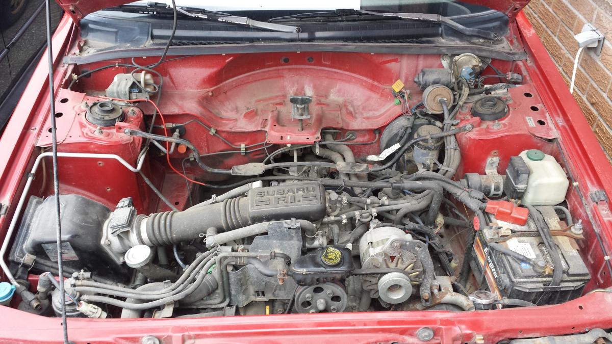

November 14, 201312 yr Hey guys! I'm a newguy on the forum but I did lot of research last months. A year ago, I bought a1991 Subaru Loyale! I wanted a nice winterbeater something nice rare and awdwas perfect. When I saw this car I did not know about it so I checked onInternet to compare it with other but it was the only one for sale so Iconclude that it was a rare car!! So I bought it. I'm from montreal andI drove to Toronto to take it! It has 275000km on it but the body is clean forit's km and age. It was droven in the north for a while so no salt only sandthat's why! The interior is MINT MINT in grey leather! So back home, I had topass a governemental inspection that I kney some of the problems like theexhaust and cv joints. But when the motor is hot, very hot it is ok but cold it has piston slap or valve knocking.. poor ea82 and i forgothead gasket.. Sorry i dont have lots of pics.. :S

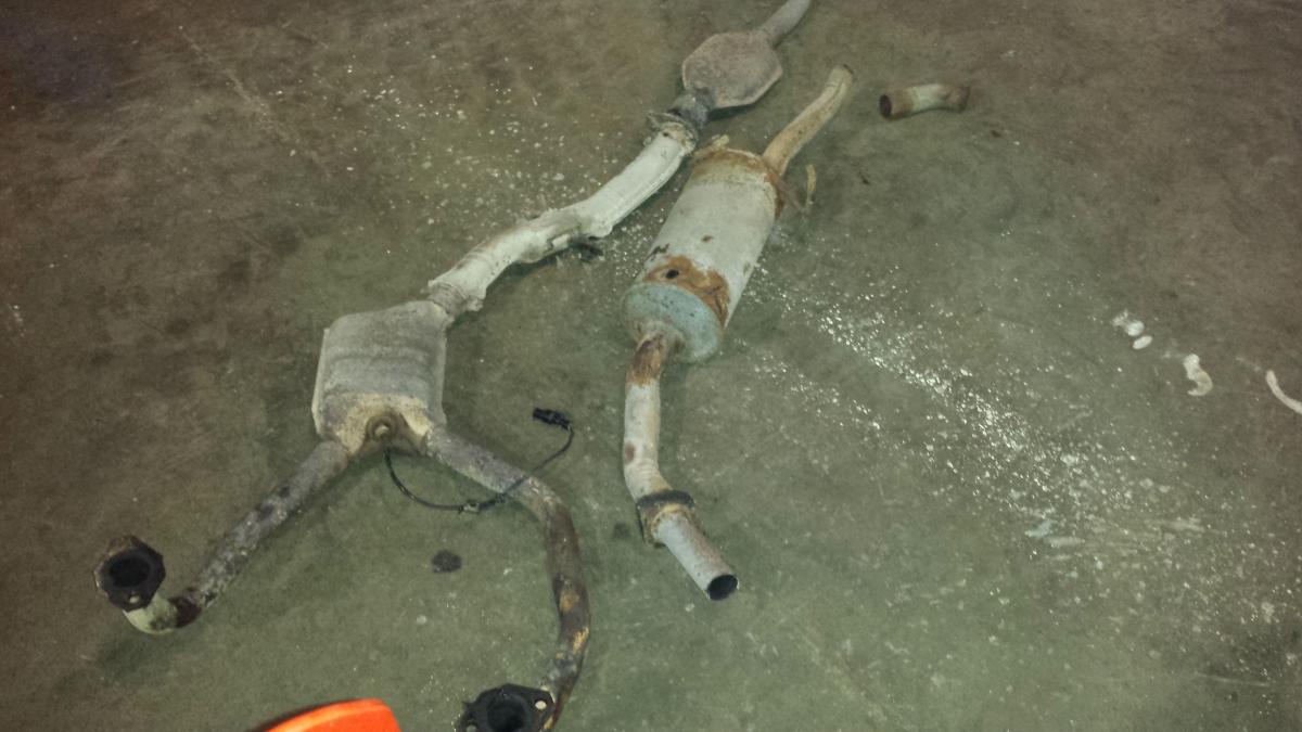

November 14, 201312 yr Author Forgot to mention 5speed with the awd push button Sowith all these adventures, i decide to go with an ej22 swap. Lots of guys out here have done it so..!! for the moment I have the motor, dash, exhaust removed. the exhaust -- the muffler all rusty and perforated! So for the moment I'm currently searching for a ej22. For the swap I'll buy an adapter plate and I have someone who will make my wiring! I'll also go with and xt6 pressure plate.

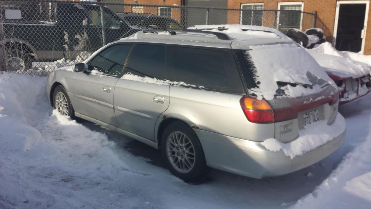

December 17, 201312 yr Author The project now starts! I bought a 2003 Subaru Legacy EJ25 ( in 3 months i didn't found any 2.2 with low mileage or if yes like 3000$...) That has 185000km but every gasket, seal is new, new timing belt, water pump, battery,.... the car is in good shape though. He rebuitlt it and the tranny broke up 2 months after.. so I get it for 1000$ and he tows it to my garage! Edited December 17, 201312 yr by AxL_Project

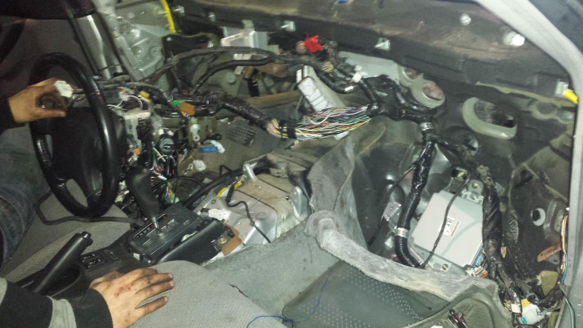

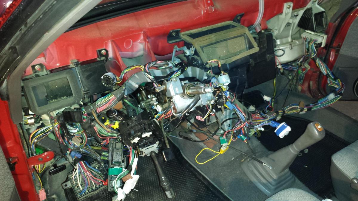

January 7, 201412 yr Author Got the motor and the wiring out of the subary Legacy. Gonna ship it and I'm waiting news for the adapter plate who's gonna arrive next Monday!! , so I have nothing to do with the Legacy for the moment! Maybe later I'll try to fit the keyless entry system with the electric door mecanism for the driver and passenger side! But for now I start working on the Loyale by changing the front axle and a little rust job on the front fenders! I was surprise when I realize that the ECU were under the passenger seat!! Makin a little fun on Christmas day!

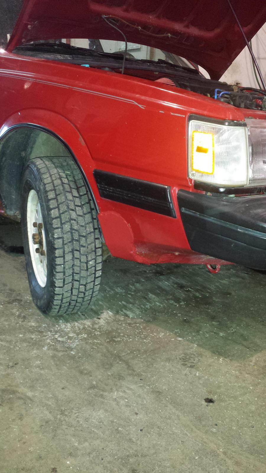

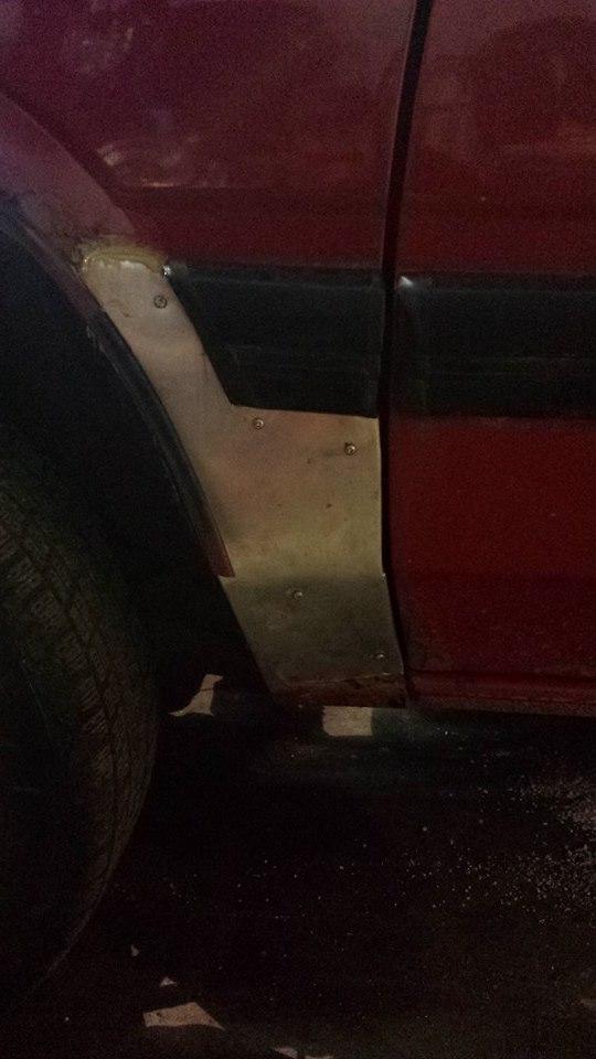

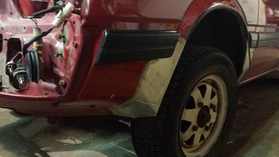

January 26, 201412 yr Author I did a little bodywork on the loyale. I trim a nice metal piece to do the front fenders and between the door and the wheel! I used to put wood glue on the metal sheet and screw it to the body ( my dad did that to his old truck and the result was great) when dry remove screw and did a bit of touch up. It is a temporary repair just to pass the government inspection, I should buy new fenders and front valence this summer!

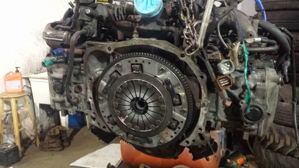

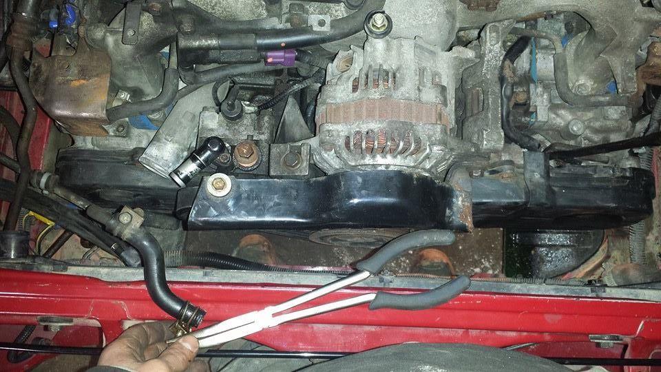

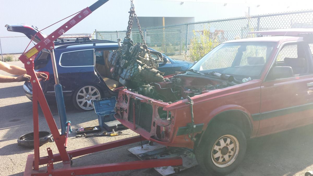

January 26, 201412 yr Author Finally put the engine in!! Put the new flywheel, xt6 clutch and pressure plate! The engine mounts were already screwed to the motor and in the position they are, we had to let them on the motor. So I raise the transmition with a jack, bolt up the engine and release everything slowly!! The engine mounts fits perfectly on the subframe ( I wasn't sure) Soon I should receive the wiring but by this time, I'll begin connect the motor with everything it needs! It is going well for the moment! Edited February 18, 201412 yr by AxL_Project

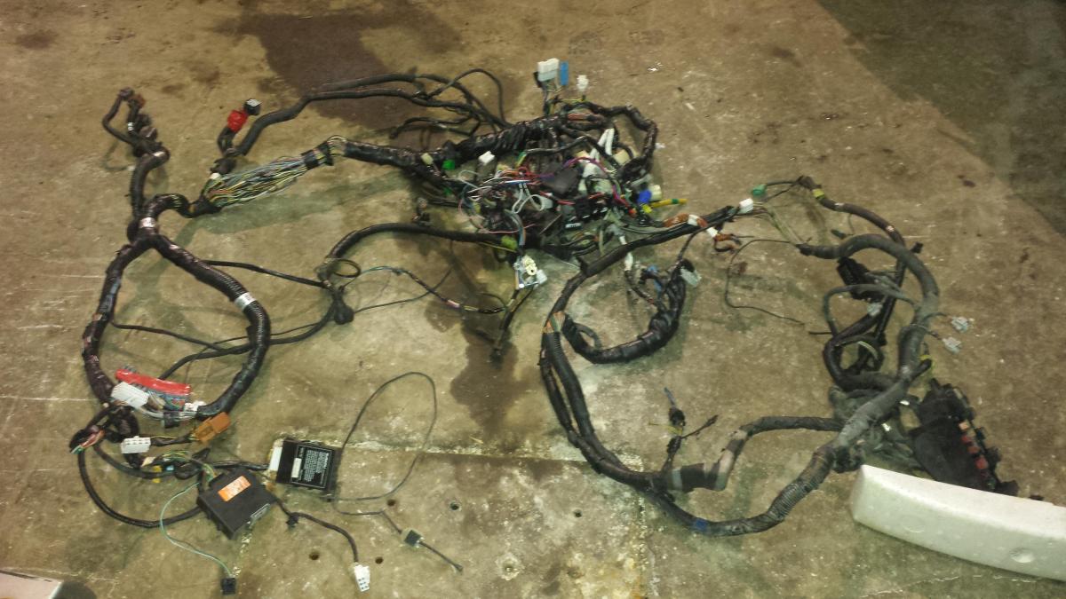

January 26, 201412 yr Author Almost all hoses are done except power steering and radiator. I decided to order a new one! I received my stripped harness it is gonna be the next step to install! I figure that it will be a pain! Edited February 13, 201412 yr by AxL_Project

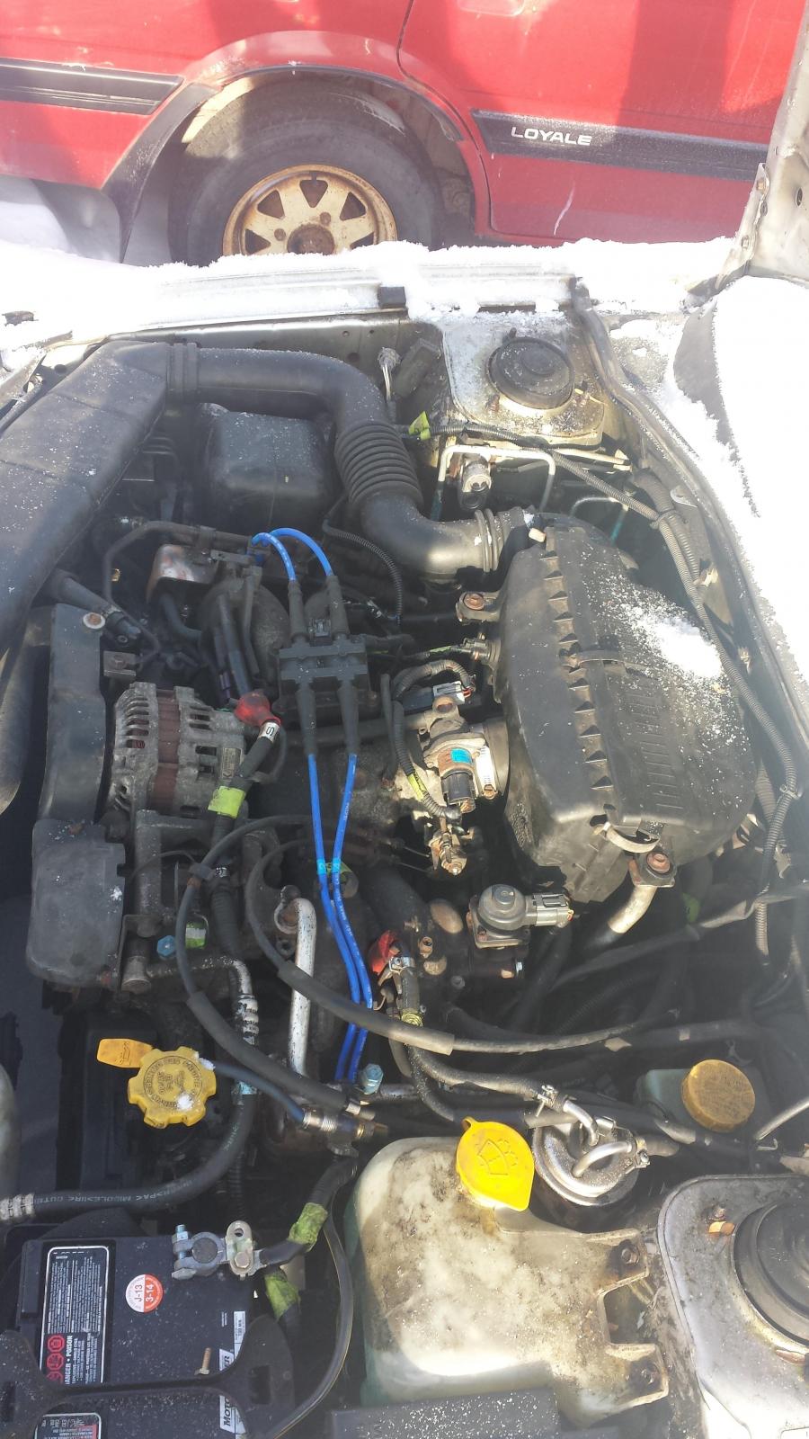

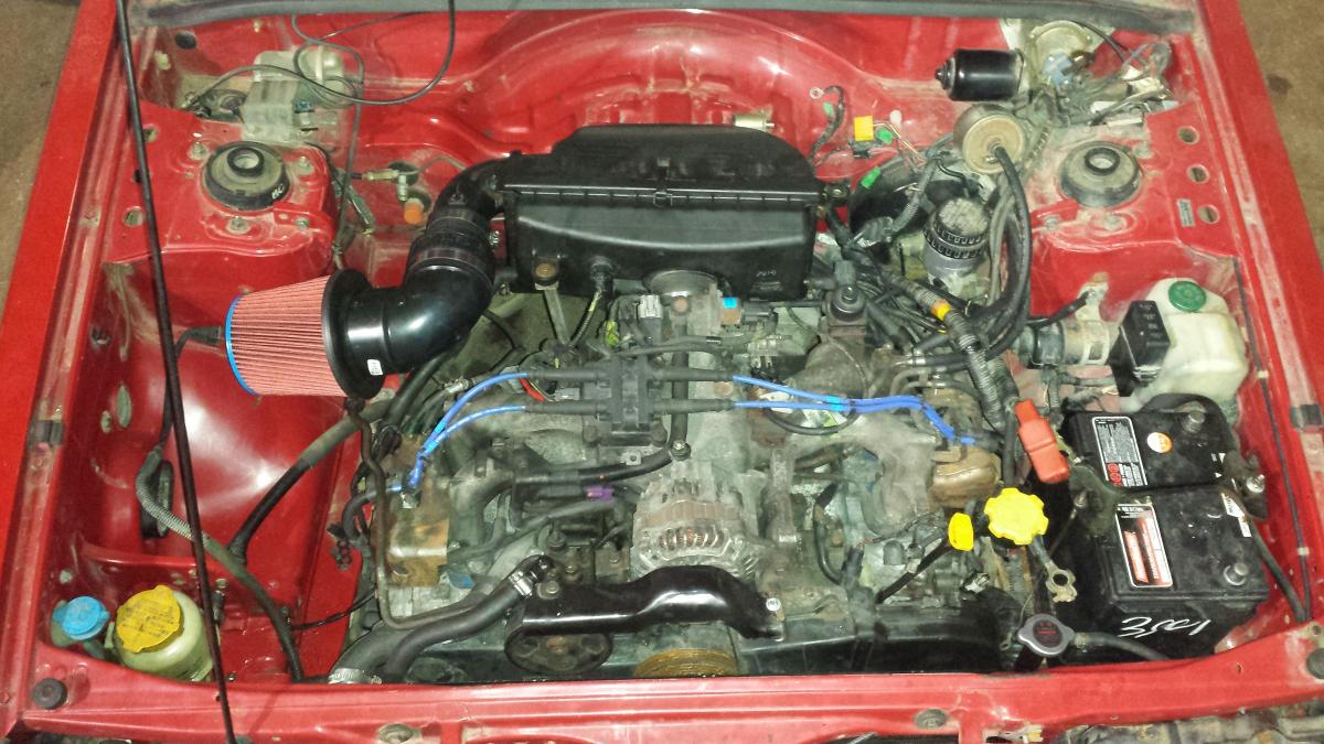

March 11, 201412 yr Author Yeah small issues but have to order the parts so it makes the project longer!! Did the oil pan without too much difficulty! (it was my fists one) The guy before put the gasket AND the red silicone... Now everything is plugged ( power steering, gas line, coolant line, ..) and put the new radiator in! The body is also almost done!! Pics coming soon!

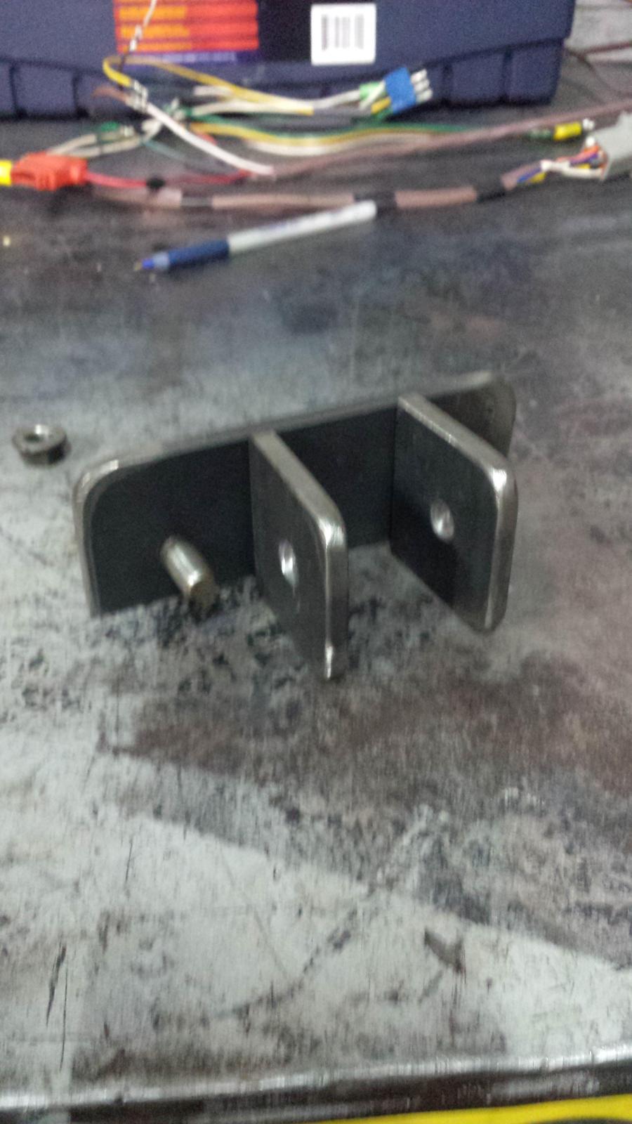

March 18, 201412 yr Author For temporary work, I find it a great job! Also complete the engine bay with the intake, It makes a clean job even if lots of unused wirings are free in the engine bay!! I did the pitchstopper too but my uncle did not have time to weld it for me for the moment! Someone on the forum trim my wiring to the engine but I can't understand how the f*** how I have to plug free wirings... the electrical part of a car is not mine..!! So on monday March 24, the Loyale is going to a Subaru performance mechanic who will finish the jobb!! It is gonne be platted soon after!!

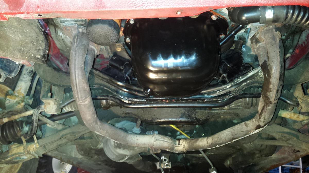

March 18, 201412 yr Author The exhaust for the Loyale makes me hesitate. My friend is suppose to make the 2.5 exhaust fits the Loyale. I tried it for fun and it fits perfectly for the middle-front of the car so only small modifications for the rear. But I was thinking about UEL headers. The front fits so it easy to install the rest, less work, but I think the UEL headers for a subaru worth it? let me know your opinion! Anyone did it on a EA to EJ swap (space restriction) ?!

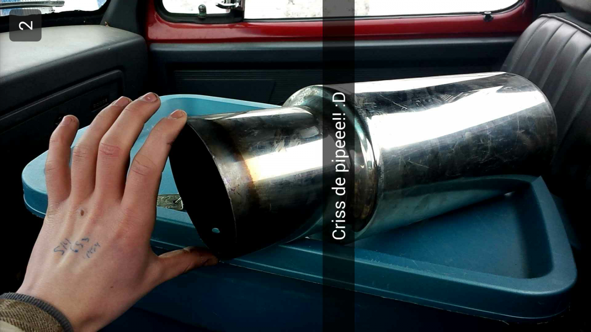

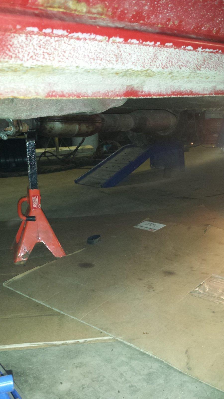

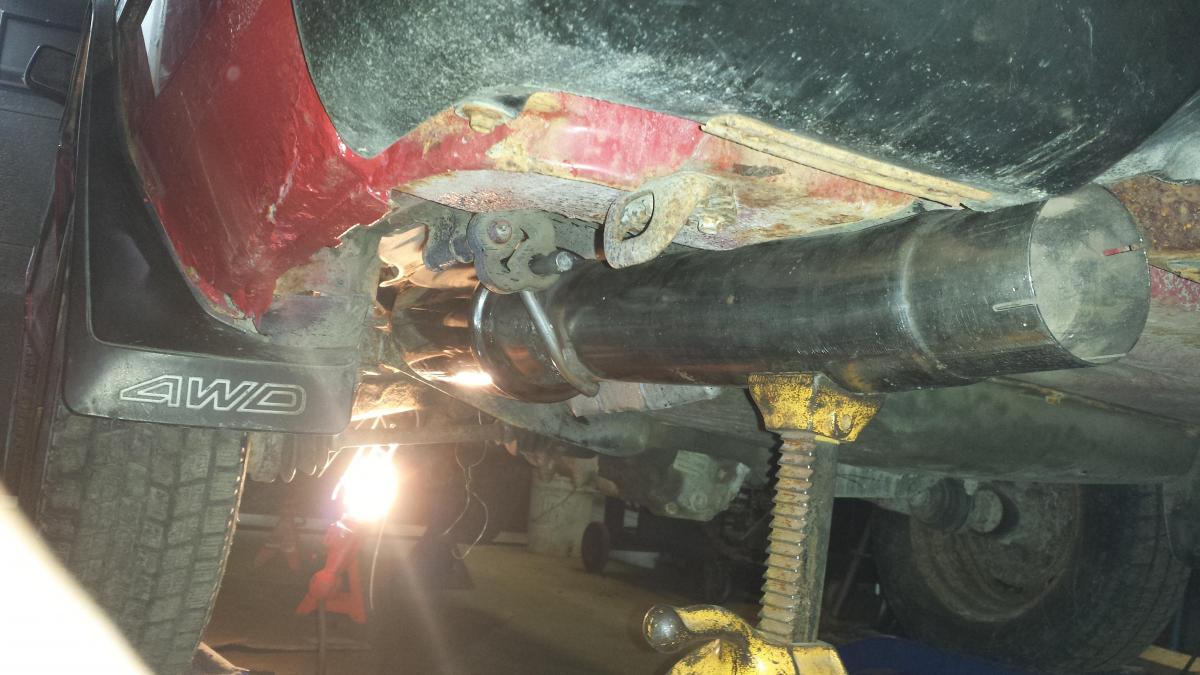

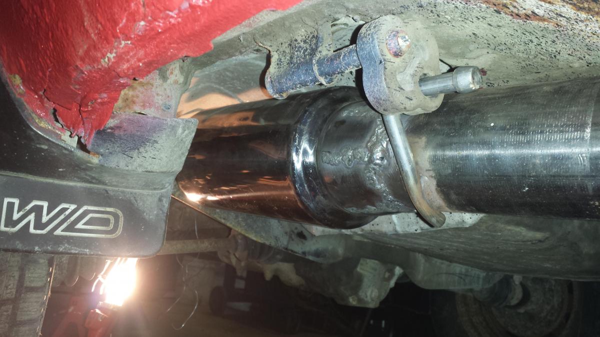

March 20, 201412 yr Author We installed the exhaust yesturday! The Legacy's muffler did not fit the loyale because it was WAYY too big and my Loyale one was perforated so I went to buy one! find a great deal on this exhaust. A little ricer but I knew it would be hiden behind wheel and it only cost me 20$ so I had no other choice than buy it! 2 1/2 inlet and 4 1/2 outlet but my friend did not have 4 1/2 inch pipe to finish the exhaust line so we reduce the outlet and put a 4 inch pipe from a dodge ram!! The sad thing: 1- No UEL headers for the moment 2- For an offroad car, I do not LIKE the idea that the exhaust line is under the floor level (I think the ea line were into the floor next to the 4wd shaft ) But the resonators are too big to put the line upper.. :/ we'll see in the futur if I ever remove those res!!
March 30, 201412 yr Author IT'S ALIVEEEE!!!!!! Only two things to do that the mechanic guy told me: -put chek valves on the fuel line because when it's a cold start, the pump has to send the fuel through the complete lines(Loyale had two but I removed them..) -Put my Loyale oil pressure sensor because it can read oil pressure and the legacy one is made to show up a light I can put the dash back this week and finish small things on ( paint wheels,...!!!)

March 31, 201412 yr Author I complete the dash installation but some work still have to be done : - hazard switch doesn't stay on - Lighter plug don't have electricity - Driver's side door sensor are not working( I'll chek grounds tomorrow) -Speedometer doesn't work I'll call back my electric mechanic tomorrow to see what he thinks Also the two chekvalves in the engine bay did not resolve the gas problem, I'll try with one near the gas tank tomorrow! That's it for today!

January 26, 201511 yr Author I'm currently driving it! LOTS of fun in the snow!!! So the ECU broke twice and it was finally the wiring on the alternator who were at the wrong place.. Ordered a new fuel pump cause mine was noisy and in cold days had difficulty to fill my motor! Put some fog lights on the front. Looks very nice and is by far helping for the night vision! Still 1 thing go wrong(to me): when the car is cold, the idle is at 1500 and hot 600rpm. But when cold, during my shifts, it goes up to 3000rpm... so it becomes a challenge to shift correctly.. So I drive to a stop sign and my engine goes 3000rpm for a few , I am completely stopped and a few seconds later it goes back to 1500rpm.. for a short distance to go from my house it becomes very unpleasant to drive.. do you have any idea? about the wiring or anything.. the idle control valve is OK we cheked it..
