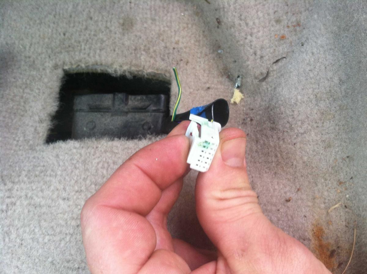

July 5, 201411 yr Author YES, FIXED no more flashing ACC light in the instrument display and no more power drainyou can see the corrosion Edited July 6, 201411 yr by blindrummer
July 6, 201411 yr Awesome!! Glad to hear that fixed it! Did you cut the hole in the carpet or was it there already?
July 6, 201411 yr Author That hole was there, looks like the heater ducting a place to emerge from under the carpet
July 6, 201411 yr Author In the link fairtax supplied, the technition mikeV explains it's an empty connector that would have something to do with tire pressure. This particular year was not equipped with that option. This empty connector is located in a prime spot for corrosion, it sits under a heating duct on the floor, if anything is spilled on the front corner of the drivers seat it's going to find this open connector

January 25, 201610 yr Thank heavens for this post. I recently went for a camping trip and my Camelbak leaked a bunch of water underneath my drivers seat. I used a ShopVac to take out most of the moisture, but I still have the ERR and ACC flashing - even when my car is parked and locked with the keys out of the ignition. It's slowly killing my battery and I'd rather fix this than keep replacing a battery... I've read up on this post and I see that I need to do something with that useless tire pressure connector, but I'm not sure what. I feel weird just cutting it off... Any help is appreciated. I know I'm a bit late to jump into this thread...
January 25, 201610 yr Mikayla, you only need to cut one wire, then wrap some black electrical tape on the ends of the wire to prevent it from touching anything.
March 13, 201610 yr Hello I do see the one single image in a post above, but can anyone actually post three or four photos explaining precisely where to get at this (without removing the seat)? It has been indicated that sliding the seat all the way forward should make this possible, but I'm unclear on exactly where to look, and the image above appears to indicate a very small location, but doesn't give a bigger picture to help orient where exactly to go hunting. Thank you! Edited March 14, 201610 yr by RedMtl
March 14, 201610 yr Yes, slide the seat forward, then feel for the cutout in the corner of the carpet. It should be fairly evident once you look under there.
