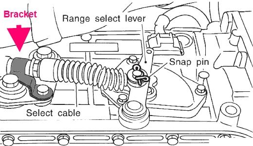

September 15, 201411 yr Author The cable inside the boot appears to be disconnected where it plugs intothe bracket (as per the diagram attached to this post). I haven'topened the boot yet but I'd sincerely appreciate thoughts as to myoptions.

September 16, 201411 yr Author I have had a bracket break on me, but not a cable. When I did remove the cable, it was pretty worn. This does happen from time to time, but it is rare. It is possible that it's the bracket that has broken and the cable itself is fine? I'll soon find out, but to be fair this is a 97 OBW with over 250k miles on it so it might just be possible.
September 16, 201411 yr I would bet it is as simple as a bad cable. The cable does have a boot on it, but when that rubber boot failes, salt and stuff gets into the cable and snap.
