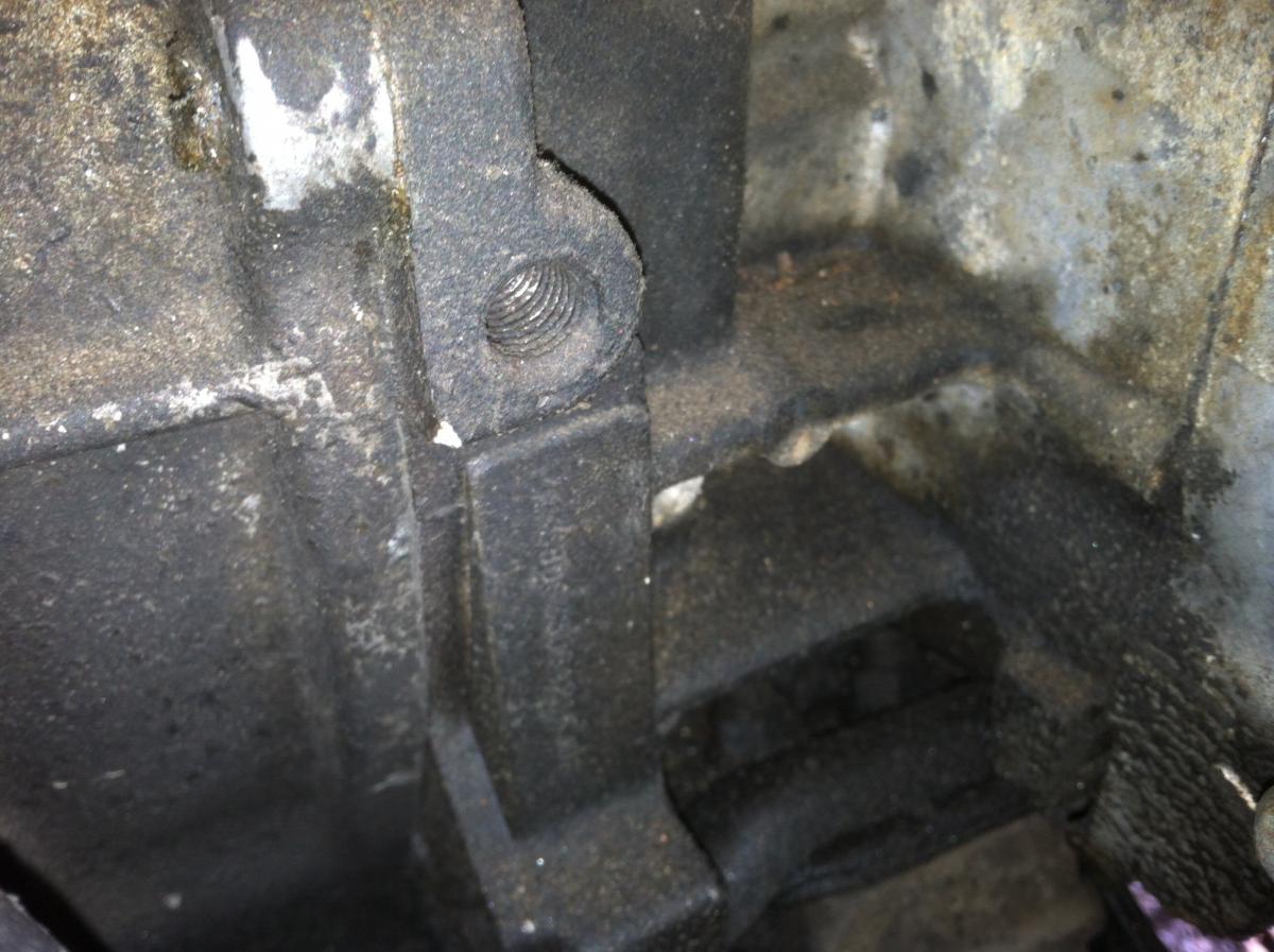

January 2, 201511 yr Look closer for the VIN. Its small and often covered in dirt/grime. The VIN is engraved/stamped on the flat on the lower vertical corner of the bellhousing. Right side.
January 2, 201511 yr Pic of the flat where the vin is stamped. Edited January 2, 201511 yr by Fairtax4me

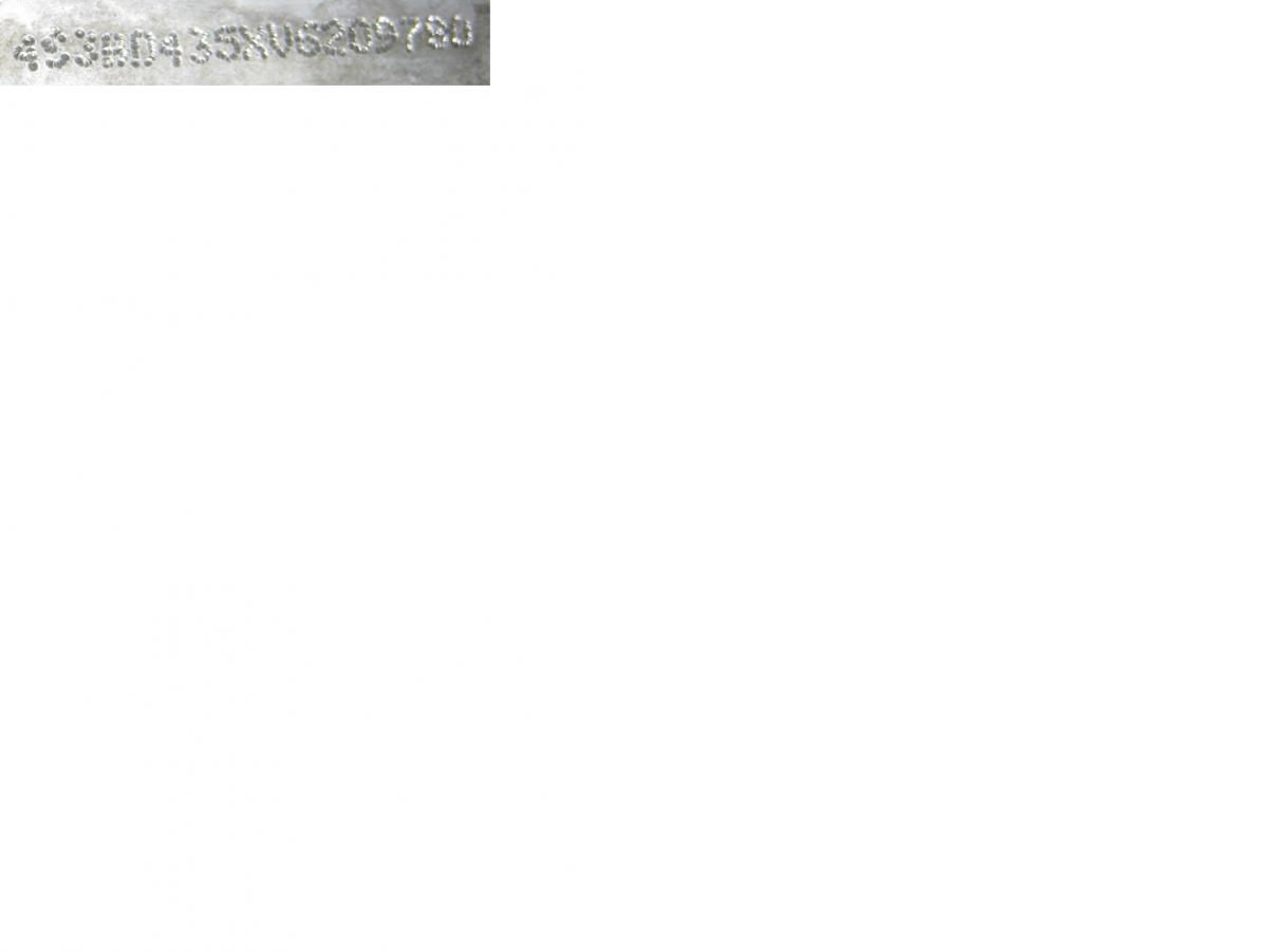

January 2, 201511 yr Author ...I really appreciate all the helpful info. And, yes you were correct - I cleaned off the oxidation/grime and there was a serial number 4S3BD435XV6209780 is my best guess (see attached pic). I checked with the local Subaru dealer who could not provide any info on the engine based on the number. Any suggestions on where I might learn more based on the SN? Thanks Edited January 2, 201511 yr by subx
January 2, 201511 yr The heads are single port with solid lash adjusters so I should assume an interference engine.... yes, interference engine. 4S3BD435XV6209780 this is the vin, the V indicates it is a 97. run a carfax on the vin and learn what you can. Edited January 2, 201511 yr by johnceggleston
