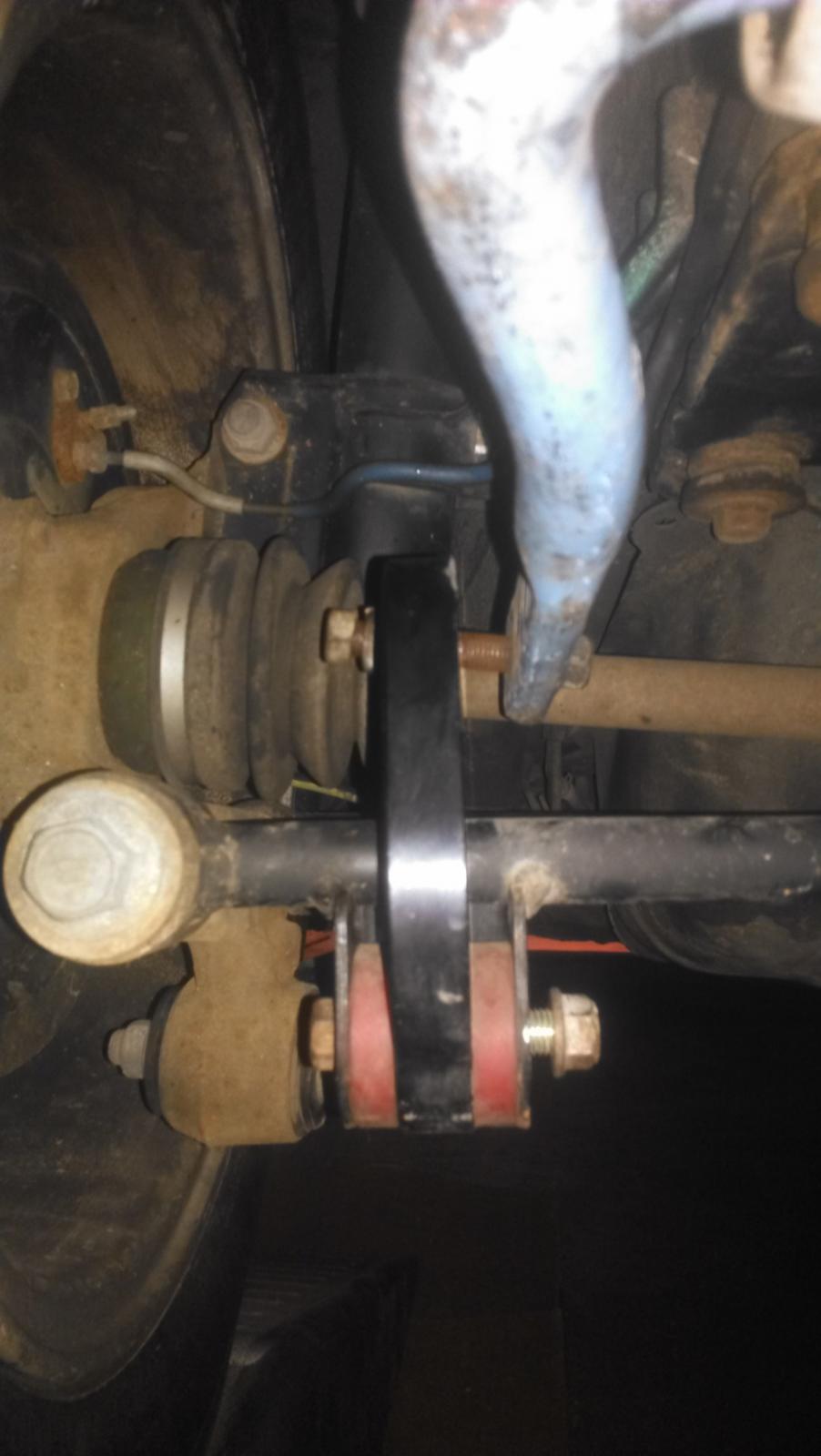

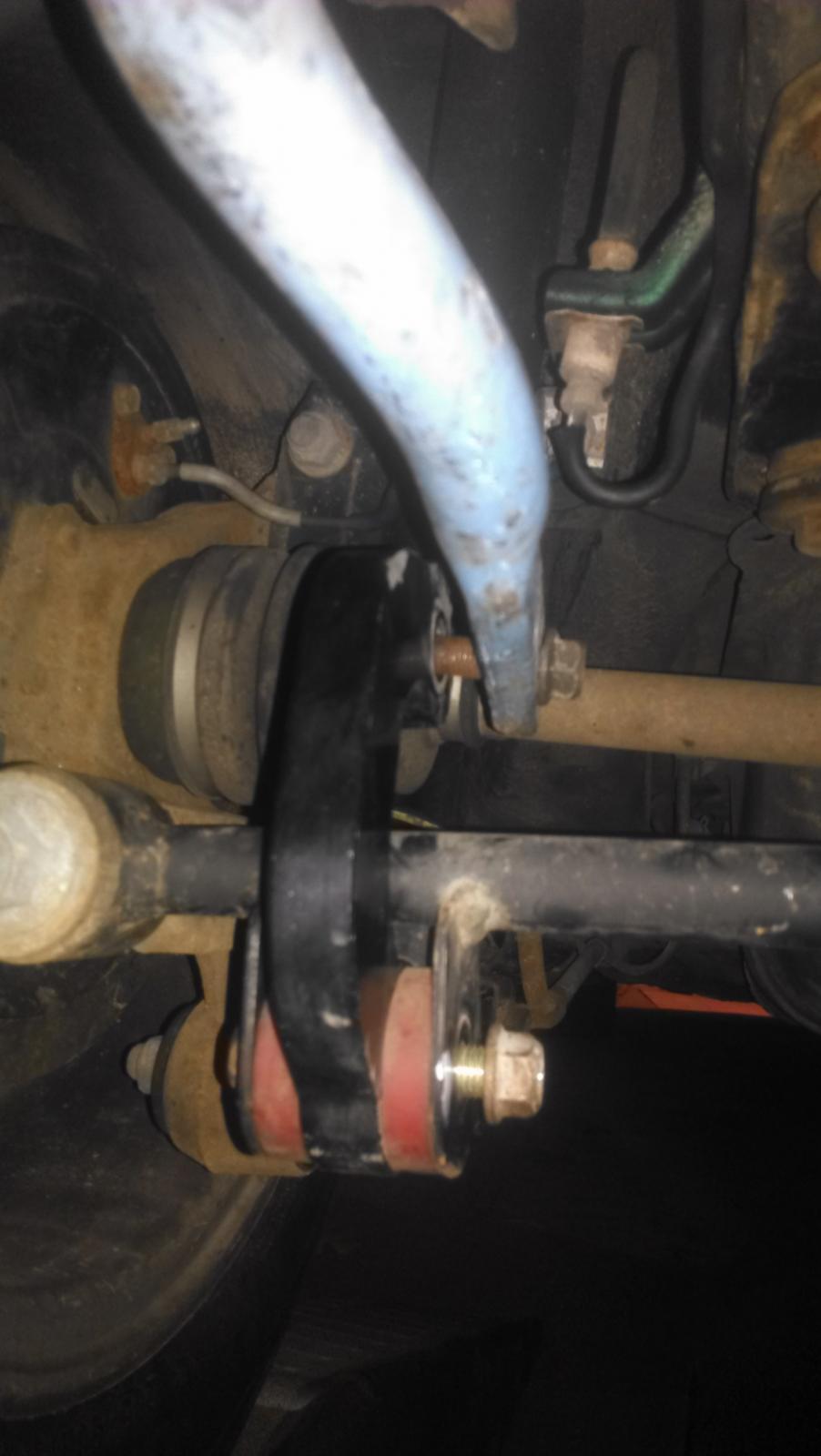

So Im upgrading my front and rear sway bars. 22mm. Also upgrading to Perrin rear endlinks. I have the rear bar and endlinks in place but there is a size-able gap between the top of the endlink and the sway bar. The slack is only on one side, cause the other side is flush. Do I need bushings on the top also? IIRC Perrin told me that they were only required on the bottom. Here are some pics.

Ok pics didnt load. Ill try again.post-50789-0-85037200-1420330939_thumb.jpgpost-50789-0-81432800-1420330958_thumb.jpgpost-50789-0-45663100-1420330977_thumb.jpgpost-50789-0-58411900-1420330997_thumb.jpg
Swaybar needs to be recentered on the vehicle.  Perrin includes special spacers for their sway bar end links that are designed to take up the space but not interfere with the heim joint movement.  I would suggest a call to them and see if you can purchase the set of spacers.  I have them on my car and they work exceptionally well.
