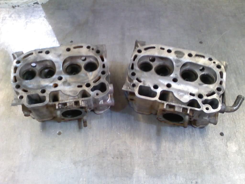

The heads on my car a cracked on both pair.  They have been repaired before.  I'm looking for alternatives to this problem.

1) My heads are Gen 2 EA82 - If I can locate, are the gen 3 heads any better and why if so?
2) I saw mods done to EA82 heads some time ago, claiming water passage around exhaust is restricted?  He made changes (plus bigger valves abd port and polish) but don't know if they worked?  Can anyone throw any light on that?

Your best and easiest bet, is to find a set of Gen 3 EA82 heads. Those have thicker casting on the weaker areas.
