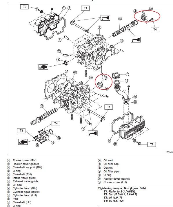

Check the back side of the passenger head. There is a cam shaft retainer cap thingy that has to bolts holding it on. Inside that cap is a a large o-ring. That will get cracked and leak a lot of times and it will drip on your exhaust.

definitely check that cam shaft retainer cap.
