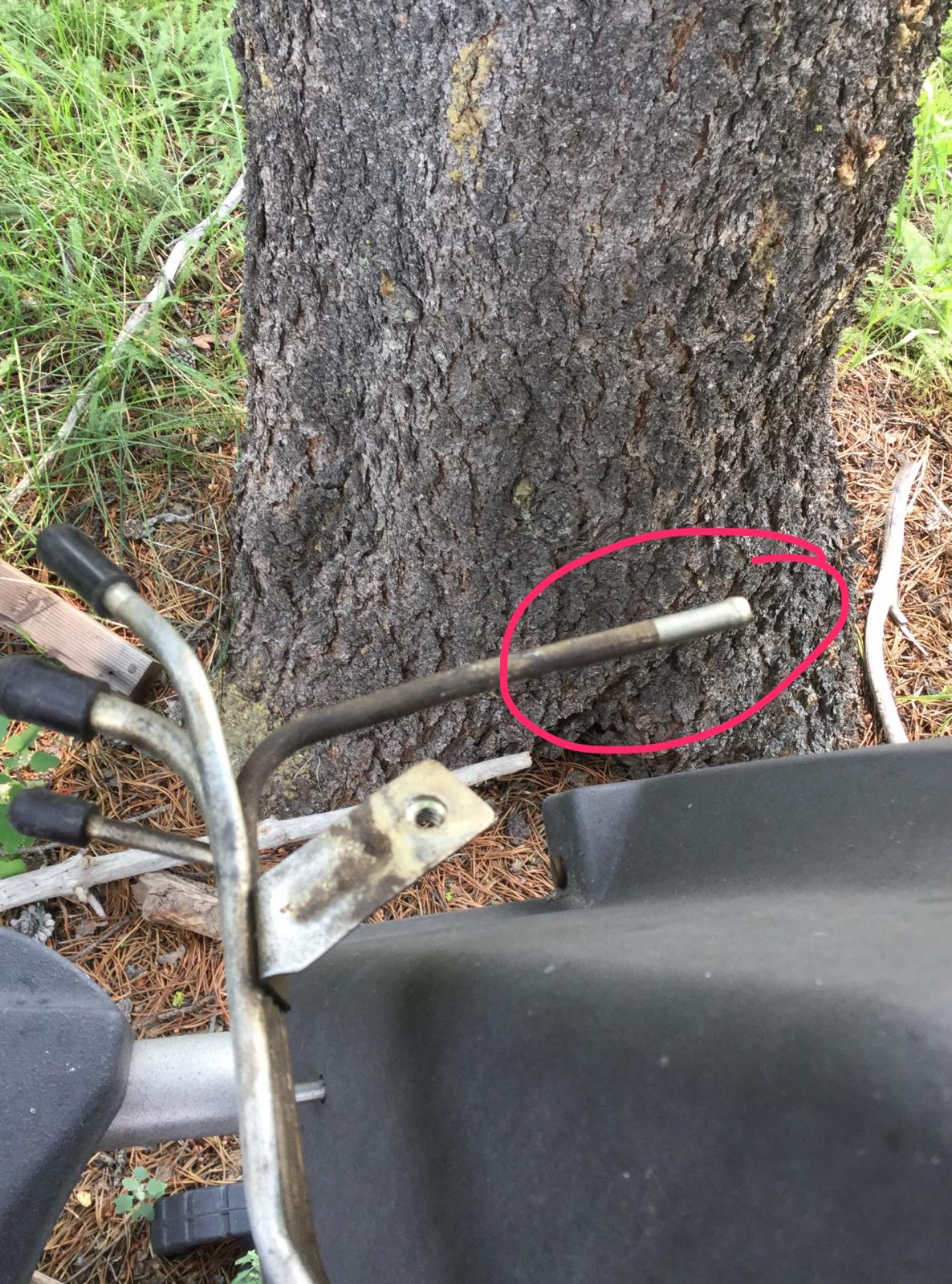

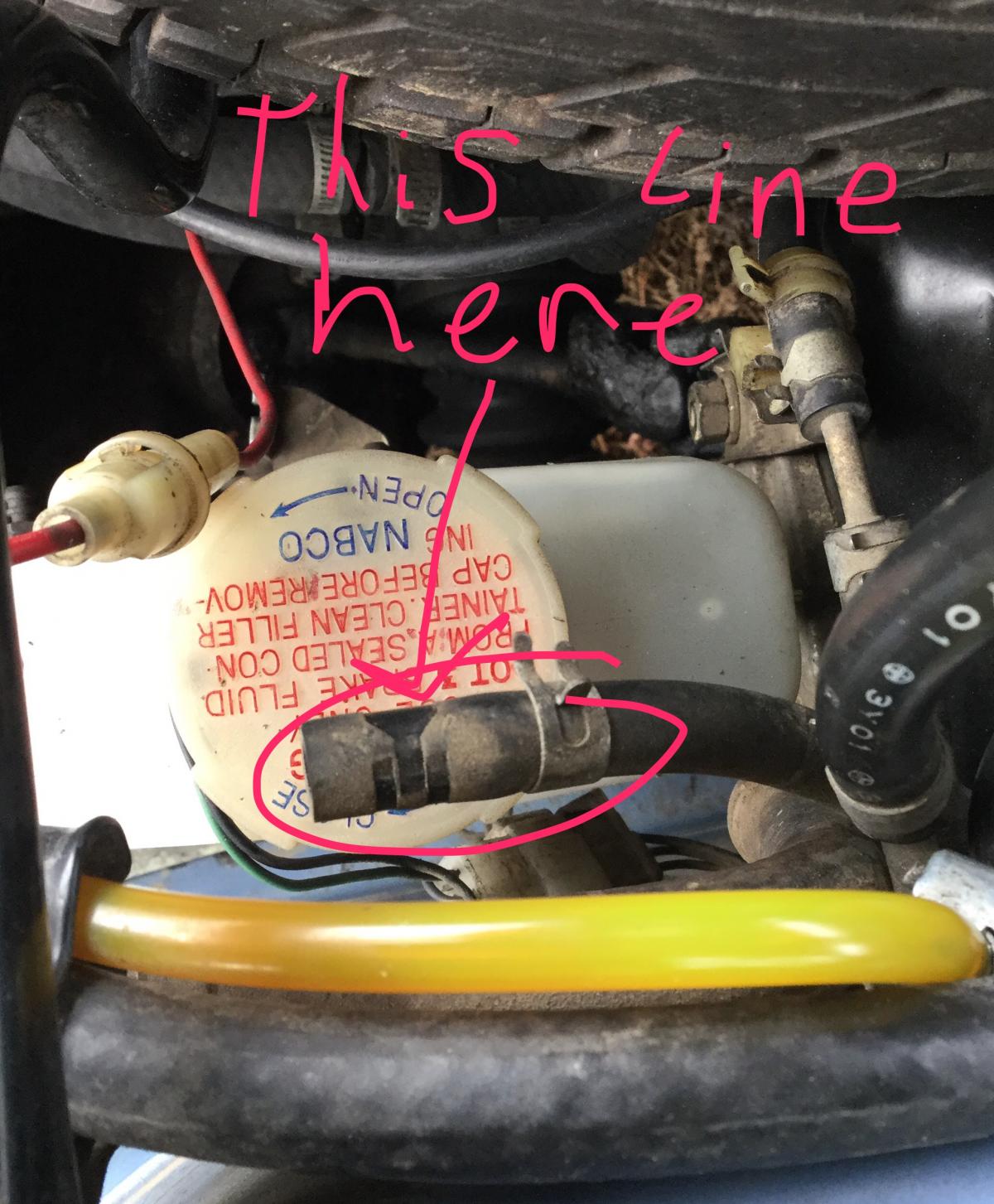

I was gonna rip out my evap canister today because when I did my weber conversion originally I just capped all the ends due to being in a hurry. Today I realized that the fourth little tube goes down and into my firewall. Is this some kind of gas tank vent? I just want to make sure there's no harm if I remove my canister and cap this little line. post-54976-0-99722600-1501964857_thumb.jpgpost-54976-0-15651600-1501964906_thumb.jpg
If it's a tank vent don't cap it unless you are running a vented gas cap.
GD
Can I just leave it uncapped / an open line then? Or do I have to run it into my charcoal canister?
