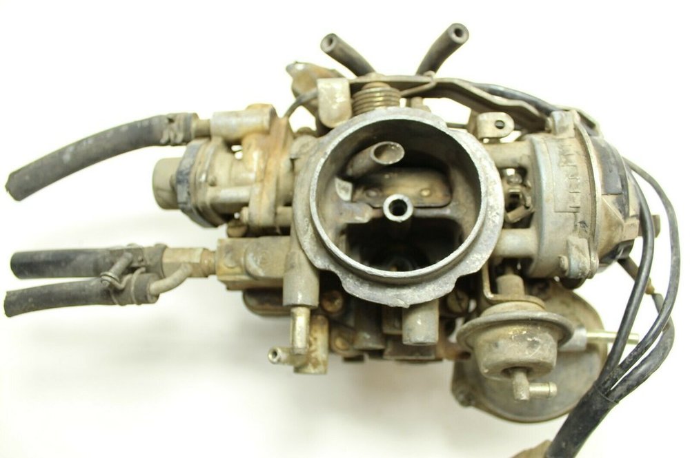

The stock pump is 1.35-2.06 psi.Certainly not more than the Weber likes.
You will be hard pressed to get higher mileage w/an average drive  <2 miles.
New cap and rotor is almost always good for at least a slight improvement.
If it does not stall,overfilling is quite unlikely.You can add a fuel return by swapping the Y fitting from the inlet of the old carb.
