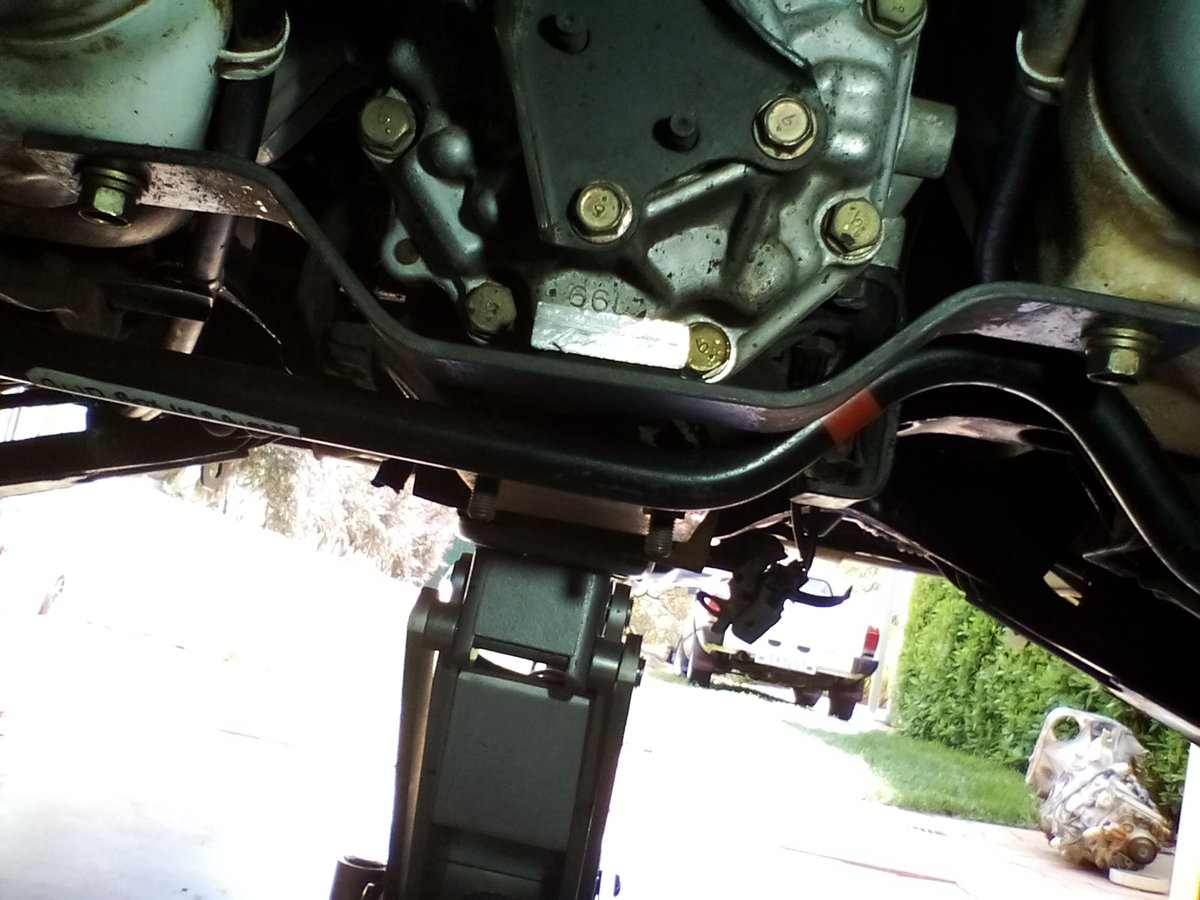

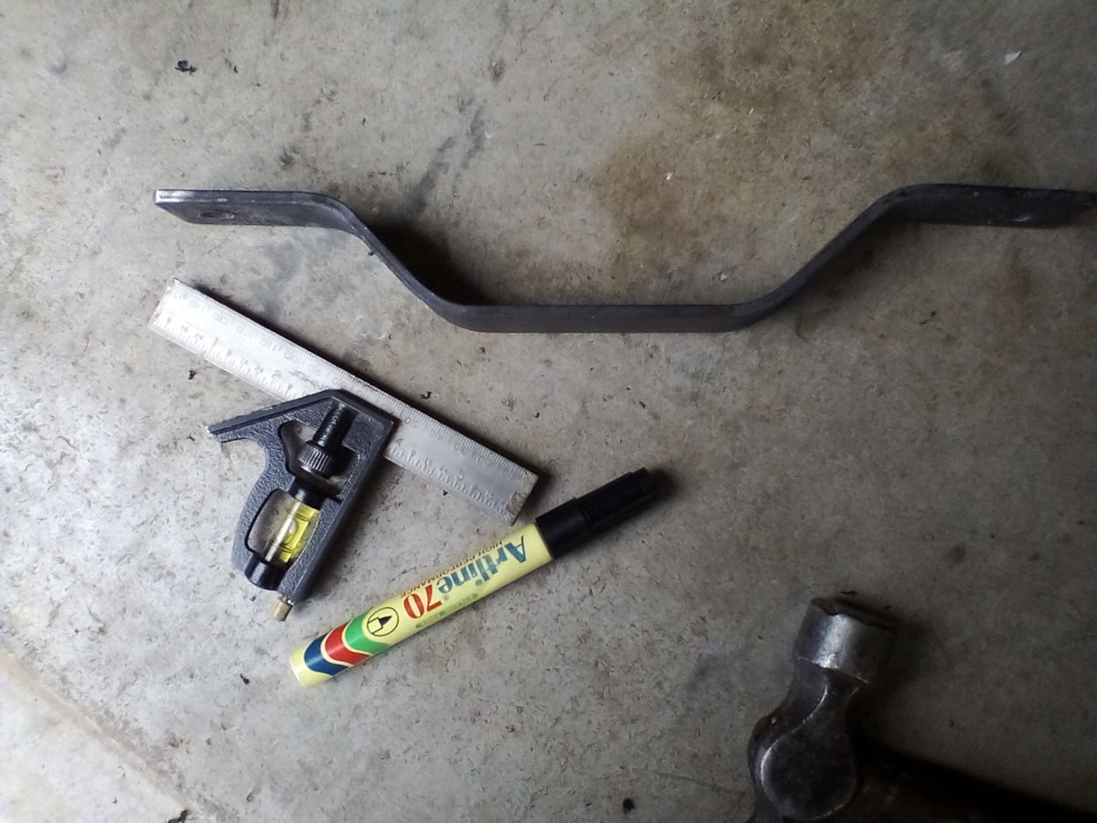

October 13, 20196 yr Any harm in starting another thread for EJ stuff in EA81? If anyone finds good threads for an EJ AWD box in EA81 bodies please don't hesitate to add links I have seen some photos of some impressive work, just some build instructions would help Here is my start Flat bar mild steel 5 mm X 40 mm wide Centre to centre for the automatic transmission mounting captive nuts rearward of sway bar line ~280 mm I started with more flat bar than need so I could trim to size once cold bent in vice. Bent with BFH. Once things bent, marked out the ~280 mm hole centres, then marked out 20 mm from these centre punch marks for cut mark. Fitted up, 25 mm might just be bit better Marked centre line, then 50 mm each side, so 100 mm apart I used these marks to set in vice to bend from there to 45° using combination square and bar set up on flat bench as I went -easy. All four bends are the simpler 45° This one set out and ended up surprisingly to be a total height of 45 mm Plenty of clearance of gearbox and sway bar. Same for an exhaust pipe. M10 1.25 bolts for the captive nuts in the body, drilled holes in this 11 mm Edited October 13, 20196 yr by Steptoe
