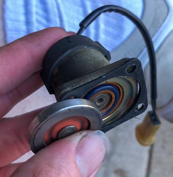

Okay, so after sifting through more of the wiring harness and using a 9v signal meter I now have power everywhere up until the coasting shut off solenoids. (Which the ecm says). Now I need to either rebuild them or get lucky and find one. I have no idea how to rebuild nor if it’s possible. I’ll do more research. I wish I could get rid of the emissions completely.

I thought this was the coasting shut off components but looking at my Haynes I’m not sure. There’s two, they sit right behind/underneath the air cleaner. Black/white and yellow/red wires. Fuse diagram says it’s connected to ignition and is always hot.

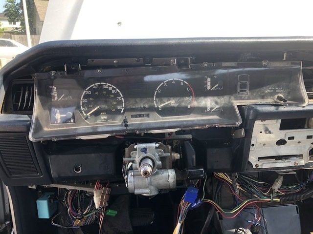

Okay. So I’ve learned a lot about cars and this Subaru over the last few months lol. I found the short to Ground and fixed it. The car runs.
Stupid issue: I can’t for the life of me get the instrument cluster back in to where the visor can get in place. It also doesn’t sit right.
Any help would be so appreciated!

thanks everyone, got the dash and interior back in.
