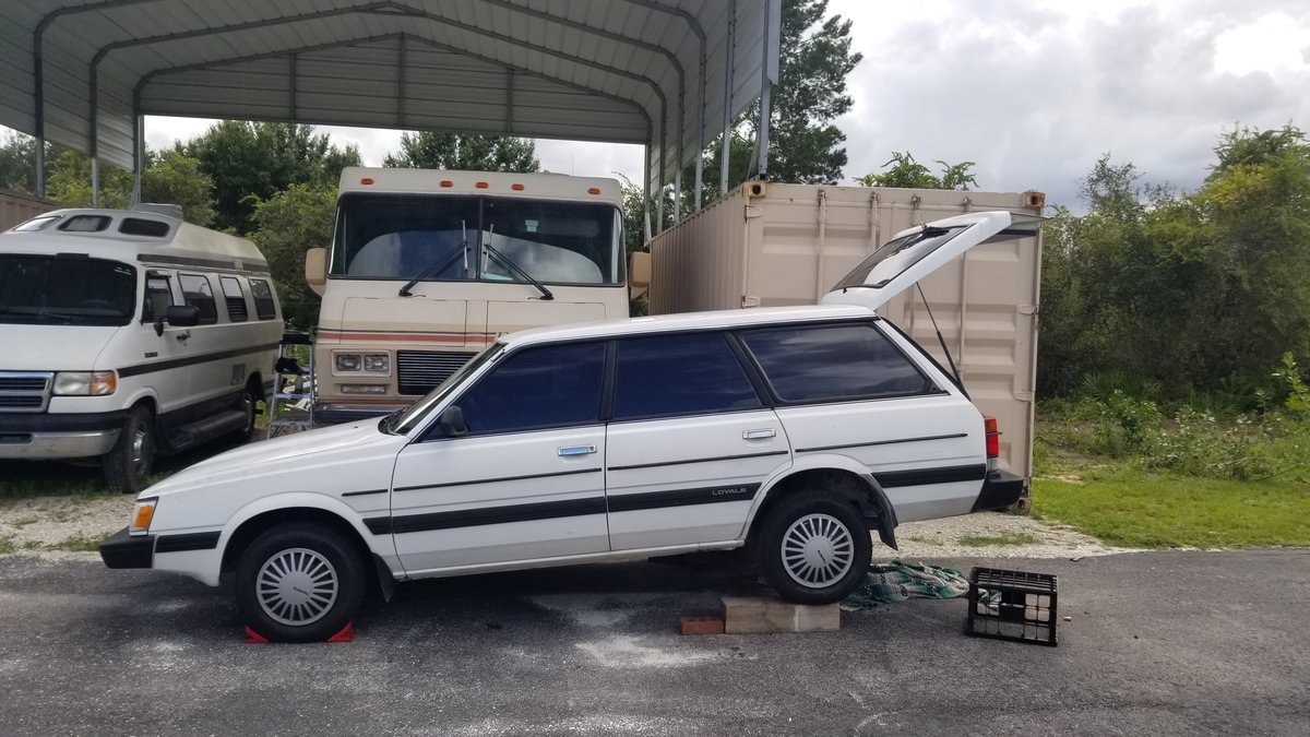

I backed it up on some 6x6 to get enough room.

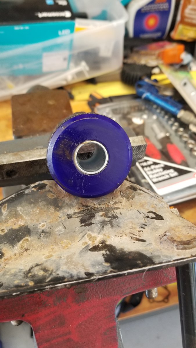

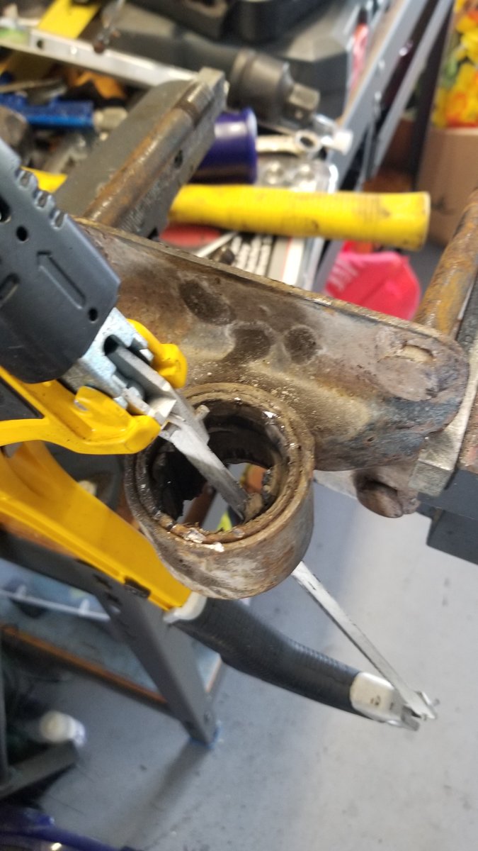

I couldn't press the old outer because I lacked the correct die. So I ended up cutting a slice out with a hacksaw.

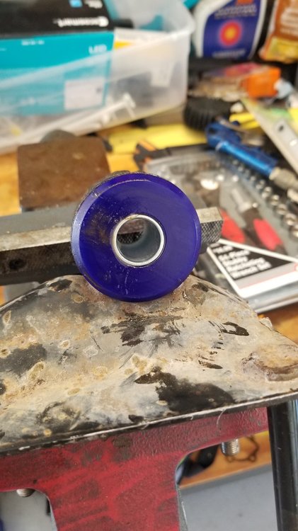

I used a bolt and some washers to press the new one in.
So I took it for a test drive, and it was so smooth going into 4WD I though it wasn't working. Push the button and let off the throttle at any speed and you can't feel a thing. Same goes for disengaging.

Nice work. Interesting to see you use the Australian idea of milk crate !
Saves you from pulling the axles and drive shaft. Just set the diff down on the crate. Makes it a sub 1 hour job.
