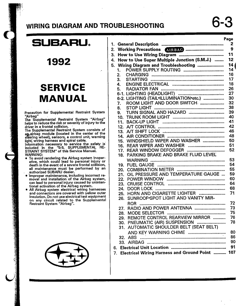

Some how my seat belt module got wet. Can't find any for Loyales, found one for a Legacy with the same connector for the switches, but the motor connector is different. Should be easy to adapter that has its just power, ground and the 4 motor wires. Hoping everything swaps over, but I cant seem to find a FSM for legacys with auto belts. I found one but it stops before the page with the diagram. Any chance someone has it? I need pages 80 and 81 from this book. I have the Loyale and XT books with the diagrams.
