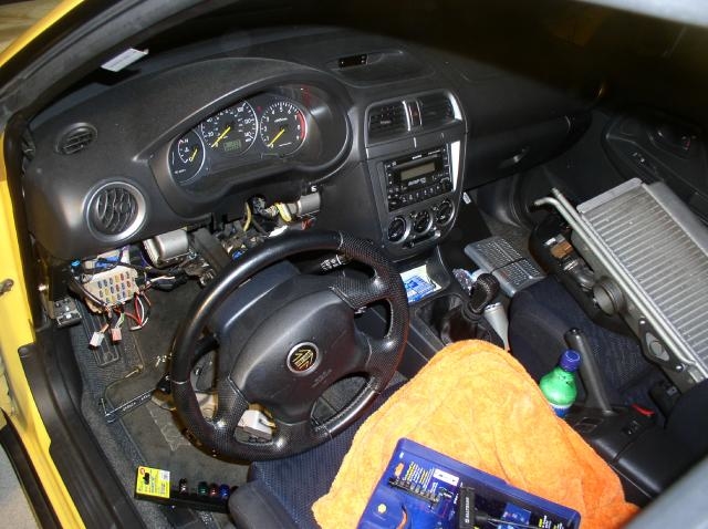

not sure on legacies, but on my imprezas, the ujoint bolts are reachable in the engine bay.  if you unhook the steering column from the inside and let the wheel rest on the front seat.  there's enough play to unhook the ujoint and flip the wheel around.  do it with the battery unplugged because airbags
