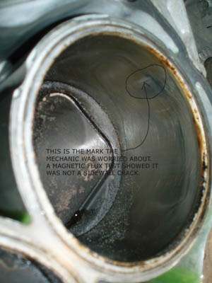

so yeah. the heads will get machined next week. new gaskets. new head bolts. all looks well with the cylinderwall according to the authorities having jurisdiction...

ok. so i finally got my beloved car back. 1400.00 in work. new headgaskets, new plugs. machined the heads flat. valves were checked and determined to be ok. they were adjusted. block was determined to be ok. seems to be running great since the work was done. much smoother. hit the highway last night some. hope my troubles are over for a long long time.
