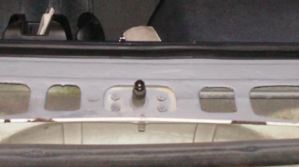

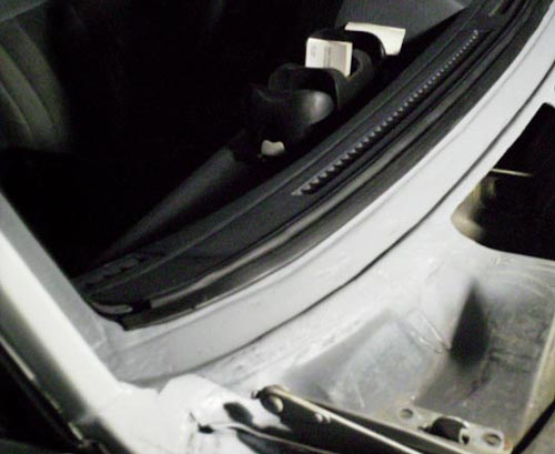

December 17, 200619 yr well, took several weekends, and a few gallons of kerosene to keep it warm enough to work & paint, but the rust repair around the windshield area of Hildy is pretty much complete. It isnt a perfect job by any means, but it will do nicely. cant wait to get the new glass installed to get a look at what she looked like when I started, see http://www.ultimatesubaru.org/forum/showthread.php?t=67677 here is what it looks like now ...
December 17, 200619 yr Author yeah, not too shabby for a rush job in the dead of winter by a FEMALE!! LOL :cool: seriously, if you look closly you can see bumps and shallow spots. made most of the repairs with fiberglass, in the interest of saving time. Did have to cut out the worst spot on the passenger side and weld in a patch, then fiberglassed the rest. had the weather been more cooperative i could have done a bit better job...will still probably out last the rest of the car!
December 17, 200619 yr Phizinza - wish I knew somebody that could do it for me, would get done a whole lot quicker!! but since money is more of an issue than time...well guess i will have to do it myself. besides, i like having the satisfaction of doing stuff like this myself. :cool: I agree with you on this one. I like saying what I've done with the car. Guess I'm just a bit of a show off, haha. Looks great so far. You'll barely see any of that when the glass is in and the plastics are back on. I like it when old Subarus get brought back to life

December 18, 200619 yr Author You dont wanna do that Connie, I might have to keep him a loooonnnnnggggg time to fix all that!! not that hard to do really. made a couple of attempts at welding in some of the holes, but the metal was so thin it just burned right thru even on the lowest setting, so out came the fiberglass. no, it wont last forever, but neither will the car. should last long enough tho.
