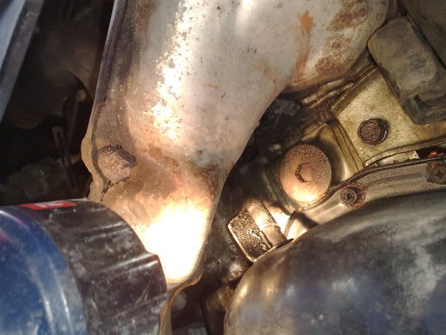

Here are pics of where the leak LOOKS to be coming from.
See right where the bolt is? There is water dripping from there with the motor running. Didn't take the pic at the exact time it started dripping.
