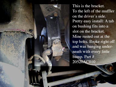

January 23, 200422 yr Be sure that it really is a shock/strut. I was getting a similar clunk/bang on the driver's side rear when hitting bumps...thought it was shocks. I was all ready to pay $300-$400 for new shocks/struts. Mechanic did the simple check .... push down on the rear bumper: does it bounce up and down? or just return to its normal position. It returned and stopped...not the shocks. Looking underneath, it turned out to be a broken stabilizer bracket banging underneath the car. It had rusted out and broken right at the bolts. $15 DIY job. Might be worth a peek.
January 23, 200422 yr Author Hawksoob, About where is this bracket located? What does it look like? I have a Haynes Manual, will this help me? much thanks for the heads up. I was expecting about 300-400 for getting one side fixed also. Tdog

January 23, 200422 yr Originally posted by tracedog67 Hawksoob, About where is this bracket located? What does it look like? I have a Haynes Manual, will this help me? much thanks for the heads up. I was expecting about 300-400 for getting one side fixed also. Tdog Haynes is worthless for this. Shows nothing. Under the left fender, near the muffler. Stabilizer bar connects to it. It's sort of a U shape. Part number 20520AC010 Here's a pic: Adendum to the text on the image: After the insert tab A into Slot B reference, of course, there are 3 bolts to deal with. One on the non-tabbed part of the bushing, 2 on the part that goes flush to the body. I hope that helps.
