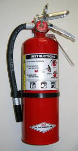

Yeah, that is the one I have my eye on too .... I'm going to look into getting an old fire extinguisher (the medium size ones that have the hose like this one FireExtinguisherABC.jpg) that is the type that uses baking soda, find out how much pressure it needs to run, and use a dryer /regulator to keep the pressure right and I should be set : )

SCORE!! I'm heading to the shop of a guy that refills fire extinguishers for a living and he is going to GIVE me a suitable steel tanked extinguisher (I'll see if he can let me have 2-3 so I have some to experiment on). :banana:

Here's my new free extinguishers to play with! zzz
And here's a pic of the max tested pressure rating. (top right of label says 525 PSI tested max pressure, the smaller one is rated 585 PSI)
And I tried to get more of the label but it was just too fine, it says on both that it has a working charged pressure of 175 PSI, so my 130 PSI air compressor isn't ever going to be able to over-pressurize it. :Flame:
The guy I got them from suggested I try pressurizing through the pressure gauge, and I tried that with my rubber cone tipped air gun, and it worked great! I just had to prime it by opening the top and letting a little water come through.
Annother note, any fire extinguisher will work, no matter if it is designed for dry chem, water or CO2 (the CO2 ones are the highest pressure and are ideal for an emergency air tank for flats, just charge it, and leave it in the spare tire area ready to be used when needed.) just make sure it's in reasonably good condition, and use your common sense and be safe. ;)
I use safety goggles and I made sure I got what was left of the dry chem after he emptied it with water. Most ABC fire extinguishers will have amonium nitrate based powder, so don't get that in your eyes. I plan on finding some kind of a connector to fit the guage hole, and I am going to check the local United Grocer's warehouse for bulk baking soda (or calicium bicarbonate as it's technicly called) and I am set! :banana:

My project is complete with just $4 of pipe fittings, now just need to find a cheap source of baking soda. I can get it for $ 0.77 per lb. from HF, but I don't want to buy a 50lb. bag. or spend $35 but it might end up being the best deal.

Not to worry, he hydro tests them the only reason these tanks are not in service is their age and the extra stringent requirements for keeping them in service as a fire extinguisher. :burnout:
I am also purposefully not running them even at their designed service pressure to keep an extra safety margin. :)
Anyhow, I got a pic of the set-up and of me blasting water out of one w00t! :Flame:(cleaning them out before I get the soda)
And here is a pic of what parts needed to hook-up the air fittings:
What you see is a 1/8" pipe nipple (same size as the gauge removed) a 1/8" to 1/4" pipe bell reducer, and a the male air fitting. Cost me just under $4. :banana:

Hehe ya, official work boots for 90 DEG. weather :grin:. I have cleaned out all the ABC powder, so no real danger of getting it in the face anymore. The blast of water isn't too harsh, and once I was sure of no leaks, I relaxed my safety measures. I have set the regulator for 90 PSI, so I am well below the rated pressure, I just need to experiment now with the soda. :clap:
If you look around in your area, there is bound to be someone who services fire extinguishers and might give you a similar deal. He has a lot of people who get the old tanks from him and make things like blow torch heads to attach to the sides of buses for Burning Man and the like too. :Flame:

The parts can be bought at any local hardware store, just write down the names of the pipe fittings and look in the plumbing department. I could have bought brass fittings for about $7 but I don't expect this to get used a lot, so I went with galvanized. :popcorn:
