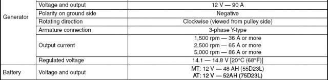

By your measurements, you are using a DVM. The output of your alternator is low. Not by much and might fool some mechanics, but your car and instruments support this fact also.
Here are the readings you should have according to the FSM:
