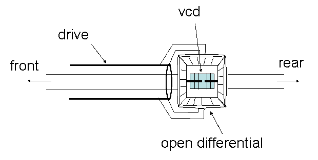

#21 vladhed
vladhed
    New User
  • Pip
  • 4 posts
  • Ottawa, Canada
Posted 14 April 2004 - 02:46 PM
Ah, I'd seen that before but didn't understand it. Does the vcd thing shown in http://auto.howstuff...fferential9.htm basically fit between the front and rear shafts in the middle of an open differential?
(see attached)

#24 vladhed
vladhed
    New User
  • Pip
  • 4 posts
  • Ottawa, Canada
Posted 18 April 2004 - 07:29 AM
When you originally said "Feels like something is blocking the wheel.", did you mean a wheel on the ground or the steering wheel? Based on the comments that followed I assumed you meant the former. Based on your last post, now I think you mean ther latter.
With my car, the steering wheel moves freely, but the rear outside wheel wants to slip when going around a tight corner (e.g. parking spot) - so if feels as if someone was pressing on the brakes and I need to give it some gas to overcome either the resistance in the VCD (dry pavement), or slip the outside back wheel (on gravel).
Sounds now like you problem is with the power steering.
